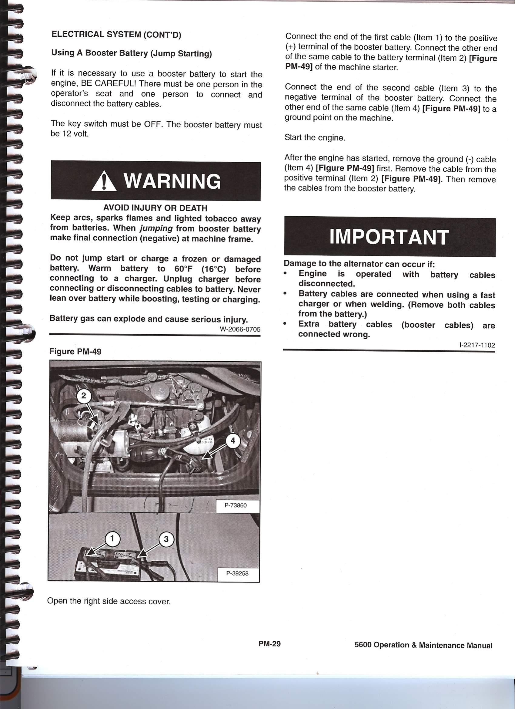

You the procedure in the 5600 O & M Manual Page PM-29 and it bypasses the dead battery.

That doesn't bypass the battery, it merely places the jump parallel to the battery. The battery is inaccessible so I can't disconnect it.
/ How to replace dead battery 5600d #8
If you want to bypass the battery and start solely off the booster battery, disconnect the positive battery cable from the starter first.
DEWFPO
Will the computer power up like that?

I've had it happen twice to me and the only way I could fix it was to get four guys and lift the bed up. I've tried jumping it at the battery and at the starter (as per the manual) with a dual battery 1 ton pickup and it didn't work. I don't think I tried DEWFPRO's suggestion about disconnecting the battery from the the starter and just using the jump battery.

I tried that this AM. It doesn't work.
I guess I'll need to get an A-frame and hoist to lift the bed.
