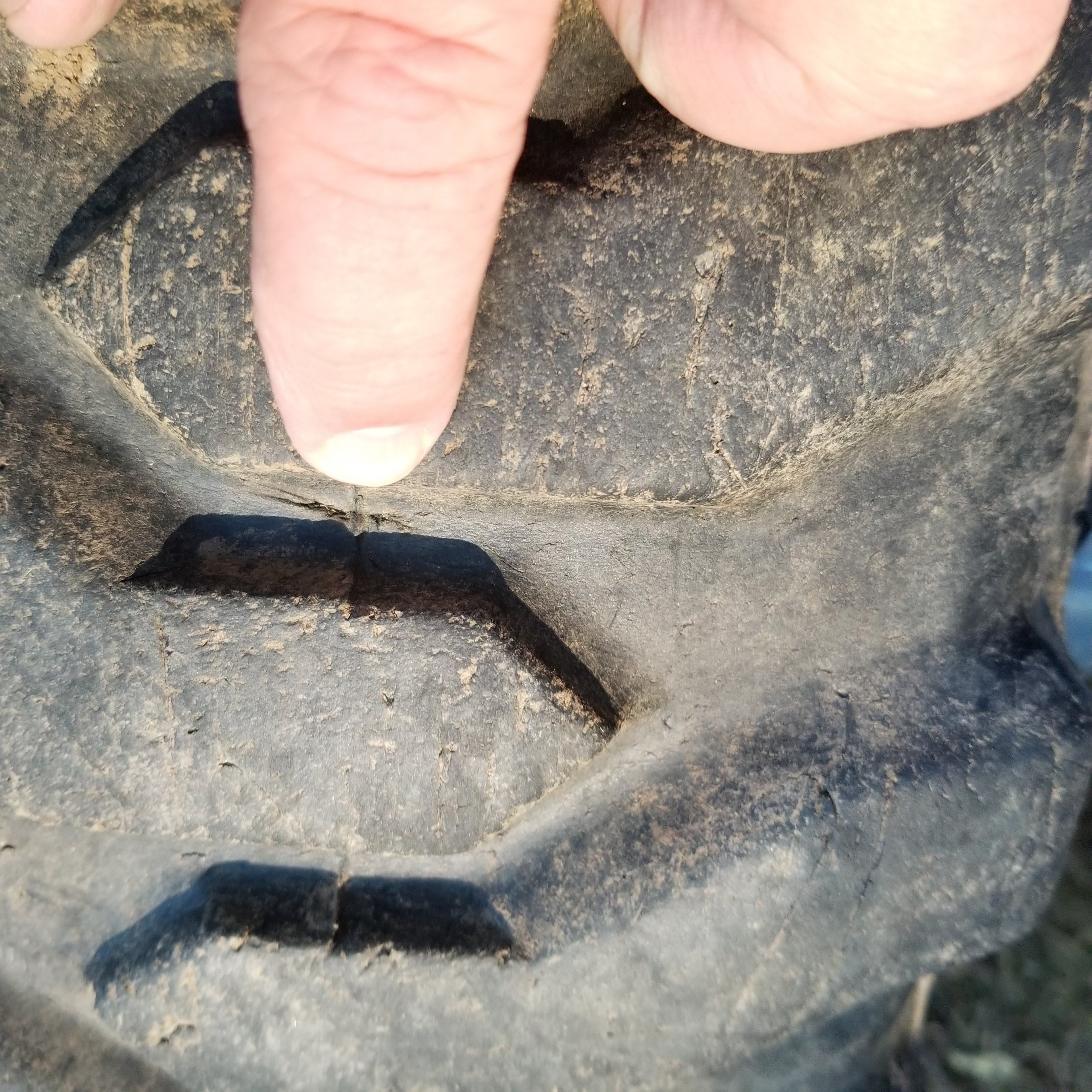

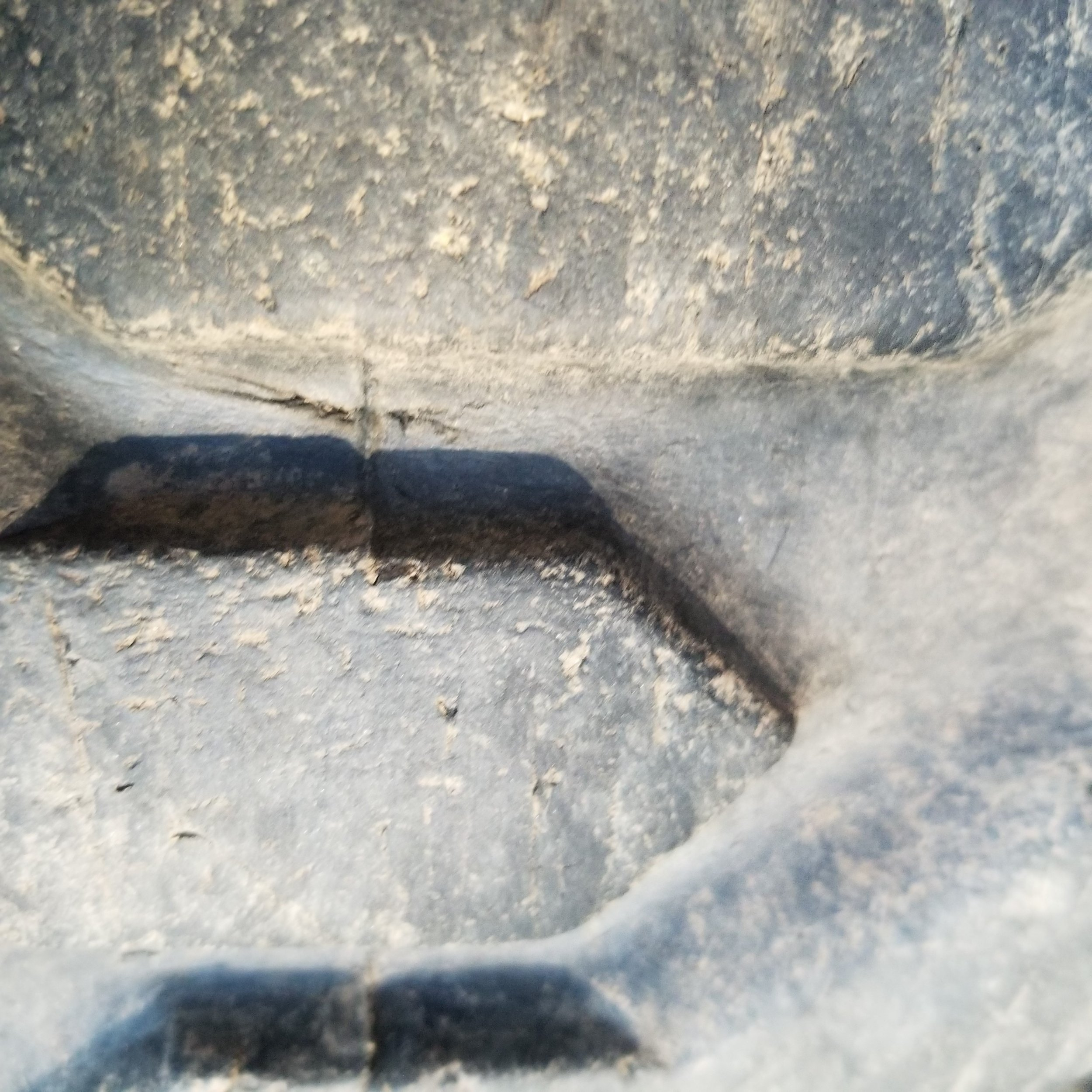

I have a 2006 Kioti CK30 and I put a 1/2 inch slit between the lugs on my front tire. I imagine this could be patched on the inside, or maybe plugged in some fashion? What would be best? With luck 2 pictures are attached. Who would be best to do it? If a plug I could get a kit, else is this the type of thing any tire place could do, or just a tractor dealer etc.? I haven't had tire issues on this since I got it in 2008 or so.
Thank you.

That can't be plugged but can be repaired from inside and last the life of tire. Take it to a tire shop that sell's and repair's farm tires. What most people do with a split in farm tires that size is illeagal for hi-way use tires.
/ How to repair tire? #3
I suspect being as it's a front tire about any tire shop could apply an internal patch. I'd not consider a plug but an internal patch should last the life of the tire.

that doesn't look like enough to even leak. If it isn't leaking, leave it. There's nothing to patch.
If it is leaking. patching from the inside is the best way to go.
I have many cuts in my tires, but not enough to leak

Unfortunately it leaked, made a racket doing it too.

When I worked at a farm store that sold and repaired tires, the best thing we had was the plug and patch. It's about 3" wide at the patch, and has a rubber plug with a metal end that gets shoved through the tire with lots of rubber cement everywhere. I've plugged many holes and never had anyone come back with a leak.
