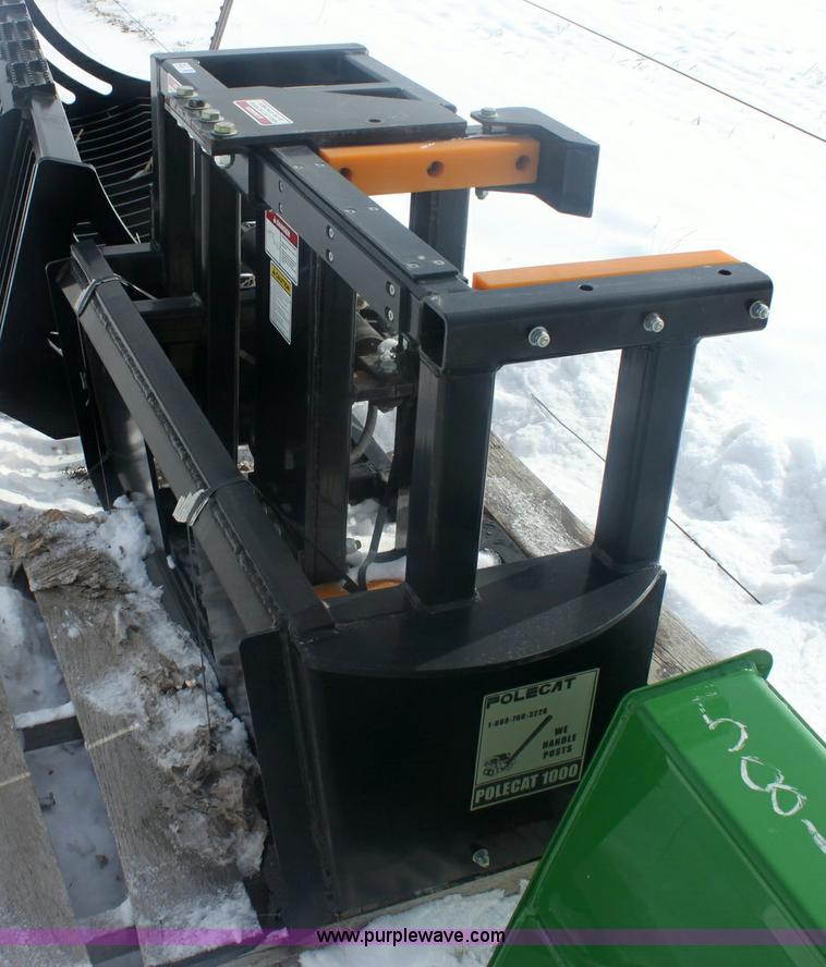

over the years I have set poles and removed them, I use a Pole cat on the skidsteer, to remove grab the pole a couple feet from the ground, wiggle it around to loosen the dirt and slowly lift, once clear of ground lay it down, to set pole auger a hole of specified depth, grab pole and tilt up, place the base on ground and release pressure on pole cat, lift arms the pole will slip between jaws, close jaws and align pole over hole and lower it in
   / How to remove power pole #46
Nice rig, but you better have the right Skid Steer. Many don't lift much t all. Not generally their strong point.
   / How to remove power pole #47
agree, I have a 590, the part that is difficult is initially lifting the pole from one end standing it vertical, the 590 will lift a 30 foot pole but doubt it could handle a 40 footer, a track machine would be better suited for this work

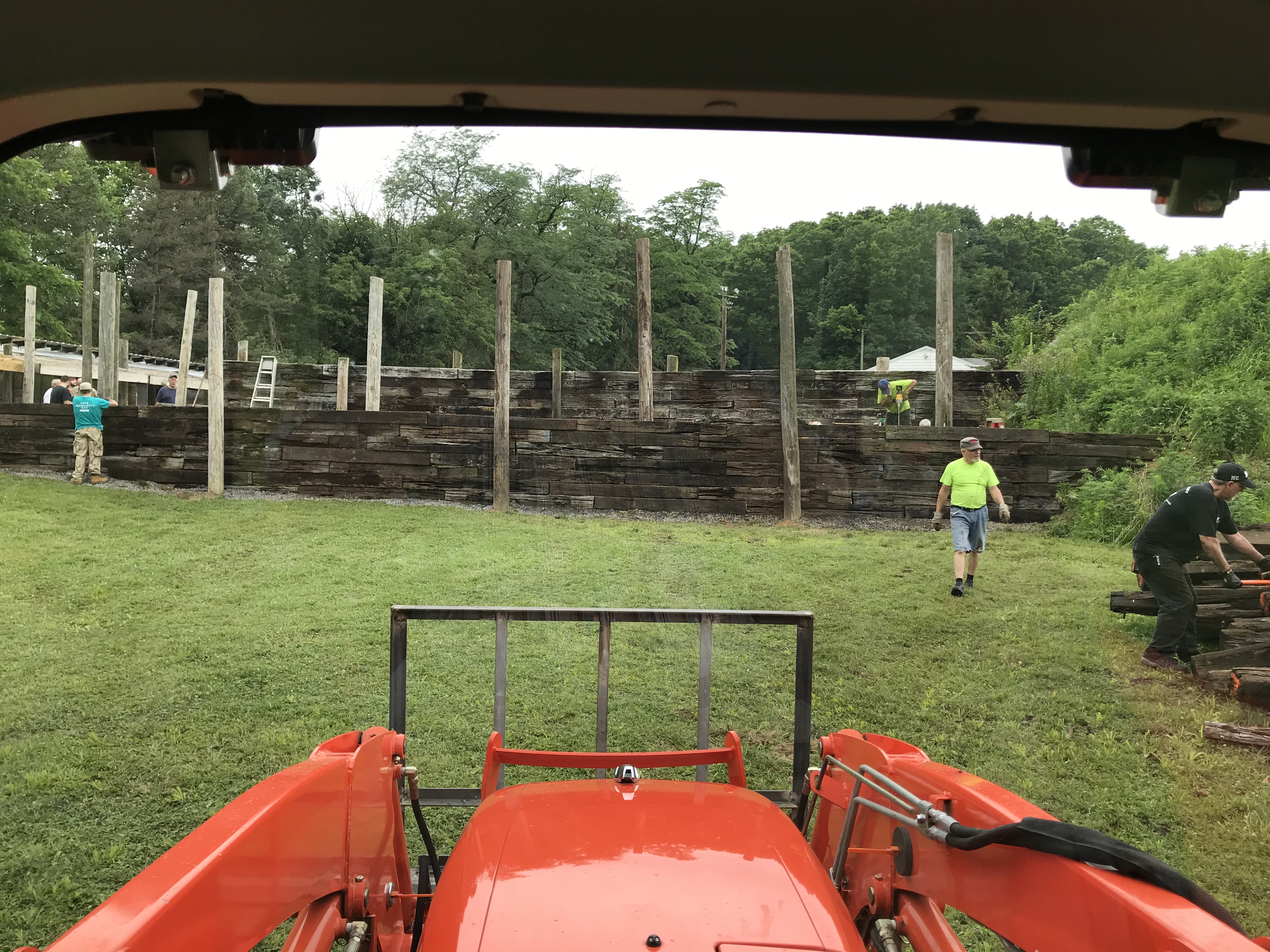

Did something on a MUCH smaller scale earlier this Summer. We are adding another few lanes to our pistol range at the club. The build was setting staggered poles to support railroad ties. Even though I didn't get pictures of lifting the poles, it did happen:) I used one of my chains that has a logging hook at one end to choke the pole at the balance point. Since the poles are tapered, that point is less than 1/2 way up. The chain was then adjusted so the choke on the pole was about at the bottom edge of the bucket by dropping the chain into the slots on the top of the bucket. Really worked well.
I'd pick the poles to drive them to the holes. One guy would walk along and control the poles. When we got to the holes, I'd raise them and the guys would rotate them and I'd lower them into the drilled holes.
I did get a picture of a section of the wall. This was after dropping the bucket and putting the forks on to handle the RR ties.
