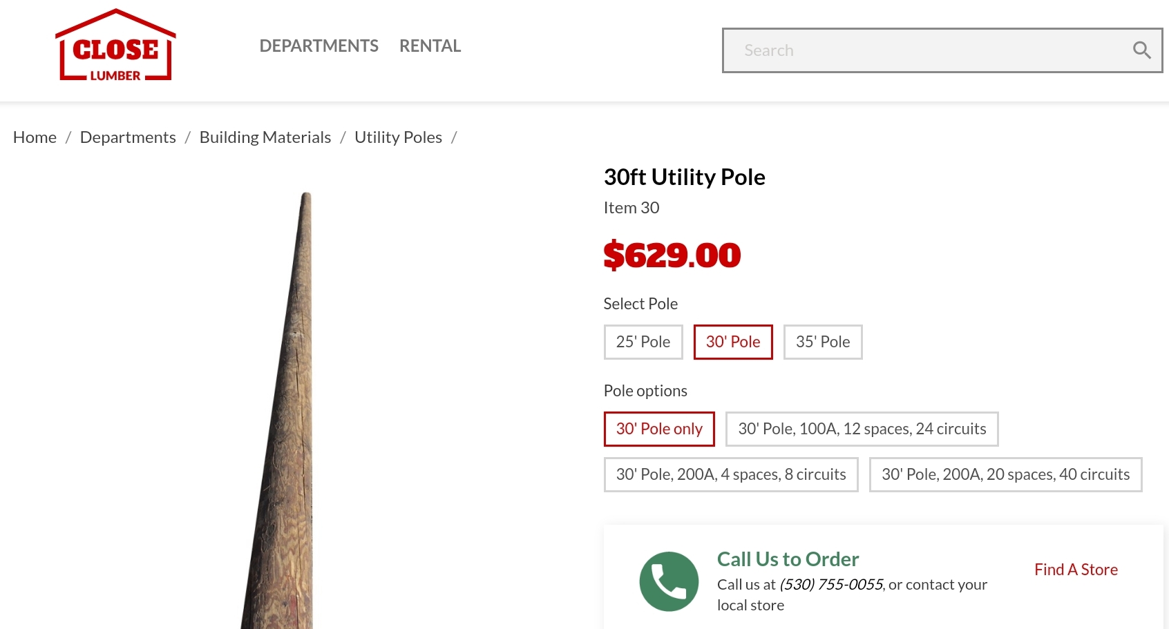

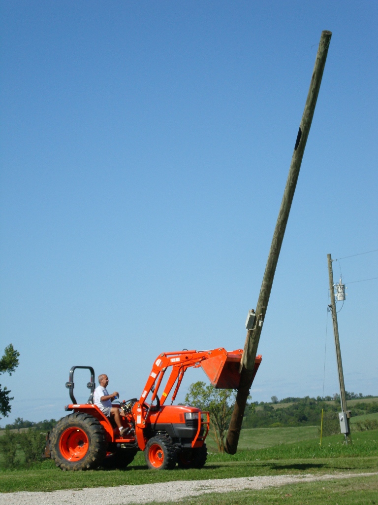

How much is a new pole? If I'm going to all the trouble to set a pole and then attach stuff to it, I don't want to have to redo it in a couple of years do to it rotting off. A lot of times they pull good and do exactly what you want them to do, i.e. lay down with out flipping, but often times a loader on a tractor can not get high enough to control it after it's pulled or it flips unexpectedly.

Worth the effort to save if in good shape. They last a very long time. I'd never chain one upright to a bucket . Too long and too much leverage.

I used a rented backhoe with a 12" bucket when I had to move one on my property. Use the backhoe to dig on ONE side at about a 45 degree angle out from the bottom. I put a safety rope to a metal stake on the opposite side but didn't need it. After I reached the bottom of the pole, I removed the rope and pushed the pole over. It was easy to drag out from there. I dug the new location hole the same way then pushed the pole into the 45 degree trench. Raising the pole was a little more complicated. I had the GF pull a rope attached to my truck while I raised the pole with the loader. That pole is still in use today to power a well. And it's still straight.
Added: That was in January, 1999.

Chained it to my 3pt drawbar first and shook it loose and lifted it a couple feet.
