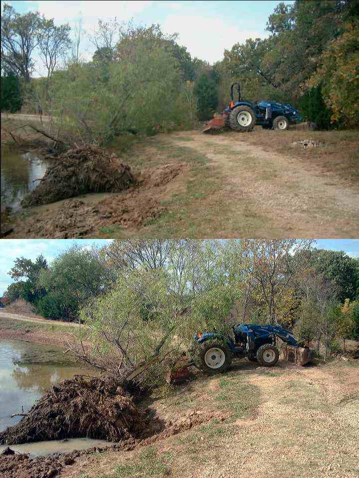

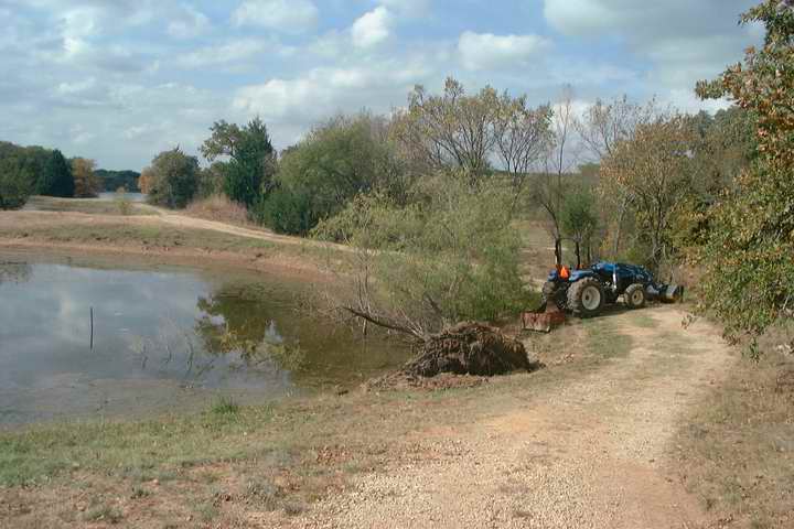

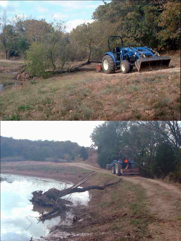

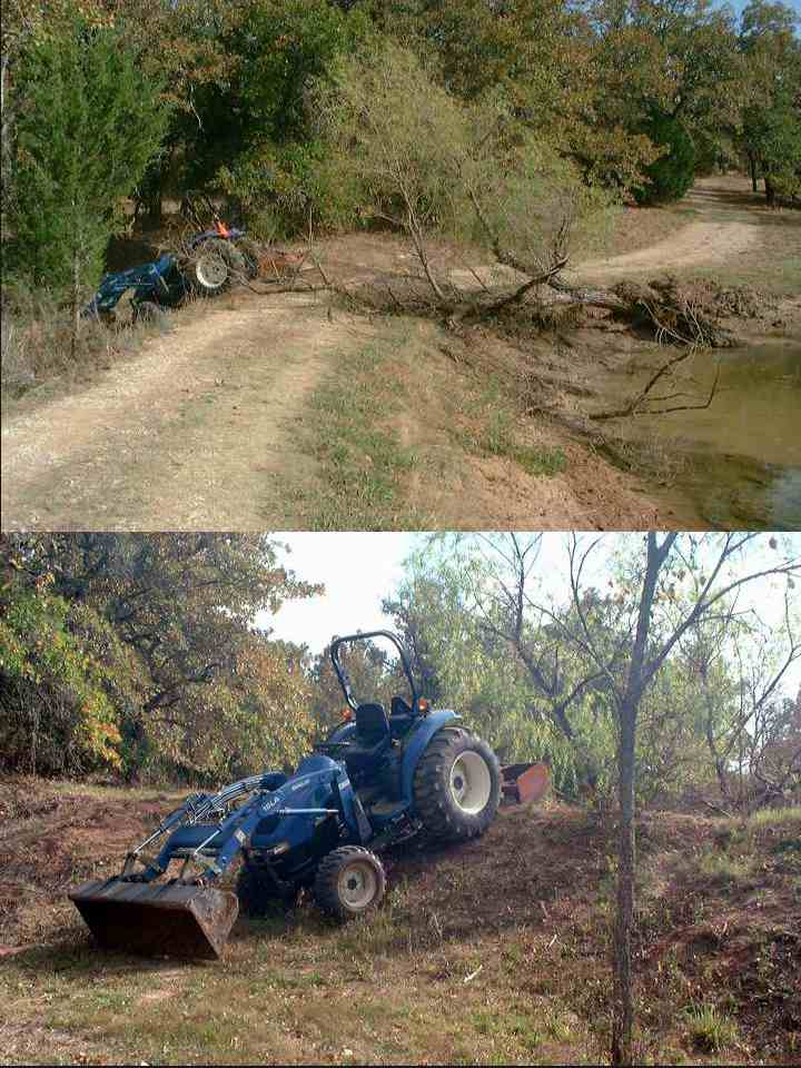

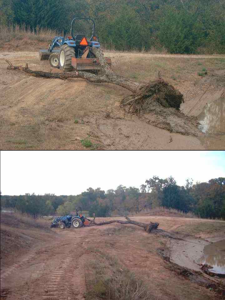

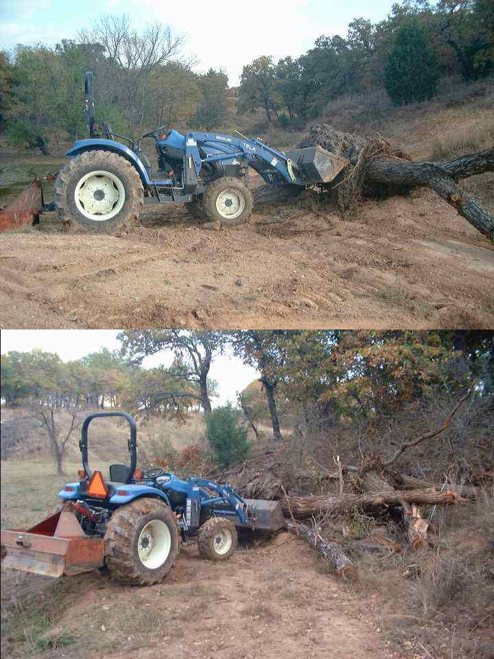

Where is the rootball? Is it on solid ground? Are you cutting it off and leaving it in place? I think a come-along is like digging a swimming pool with a teaspoon. It's way, way undersized for the job. You may be able to pull out cut pieces with it, but it's gonna wear you out long before there is much tree moved. Here's a few pictures of the much smaller willow tree I pulled out of my pond. My tractor was spinning and struggling the whole time I was moving the tree.
