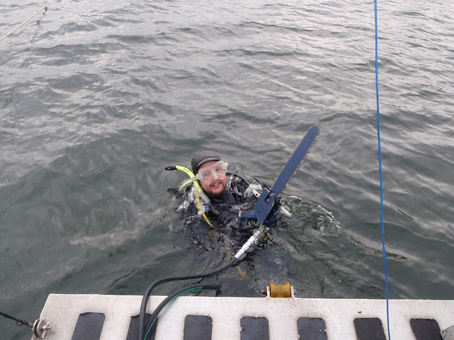

Underwater chain saw. :)
http://toolmonger.com/2010/01/13/underwater-chainsaw/
