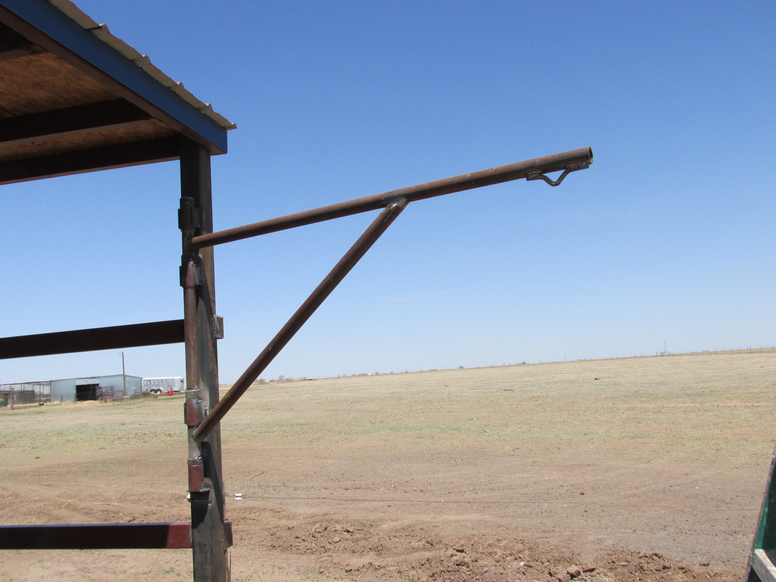

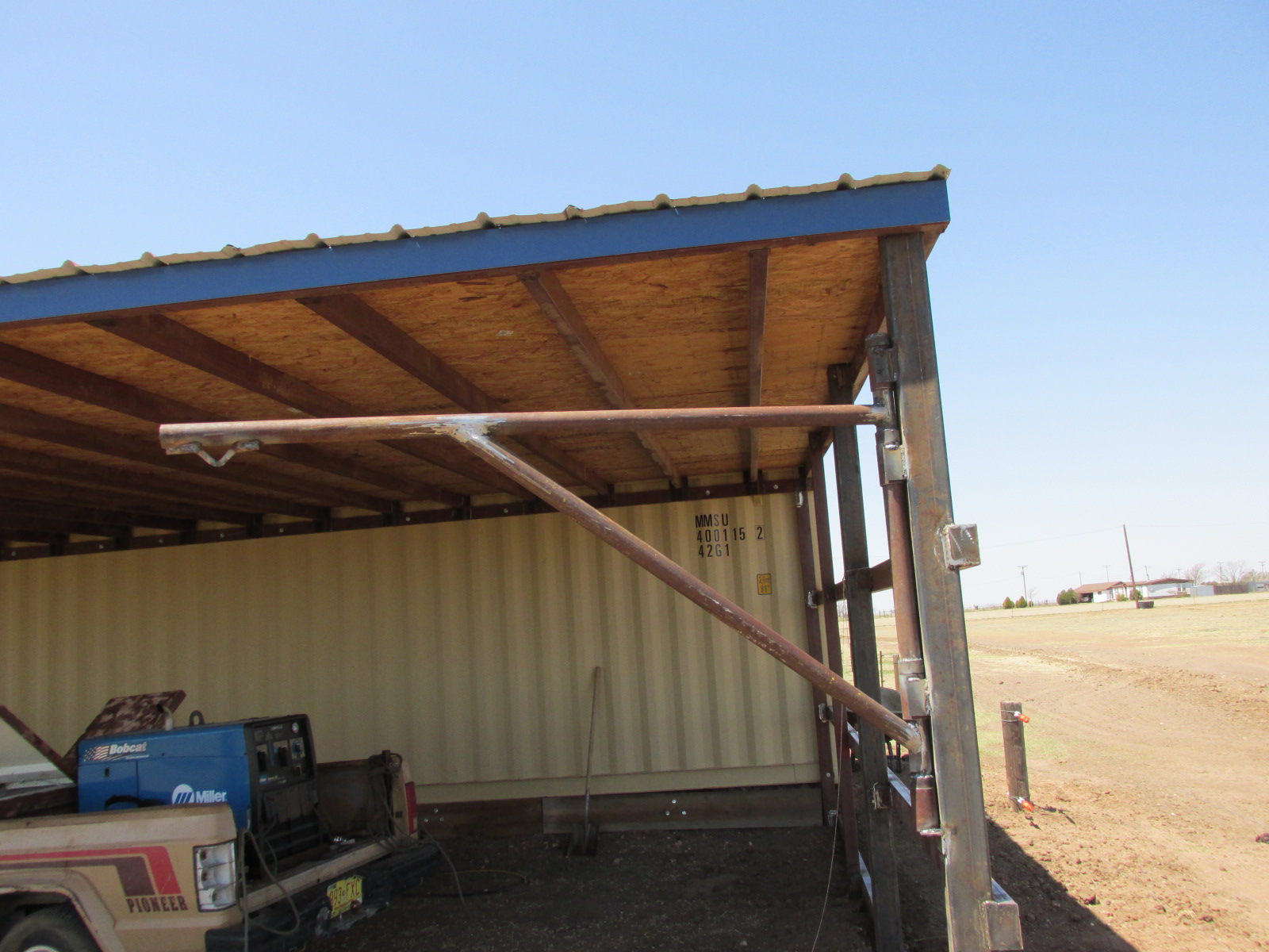

<img src="http://www.tractorbynet.com/forums/files/attachments/414578-how-remove-park-3ph-auger-post-hole-digger-stand-june"/> Over the years I've tried a few ways to do this. Hanging it from a tree branch worked, but it wasn't where I wanted it. I also hung it from a beam in a barn, but it was always in the way. For quite awhile I just drilled it into the ground a little ways and left it like that. But my favorite, and current method is to hang it from some posts with a beam across the top of it off in a corner where it's easy to get to, but not in the way of anything else. Eddie
Great idea Eddie. Thanks for the picture.

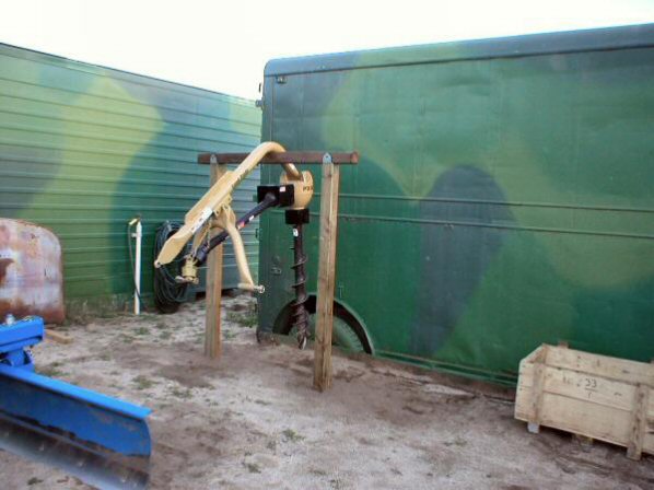

Should cost under$20. Been holding my PHD for 10 years.

So you just hang the PHD over the top and unhook? great!! Any pics of the bottom?

Just 2 PT 4x4s stuck in the ground 30". Those were the first holes that I dug with the PHD.
Remove the top cross beam, back up, stick the beam in the saddles, lower implement. Pull drive shaft and pins. Disconnect hydraulic lines, drive away. Typically takes about 5 minutes to attach or remove this implement. Easily done with one person, no help required, or even wanted for that matter. ;)

HA!! No chains, no straps, I like it... looks like a soon to be project for me... now where to put it??....
