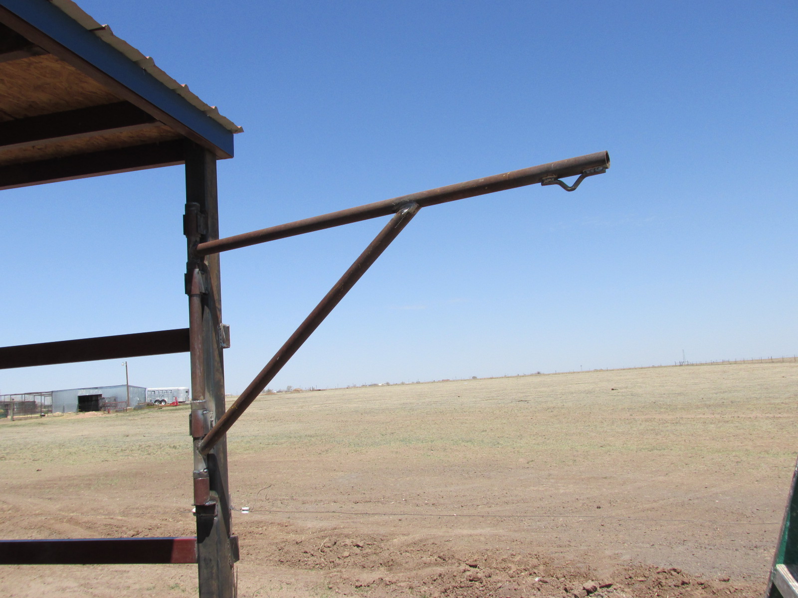

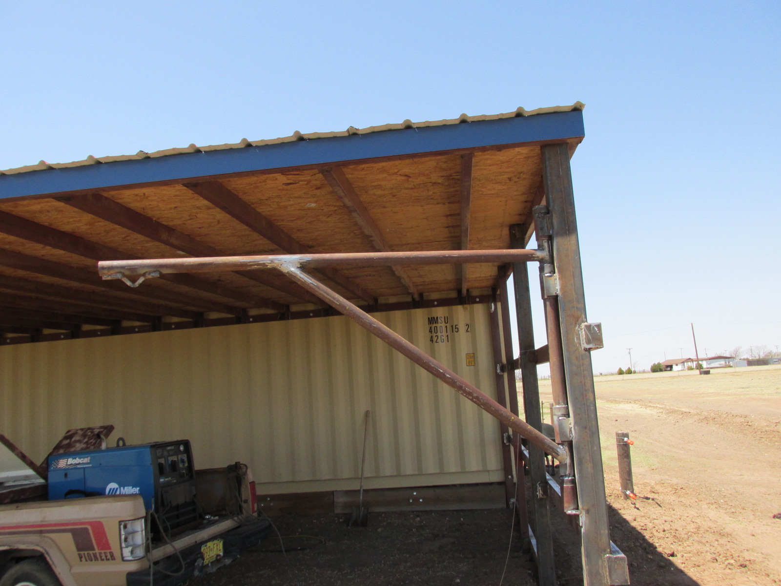

This is what I use. Attach digger to loop..disconnect from tractor and swing it under the roof. The shed has a wall now on the end. Very easy to connect/disconnect.

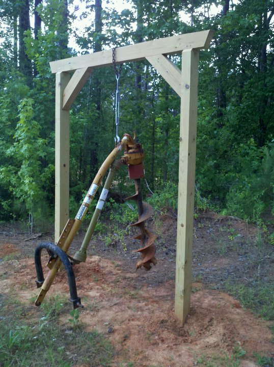

Over the years I've tried a few ways to do this. Hanging it from a tree branch worked, but it wasn't where I wanted it. I also hung it from a beam in a barn, but it was always in the way. For quite awhile I just drilled it into the ground a little ways and left it like that. But my favorite, and current method is to hang it from some posts with a beam across the top of it off in a corner where it's easy to get to, but not in the way of anything else.
