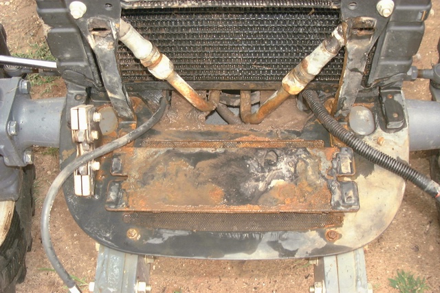

I'll also say that my main application for my Optima is my tractor that had a regular lead-acid battery that seeped acid and acid vapors. Those vapors got drawn through my radiator and rusted the whole battery shelf. That caused a lot of damage to my tractor (pictures on request). I had to replace the radiator and HST cooler lines under warranty. The Optima ended that problem: no leakage, no damage, perfect starting. I'm a happy Optima camper.

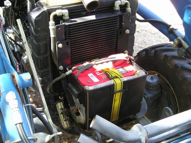

Here is a picture of my battery shelf before the Optima and a picture of the Optima installed. The reason I have a battery box is that I added that to keep the OEM battery from spewing acid. It worked, but finally the OEM battery just died. I replaced it with the Optima.
My Optima has been in my tractor since August of 2006 and has worked flawlessly. Notice that it is not only in the box, but I also have it sitting on carpet padding and there is about 1-1/2" of carpet padding in the front of the box. That probably reduces shock, or at least it can't hurt.:)
