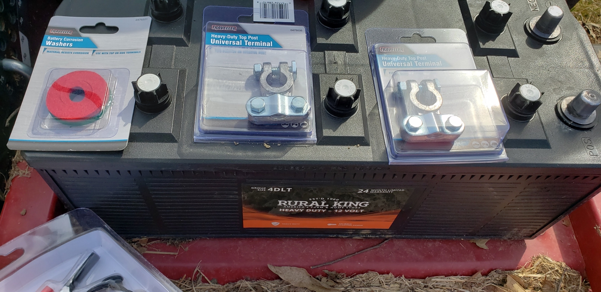

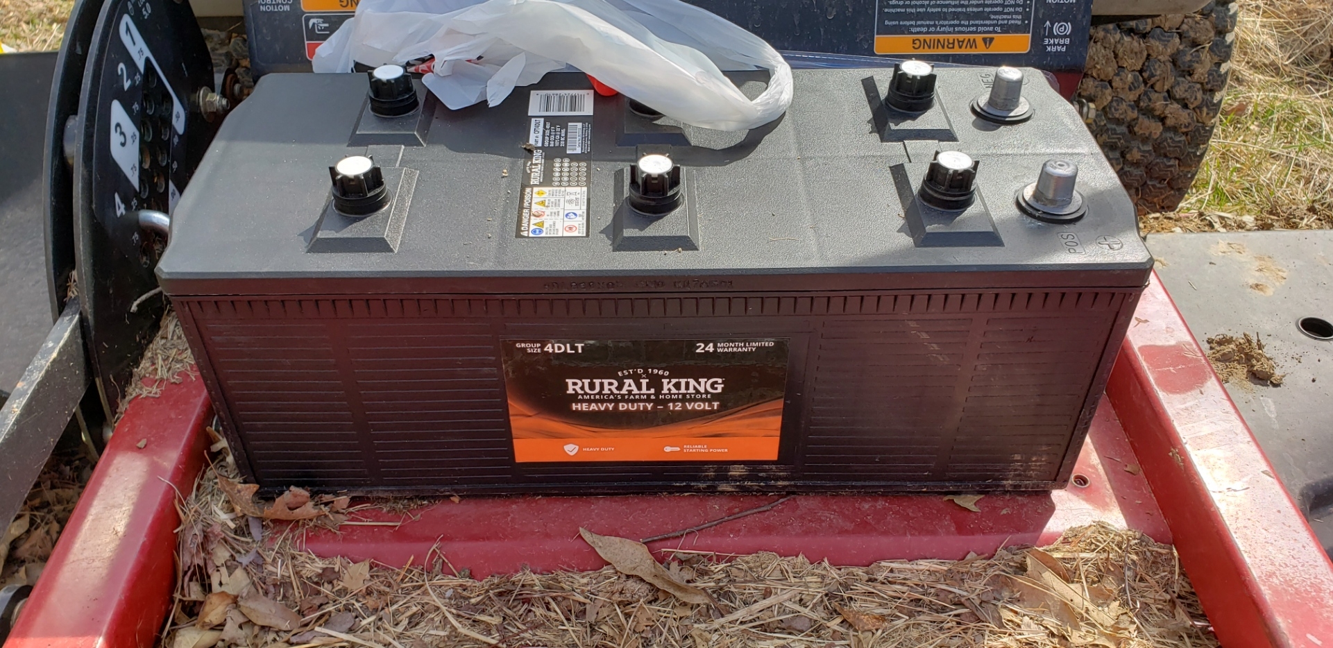

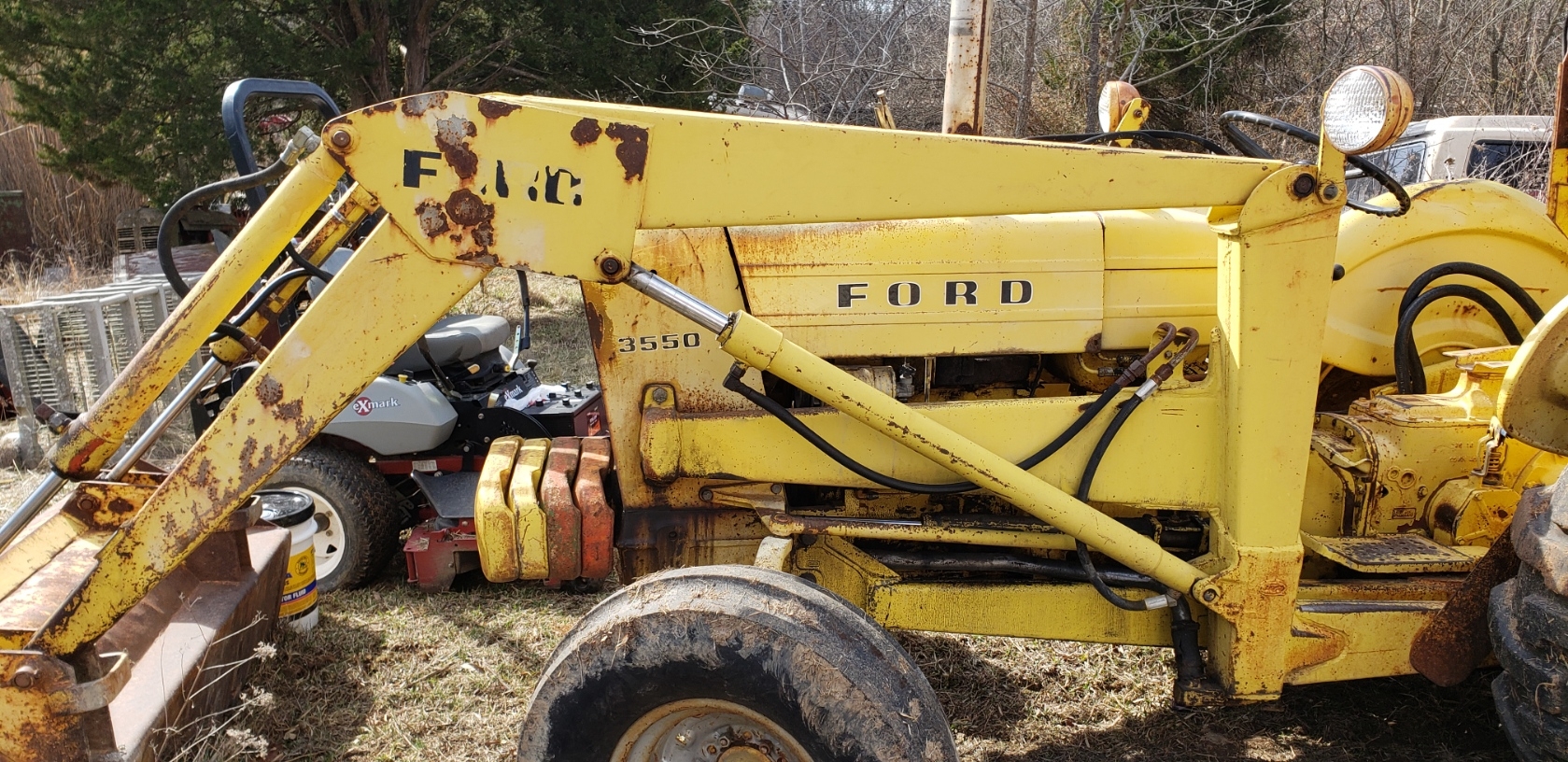

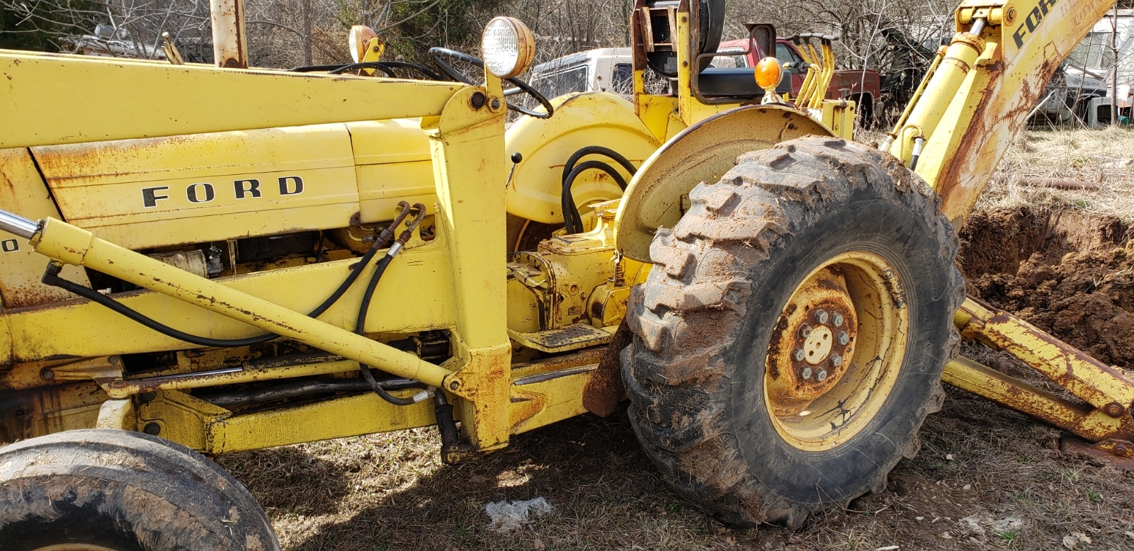

I needed a new battery for my Ford 3550 backhoe.
I thought I would try get off to a fresh start with my new battery and bought a 12-volt solar battery maintainer.
Time will tell how long the battery will last.
This is a tractor that sits a while. between use. I wish I could keep it under roof but don't have room. It also is parked a distance from electric power.
I don't know how long the solar maintainer/ charger will last. My first one..
Solar charger/maintainer
New battery
Heavey duty cable ends
I would have done all new cables, but they look good accept the ends that a hammer mechanic beat to hell, he couldn't find a half inch wrench and a screwdriver to spread the connector.
Hopefully my battery won't get crusty battery guts.
The old girl runs and work like a champ, needs some paint
Used it yesterday.
