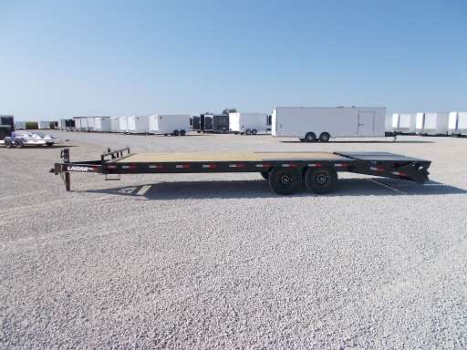

I have been looking at deck over trailers pretty heavily last few weeks (window shopping).
The trailer I would be interested in would be a bumper pull. All the deck overs have the axles so far back that it seems loading them without having a crazy amount of tongue weight, most loads would have to go on backwards?
I have had a 20ft deck over in the past, it’s axles weren’t as far back and I still backed quite a bit of the loads on backwards. Doesn’t seem to be as much of an issue with equipment trailers since axles are placed further forward.
Here’s an example, my Mahindra 5555 (80in wide, 15ft long with loader) is 7999lbs right now. The bush hog is 1025lbs but it’s 10ft long and 7ft wide. On a 25ft trailer I would have to back the tractor and bush hog on the trailer to get most of the load on the axles and not on the tongue? Not picturing a good way to balance the load with bumper pull. How much tongue weight do these trailers put on the truck?
I have read a few threads on here about this issue but non have answered my questions.

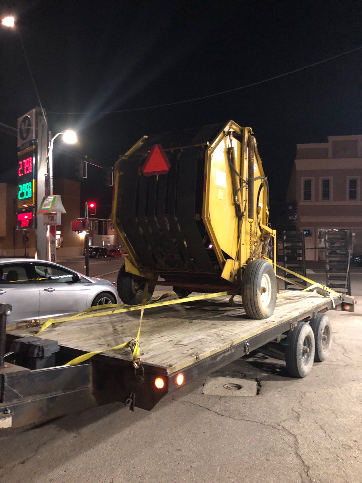

The general rule is 10% of the total weight. If you have an empty trailer that weighs 1000lbs, your tongue weight should be 100lbs. If you have a loaded trailer that's 8000lbs, your tongue weight should be 800lbs. My max tongue weight is 1200lbs on my truck, which gives me a 12,000lb towing capacity.
Edit: That pickup is loaded wrong. Engine should be facing forward, it's where all the weight is. The bed weighs nothing, so it would be rear bias.

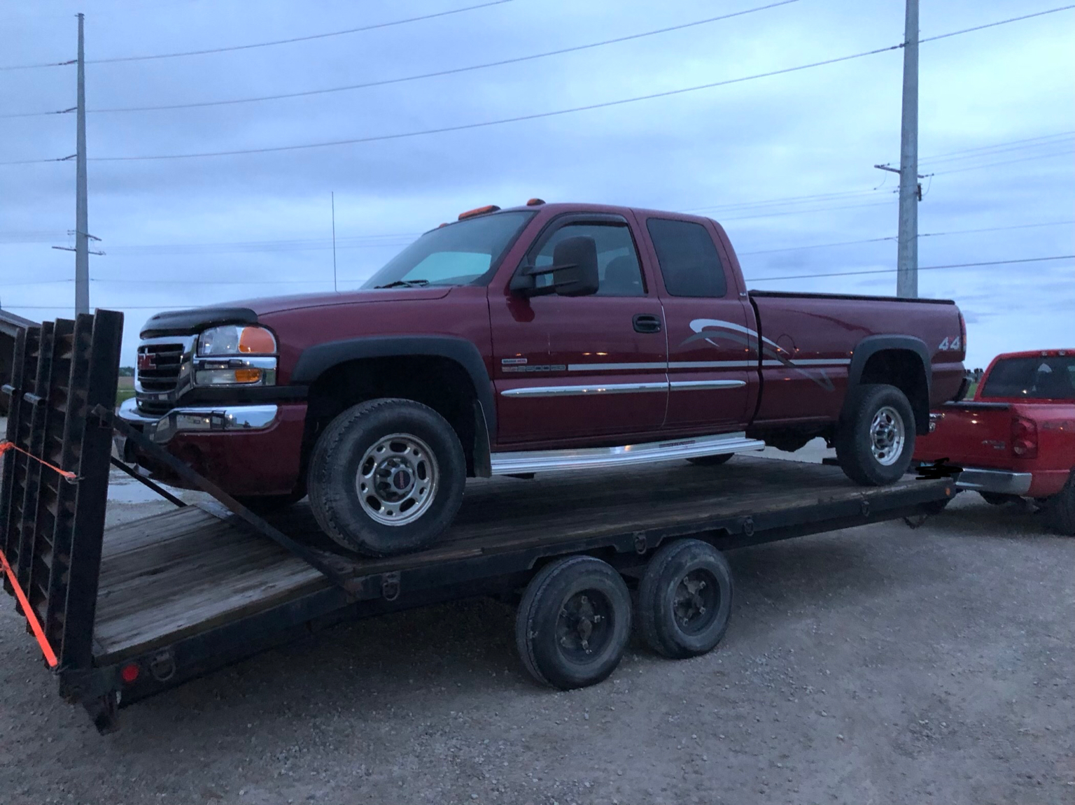

I disagree!
The red GMC has the rear wheels at the very forward edge of the trailer.
The white Ford has the rear wheels at least 4' aft of the forward trailer edge.
Big difference.
The GMC ... LOOKS..... OK,...... but who really knows?
Only way to get the correct approximate 10% tongue weight, is to weigh the tongue.
Either truck on forward, would likely be excessive tongue weight.
/ How to properly load a bumper pull deck over trailer? #10
I would of backed the white ford forward more and I bet speed was a factor in that rollover........

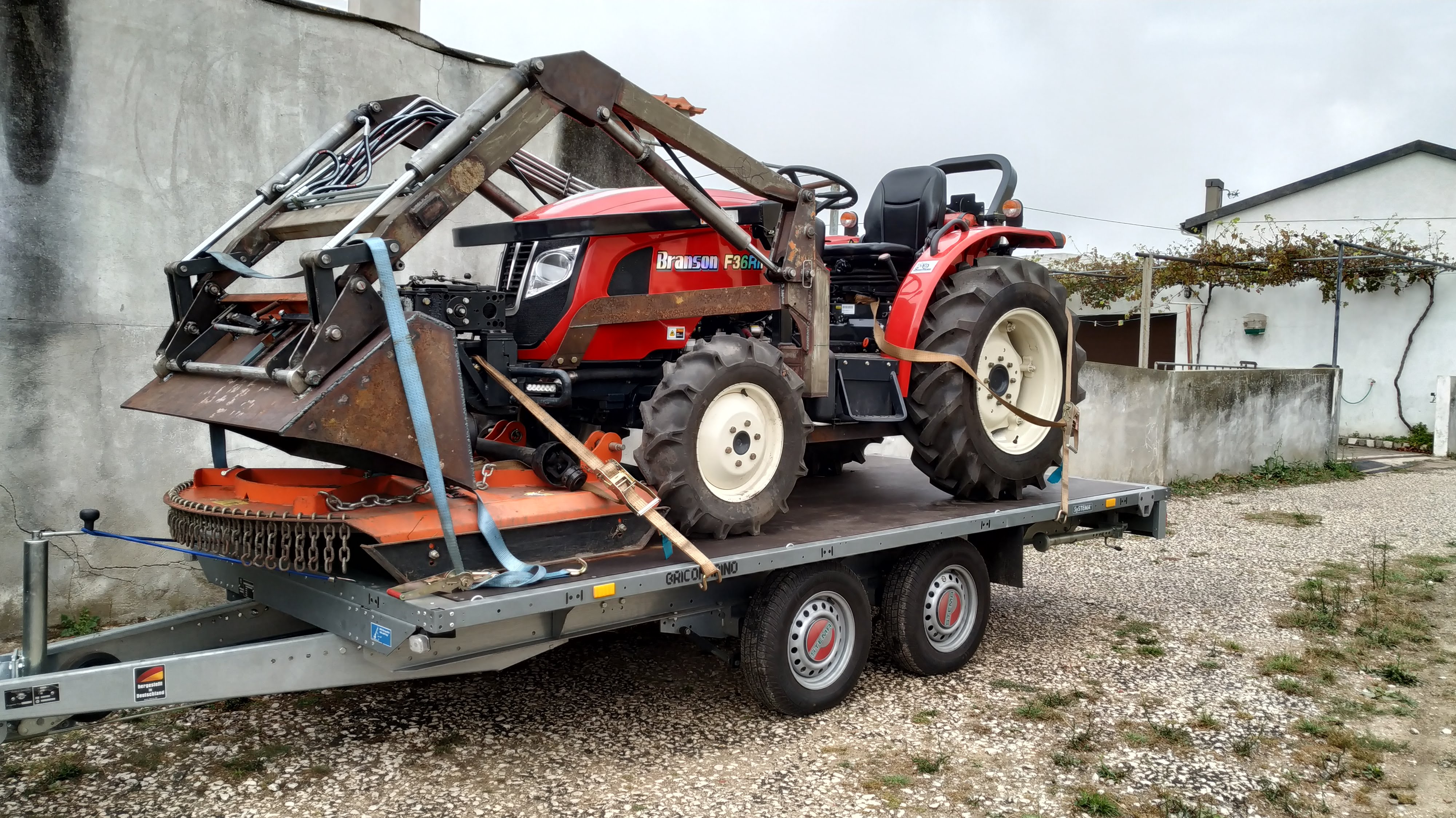

As Rock Crawler said, it's indeed a weight and balance thing.
Play with the setup till you have it just right. Even if that means stopping in the middle of a trip, to readjust, BTDT. Don't get the laziness get over you and disconnect the implements if necessary. I see most people will have mowers just hanging out the back, without any real reason as of why.

The GMC truck was a 2500hd 6.6 Duramax, extended cab with 8ft bed. It was as far back as I could get it, tank full of diesel.
Might not have been perfectly balanced but we made it to the garage it needed to go.
This was a F350 460 7.5L gas truck, lighter in the front. Dual rear gas tanks
IMG_1288.JPGIMG_1287.JPG this truck was wrong, F350 dually with 6.8 v10. 50mph max or trailer started to dance but wouldn’t fit on the trailer forward. Another successful tow just had to go slower.

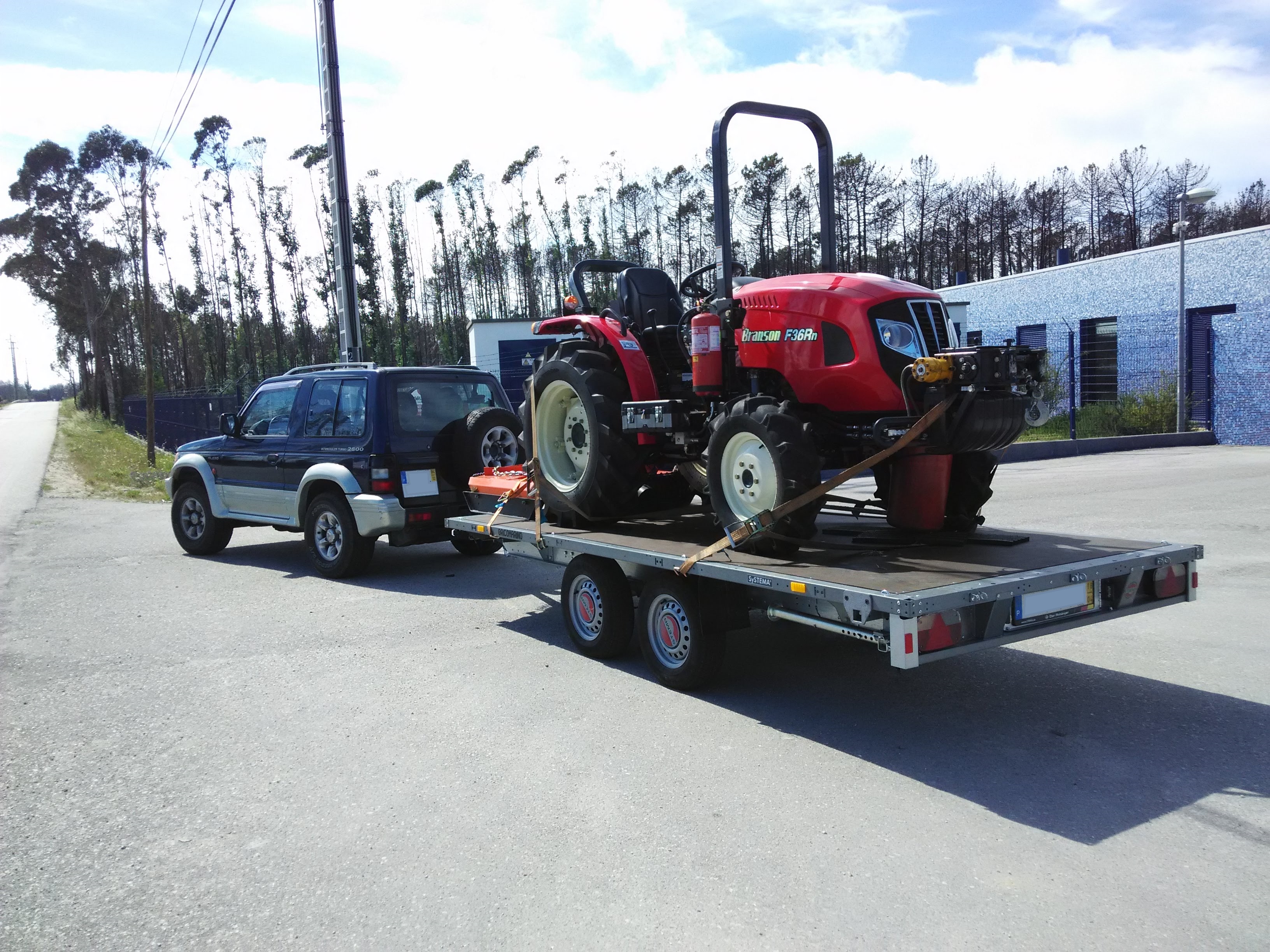

That is a rather high center of gravity, and a short wheelbase tow vehicle.
Could get really interesting at more than 70 kph on a rain slicked road!
/ How to properly load a bumper pull deck over trailer? #17
It's actually more stable than it looks up to 90 kph. Never went much above that.
The only time it got a bit sketchy on me was because I didn't load it quite right. Moved the tractor about 4 to 5" forward and everything was nice and stable again.
I've since replaced the 4x4 with a 2010 Mitsubishi L200 pickup truck as I got a good deal on it. Lost about 100 kg of towing capacity, but allows me to put an implement on the bed and relieve the trailer a bit more.

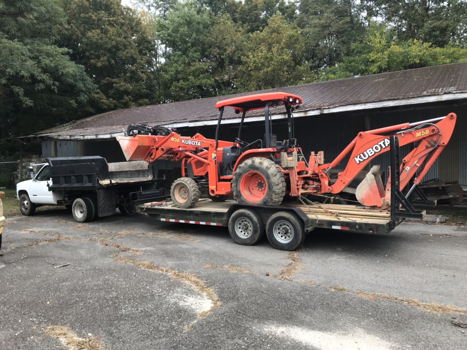

What’s the weight distribution on your tractor? My M59 sits very back heavy. I have to pull the rear tire forward of the center of the axle to get satisfactory tongue weight. IMG_9144.JPG
#19
What’s the weight distribution on your tractor? My M59 sits very back heavy. I have to pull the rear tire forward of the center of the axle to get satisfactory tongue weight. View attachment 672666
Not sure. It’s 7999lbs now and I’m about to add 300lb bolt on weights to each rear wheel and add a cutter bar on the bucket. That will put me around 8600lbs plus the weight of the cutter bar. The bush hog is 10ft long and weighs 1025 so total load will be under 9700lbs of payload. Might just have to make multiple trips lol. My buddies truck can only haul around 10k on the bumper, same as mine. Class 4 hitches. His has rails for 5th wheel, mine is just bumper.
Massey Ferguson 98 I have is 9500lbs just the tractor. So either way I’m towing 9500lbs of tractor whether I add weights to my tractor or not.
With the loader on, it's gets a bit front heavy with all the front weight and winch sitting there.
Also, note that European trailers have the axles centered with the bed of the trailer. I do have to pull the tractor a little backwards so I don't end up with too much tongue weight but at the same time, I have to take the implement off so it doesn't hang out the back.
Most times, I just measure the distance between the rear wheel well to the ground unloaded, then load it till it drops about 2 to 2.5". Seems to work well and I get a stable rig.
