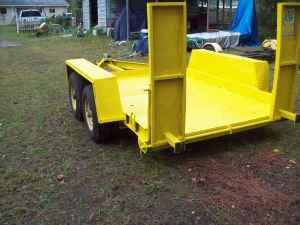

/ How to move boulders? #7
A trailer like this. It was designed to haul a skidsteer which weighs about 7000 lbs. A skidsteer or tractor that can lift about 3000 to 3500 lbs, would be ideal
