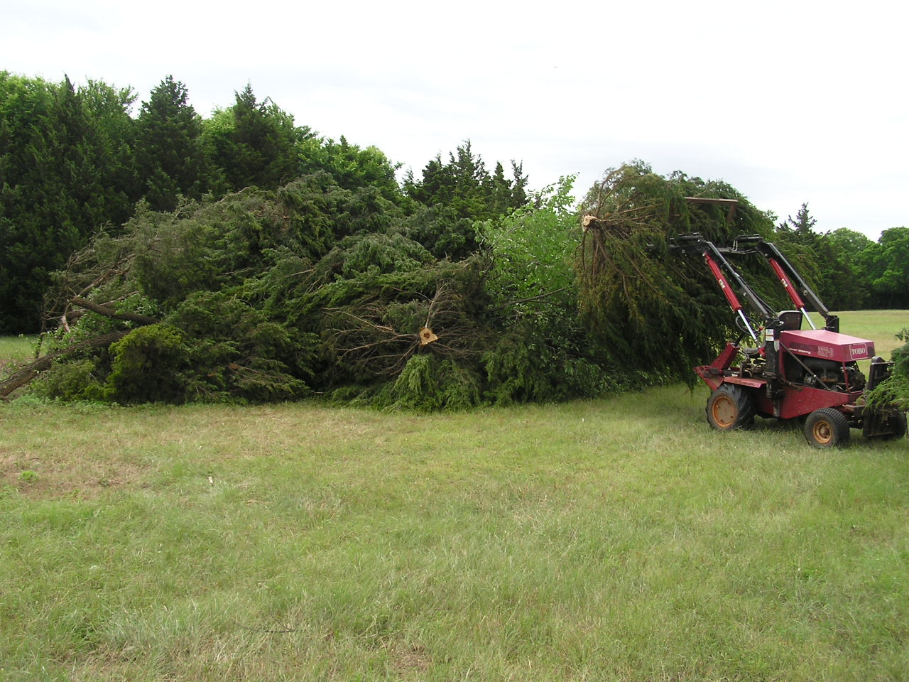

I like it Xfax! That's a lot of evergreens... did you light that pile off? Can't imagine the flame if you did. :eek:
Yep, eastern red cedar, unfortunately I didn't get pictures of that one. :(

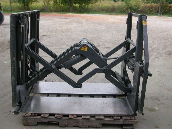

An image search didn't turn up much. Do some research on scissor lift and build one sideways. :D <img src="http://www.tractorbynet.com/forums/attachment.php?attachmentid=456718"/> <img src="http://www.tractorbynet.com/forums/attachment.php?attachmentid=456719"/>
I was thinking more along these lines, sideways of course. image-1458145367.jpg

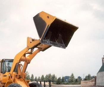

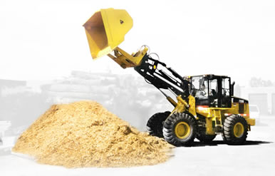

I thought of another thing that might be easier. Use the idea of the high dump bucket or roll-out bucket, but with forks, not a bucket. There would be fewer moving parts. High Dump
Another style, same principle.
