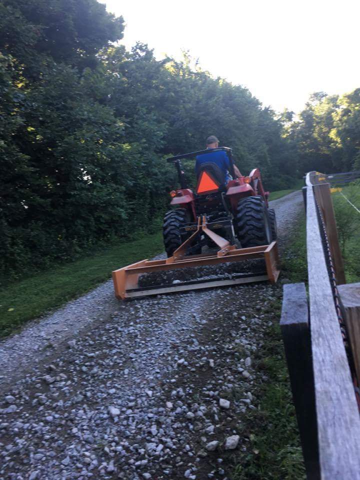

   / How to grade a road that has "ripples" #39
Love my LPGS. Does a great job. View attachment 571087
Whatever the tool, you still need to cut down to the bottom of the ripple.
Do that, and it really doesn't matter what tool one uses. (restoration of the aggregate top surface is another issue)
