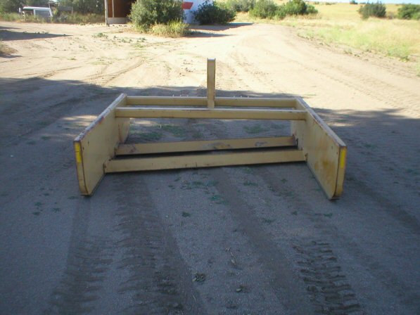

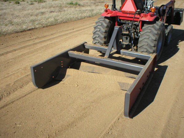

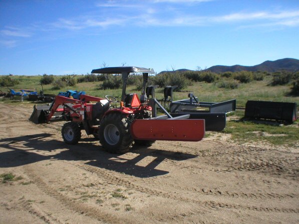

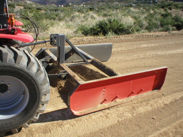

The pictures show a heavy duty 5' LPGS. This type of implement will make short work of wash boarding. :thumbsup:

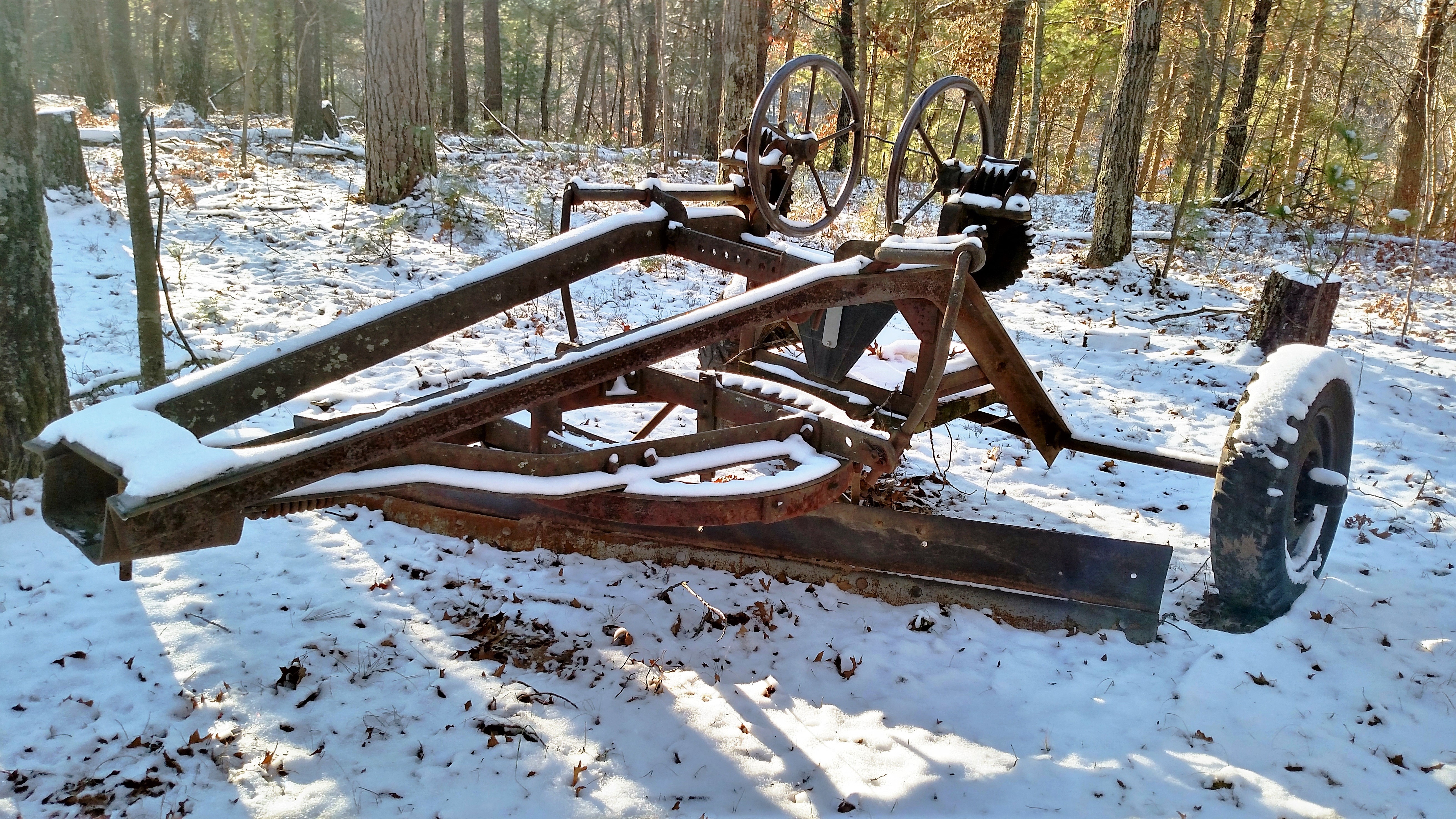

When we first got into this place 30+ years ago, the neighbor had one of those pull behind graders.
I hooked on with the Fordson to service the road. It worked a treat on the way down hill, but was just too much to pull up again with the blade carrying any material at all. I wanted to preserve the crown on the road, and making adjustments after making an empty pass was just tiring. Then the big sector gear that sets the blade angle broke and the old implement was hauled off into the woods.
We tried though!

FWIW...Grades cited as a percentage are a rise/run ratio...since percentages use a factor of 100...whatever the grade is (in the OP's case 14) the cited figure is the difference in elevation in 100 linear feet...so a 14% grade changes 14' in 100... a 100% grade would be a 45* angle...
As for the wash-boarding remove the gauge wheels and set the rake on an angle...make a pass or three and then make whatever adjustments to the attitude and angle of the rake to increase efficiency...

So, when you use your York Rake, do you have it set straight across, or set at an angle?
