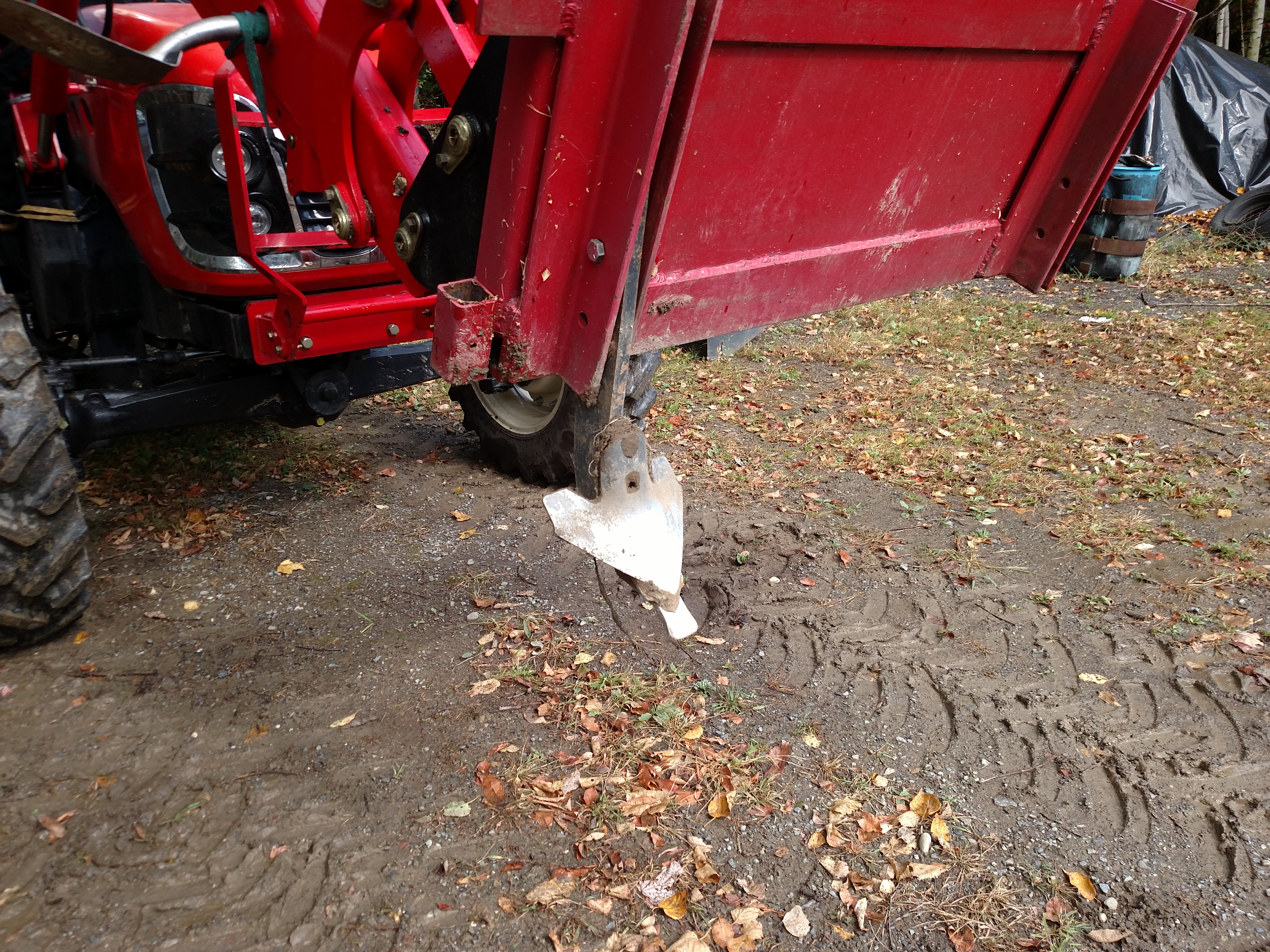

I have a York rake that I will use occasionally, I am not a fan of York rakes for normal dressing up of a driveway they tend to segregate the materials in the driveway especially when set at an angle the finer material will flow thru the teeth the stones tend to migrate to the end and spill off in a windrow which will not compact, I run my backblade at an angle and pull it backwards, at an angle it will move material but not separate it and the reverse curve helps to tighten the material down. Several people have mentioned ripping the driveway, that is fine if it's flat and you have something to compact the material afterwards, on steep grades ripping without extreme compaction will result in an unstable road bed that will wash, rut and washboard rapidly.
This is what I use to put in my watercuts,
