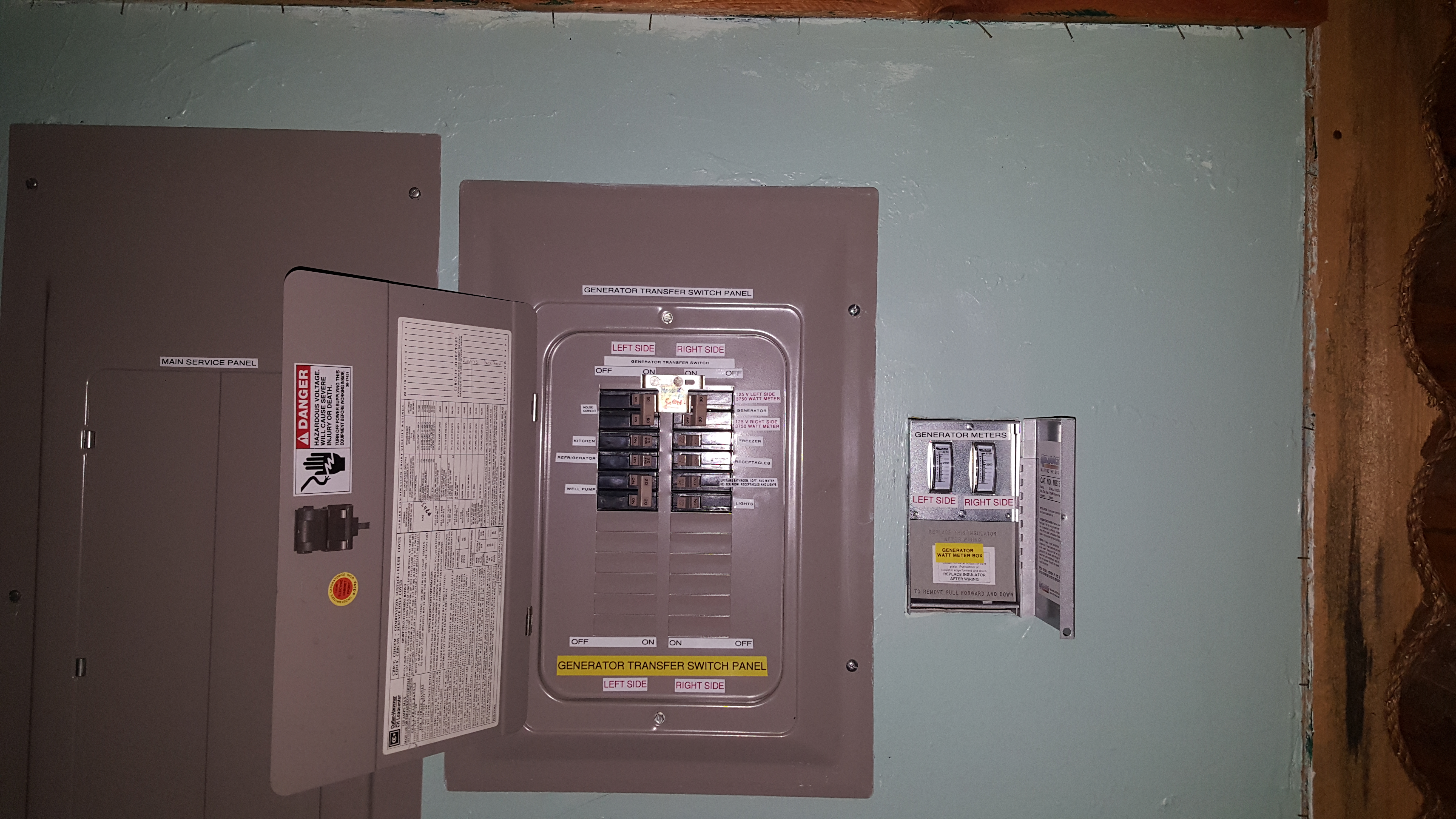

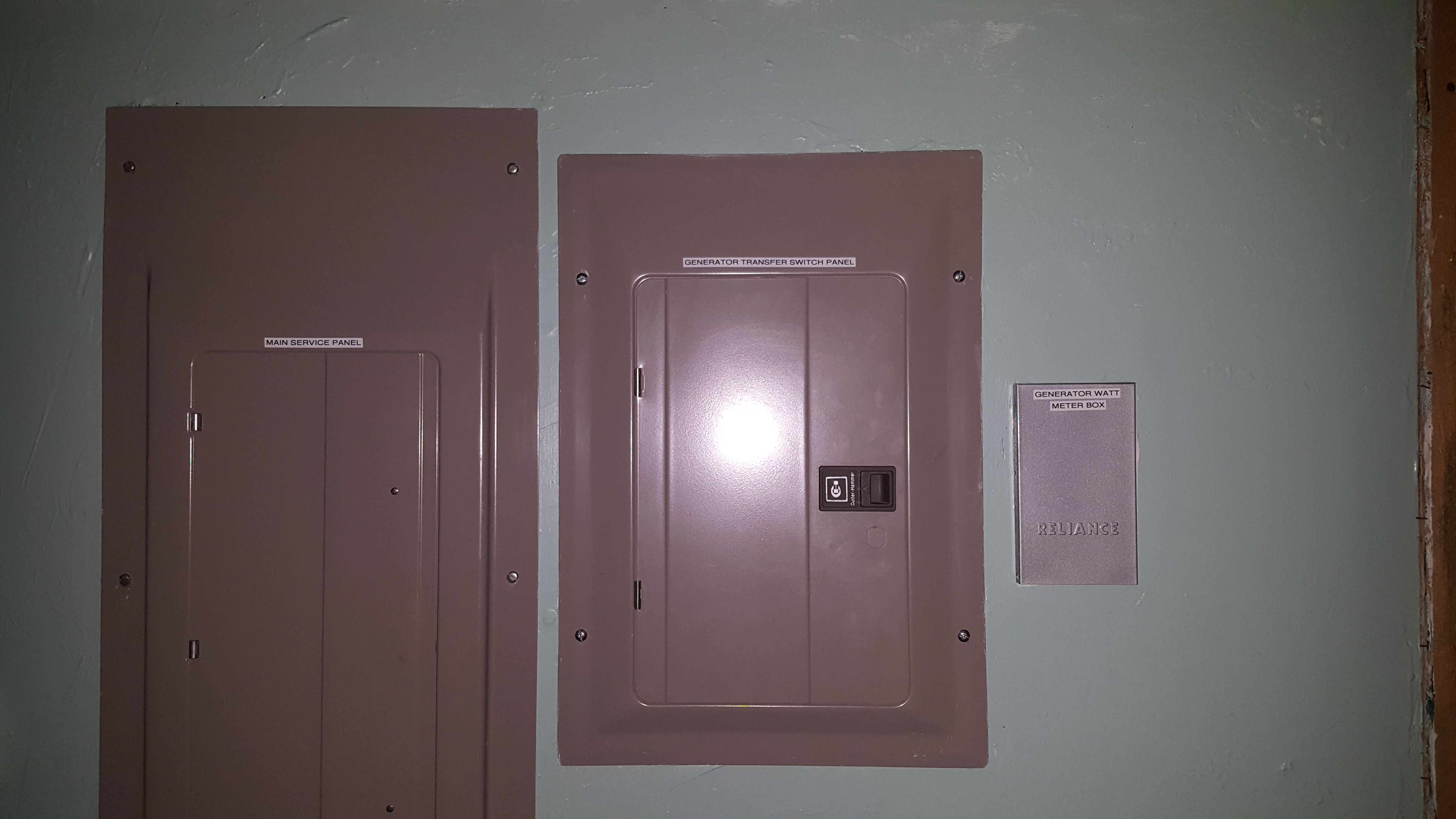

And once you have your "outside generator plug" (male end) wired up to your "generator transfer switch panel", then you may want to add a "meter box" to balance each 110 volt leg of the generator to insure one 110 volt leg does not have the majority of the (Wattage) load used while the other 110 volt leg has very little (Wattage) load use.
KC
View attachment 629199 View attachment 629200
MF
maybe i am missing something here, but your labeling is wrong? most panels alternate between l1 and l2 per slot, you have left side loads and right side loads, but you also have a well pump which is 240 running on "left side" when in reality its running on both sides, along with every other breaker????

MF
You are right, I did my labeling late one night and have not yet completed the balancing out of the loads, so:
if I now see it correctly, my well pump shares an equal load for the left and right side meter (even though it is located on the left side);
and at this time I only have in addition for the left side load is the kitchen and refrigerator;
and also at this time I have the remaining breakers for the right side load, the freezer, receptacles, upstairs (all), and some lights downstairs.
If I can remember correctly, I think the left side meter had very little wattage being used (just don't remember, it could be the right side meter)...
Too many projects in the works...

KC
The 2 hots or phases (call them L1 & L2) in a 120/240V panel aren’t split onto the left and right side.
L1 will be first row of breakers #1 & #2
L2 will be second row of breaker #3 & #4
L1 will be third row of breakers #5 & #6
L2 will be forth row of breakers #7 & #8
etc...
That’s why a double pole breaker that’s on the left or right side of the panel can span poles 1&3, 3&5, 2&4, 4&6, 6&8, etc.. and get 240v from L1 & L2.
You want to balance the load between L1 & L2 , not left and right side of the panels.
