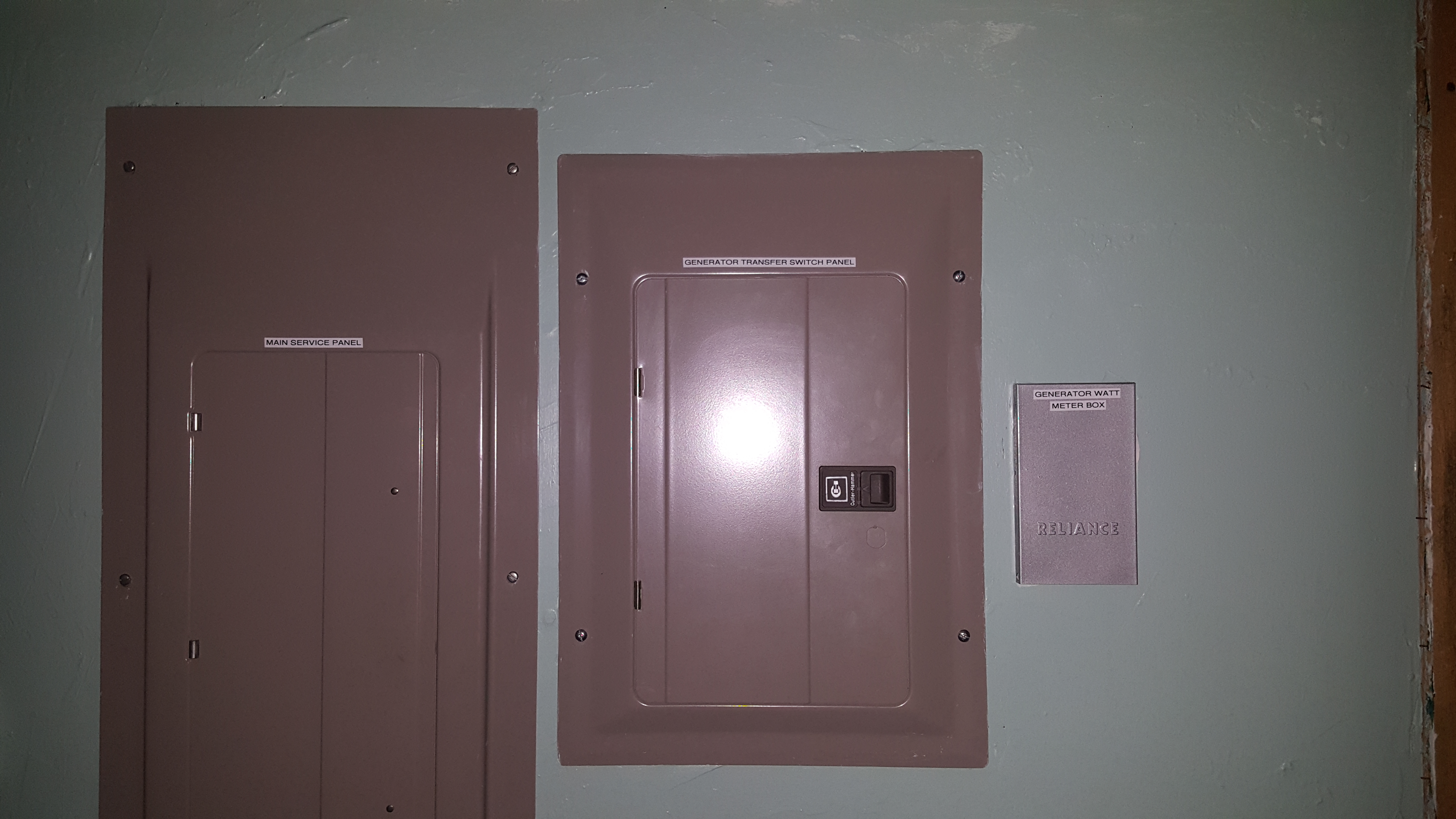

And once you have your "outside generator plug" (male end) wired up to your "generator transfer switch panel", then you may want to add a "meter box" to balance each 110 volt leg of the generator to insure one 110 volt leg does not have the majority of the (Wattage) load used while the other 110 volt leg has very little (Wattage) load use.
KC
