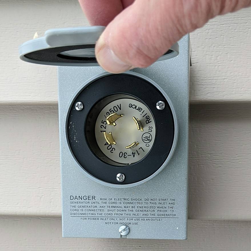

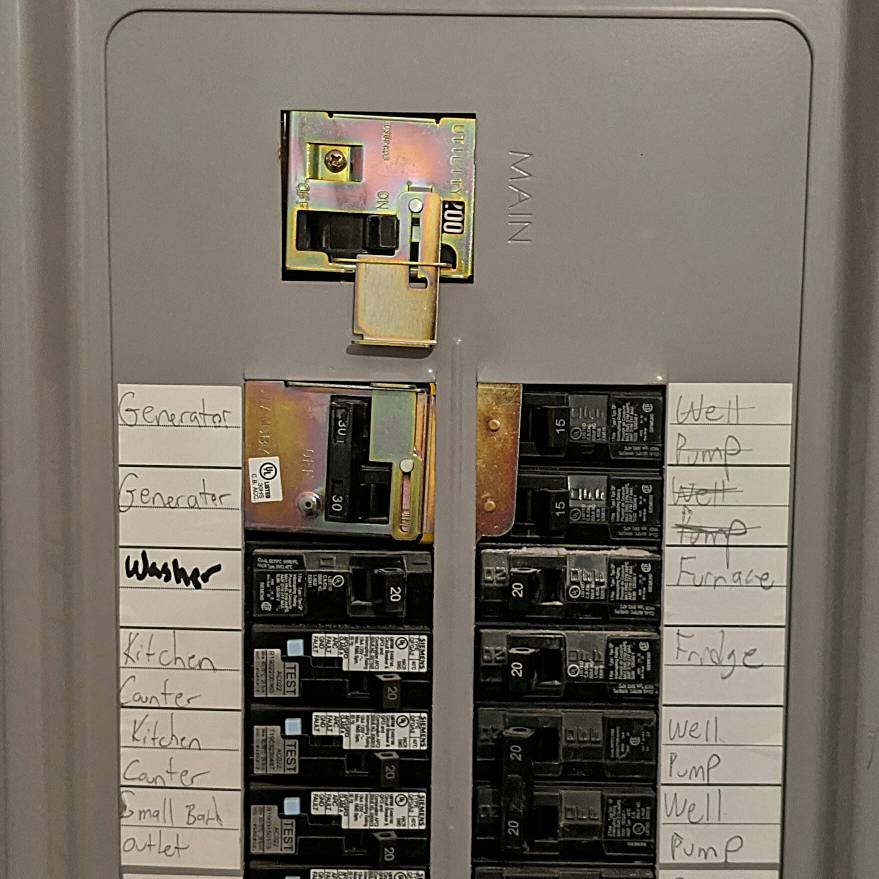

I recently moved into a new house with the pictured breaker box and outside generator connection.
I'm interested in running only the fridge, gas stove, propane heat control and well pump, plus a couple of LED light bulbs.
I understand the switching at the breaker box, and will disconnect at the meter (just as a fail-safe). But I haven't purchase a generator yet and I'm looking for advice as to what type and capacity I need. IMG_20191118_101916.jpgIMG_20191118_101813.jpg

It looks like the mechanical interlocks on those breakers force you to turn off the panel's Main 200A breaker (utility power supply) before you can turn on the genny's 30A backfeed breaker.
This is a MUST! (so genny doesn't feed back into utility line).
The receptacle and the 30A breaker (and most likely the cable in between the two) limit the genny supply power to 30 amps at 240V, or (240V x 30A =) 7200 Watts, no matter if Genny is bigger. You must manage your loads being run so loads don't exceed 7200W.
Typically, people want a breaker to trip before the genny stalls, although most genny's will have their own breaker that trips before it stalls.
You may want a generator bigger than 7200Watts to start motor loads that have a high inrush, but you'll be limited to around 7200 Watts running load by your panel's 30A genny breaker even if you go bigger than a 7200W generator.
If you go smaller than 7200W, the breaker at the genny might be <30amps, so that would trip first.

Best answer so far,
Yes, that device in the breaker box requires the main breaker to be turned off prior to turning the generator breaker on, perfectly legal generator interface in many places.
The power inlet is a standard 30 amp twist lock, it is ready to have a conventional 4 wire 120/240 extension cord plugged into your generator and to that inlet,
no fuss no muss, turn any breakers off that will overload your system.

I have this exact set up (looks like a Siemen's box). I have a 6000 watt 220 volt generator that I've converted to natural gas that I plug in occasionally to run the well or anything else on 220 volts. Then, when less power is needed (most of the time) I have a Honda 2000 120 volt inverter generator that I plug into the same inlet using a special plug that powers both sides of the panel. I can selectively turn off breakers to keep from overwhelming the little generator. I flip off the 220 volt breakers when the Honda is running, but the 220 volt devices see zero volts between the two legs, anyway.
