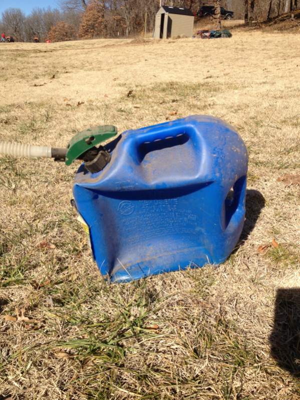

Does anyone know an easy way to rehabilitate a crushed plastic gas can? I am not sure why this happens... and I don't really care. I have about 5 cans that look like this. I am looking to make them useful again.

Any way to blow a little compressed air into them?

The problem results from a warm can being sealed, then cooled. The cold air contracts and sucks the sides in....
No problem with the water, just let them dry before adding fresh diesel. (or whatever you keep in blue tanks)
Leave empty cans with the top a little loose so air can get in and out with temp changes...

Fill with hot water then apply a little air pressure to expand. This could be done by just blowing into the spout (dont forget to open the pour valve) if you dont have an air compressor. With extremely hot water in the tank, it wont take but a very little pressure to expand it. If using your compressor, go gently with the air or you could explode the tank as the plastic will be pretty soft.

Put a little gasoline in it and set out in the sun. Don't let it bloat too much or it will never stand up properly again. Then, as mentioned earlier do not close an empty warm can tightly, or even a partially filled one, for that matter. I know, an open can could spill. Gas cans need to be stored so they can't tip anyway.

Even when mostly empty, most cans have enough gasoline in them to be full of gasoline vapor. Seal it up on a hot day, or even a warm one, and the gasoline vapor condenses on the next cold exposure (say overnight) creating a partial vacuum. The can is not designed to hold a vacuum and collapses.
A few ounces of gasoline and warm sun will expand them as NormL suggests.
/ How to fix crushed Gas can #16
Okay, I give... Why does it happen?
It happens because tanks today do not have a vent hole. Temperatures outside the tank warm up or cool down quicker than the contents inside the tank which can cause the tank to either collapse or expand. Its simple physics related to atmospheric pressure, which was one of the more interesting classes in High school many years ago.
