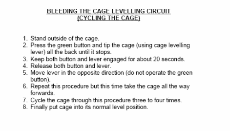

I'm going to watch a few videos on how over center valves work. It's been awhile since I had a hydraulics class and the only thing I remember is how basic PO check valves work. I also have to keep looking for the 145 bar reliefs.
Can you safely operate the cage tilt cylinder fully with the mast fully raised? I.e. knuckle cylinder fully retracted. Just curious is this would help remove any potential trapped air in cap end since it should be forced out to the cage cylinder.
I can't do it with the mast raised but that's what I do to purge it on the ground. Here's the air purge instructions from the manual. The green button they refer to turns on the hydraulic pump- it's a safety thing so you can't operate the lift without keeping this spring loaded button depressed.

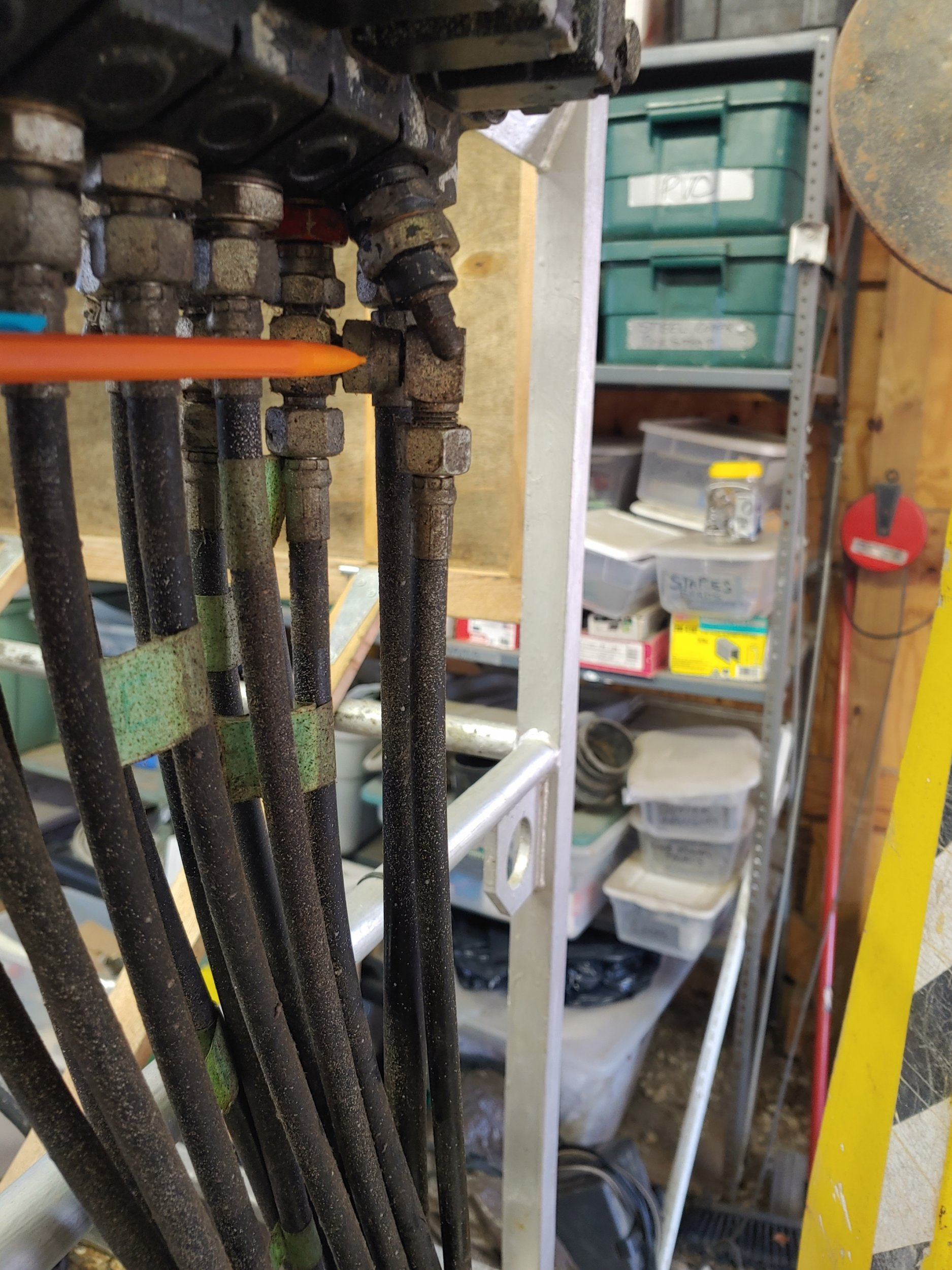

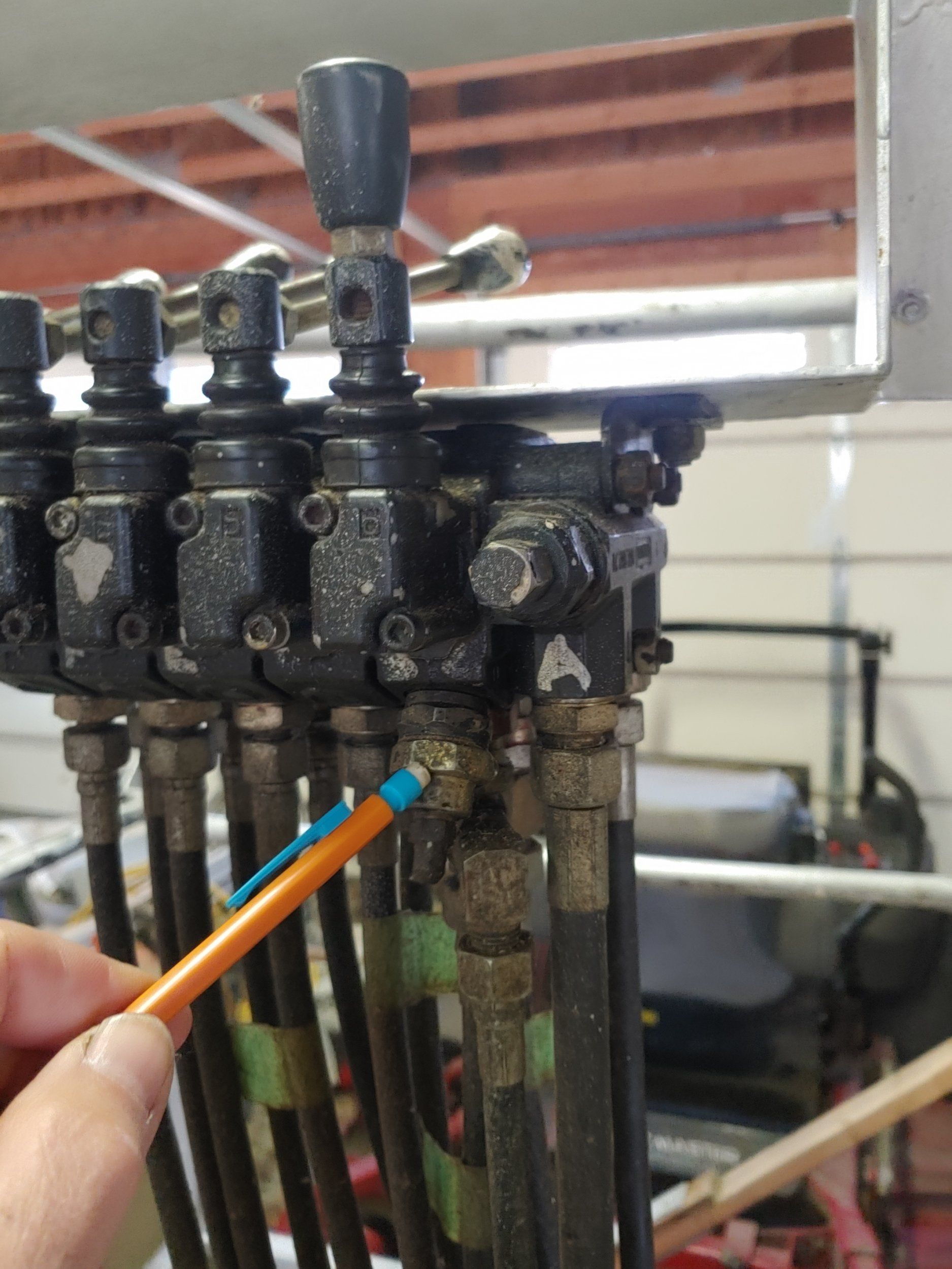

3 ) same with two relief valves set at 145 Bar. Are they separate line bodies or in a common valve body. Not sure if these are in play but trying to gain a fuller picture of how this is plumbed.
I found the 145 bar reliefs, they are both attached to the valve body that manually operates the leveling cylinder. My pencil is pointing to one of them, the other one is on the opposite side of the valve:
I also discovered that the knuckle cylinder and cage cylinder are T'd together in front of the manual valve. So that means when I manually apply pressure to the cage cylinder, it's also applying the same pressure to the knuckle cylinder. Of course it has no effect because the knuckle cylinder is too small and poorly positioned to have any effect on the lift mast. My pencil is pointing to the T that connects the lines from the cage cylinder and knuckle cylinder:
