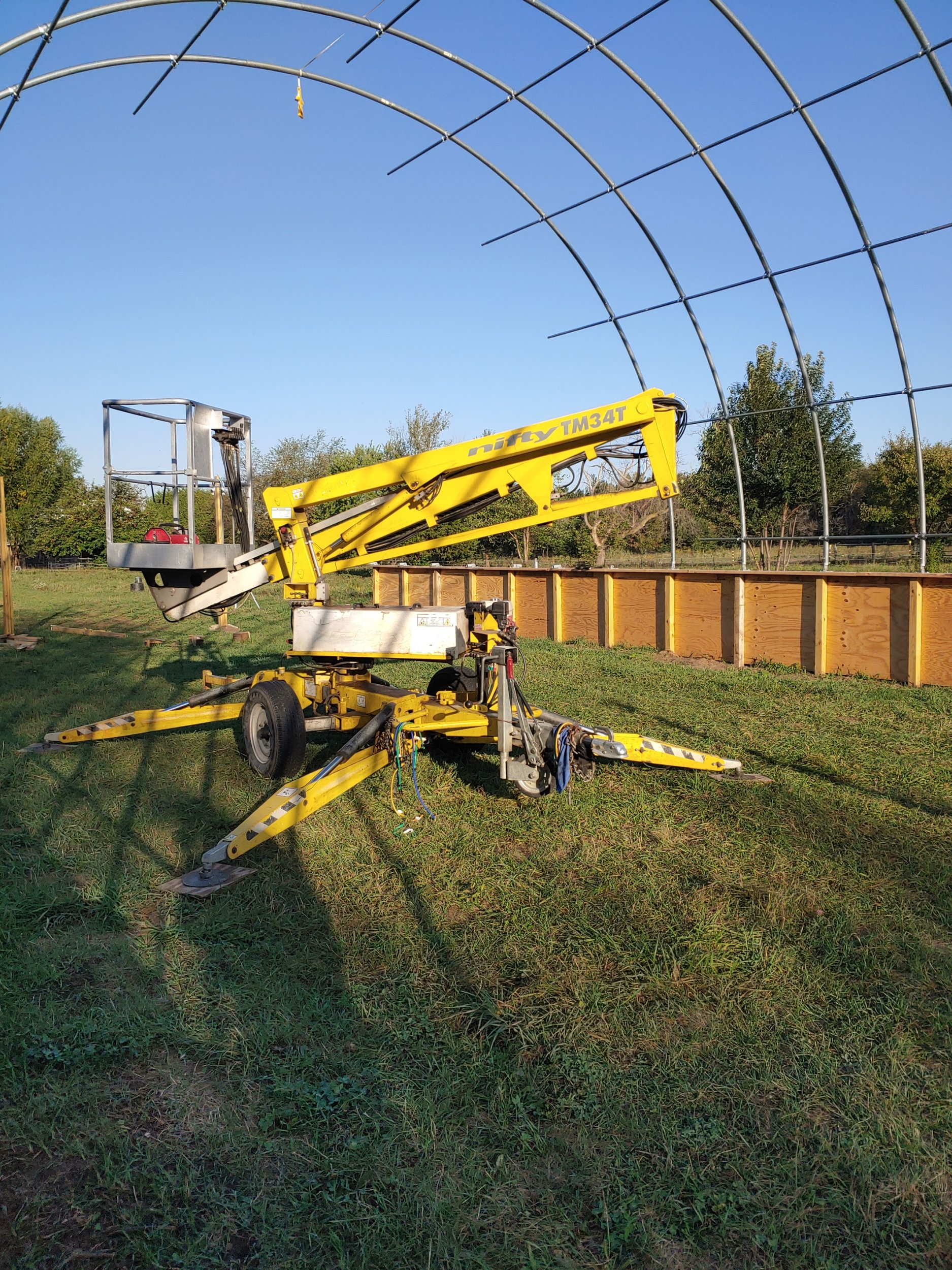

Is it possible to pressurize a hydraulic system to some low value to help locate a leak in the suction lines? I was thinking of fabricating a cap for the oil reservoir that will have a shrader valve in it so I can hook a compressor to it and put some low pressure (5-10psi?) in the system to find a leak. The reason I want to do this is in the next paragraph.
I've got an aerial lift, hydraulic circuit attached. The problem symptom is that the cage constantly goes out of level, and also moves out of level on it's own even when the system isn't running. In the circuit diagram the cage leveling cylinders are in the lower center area of the drawing, there is a cage cylinder and a knuckle cylinder. The bleed procedure given in manual is to cycle the cage cylinder fully in both directions, holding it at each extreme position for 20 seconds before releasing pressure. That works, the cage leveling operates properly for some time, generally an hour or two. But then the problem recurs. So I assume it's sucking air in the suction lines. I've tightened the fittings, the hoses are relatively new. I'm trying to figure out how to diagnose the problem before I just start replacing hoses and fittings with no idea what the problem is.

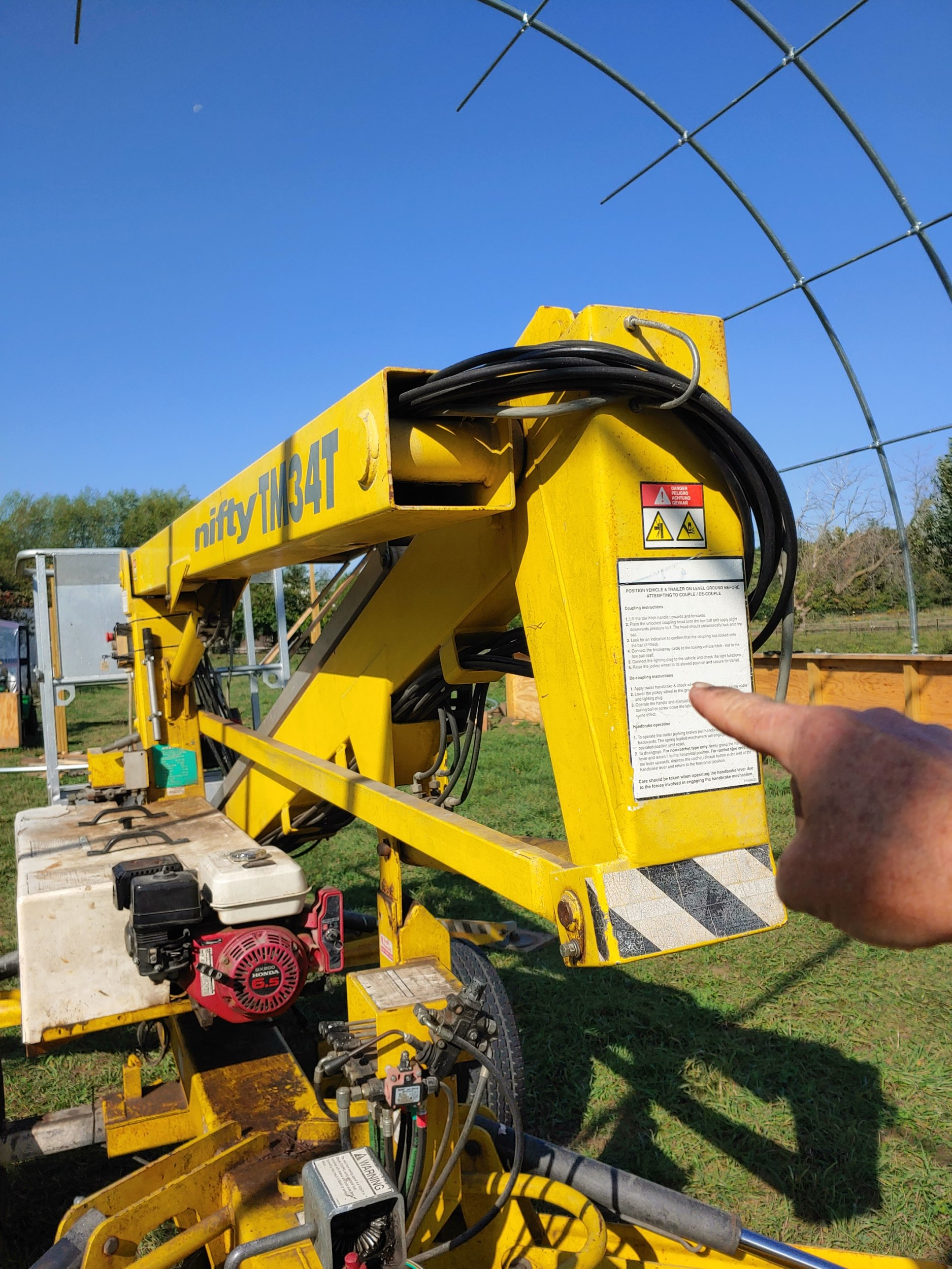

To help visualize things, here's the lift:
The knuckle cylinder is behind where my finger is pointing:

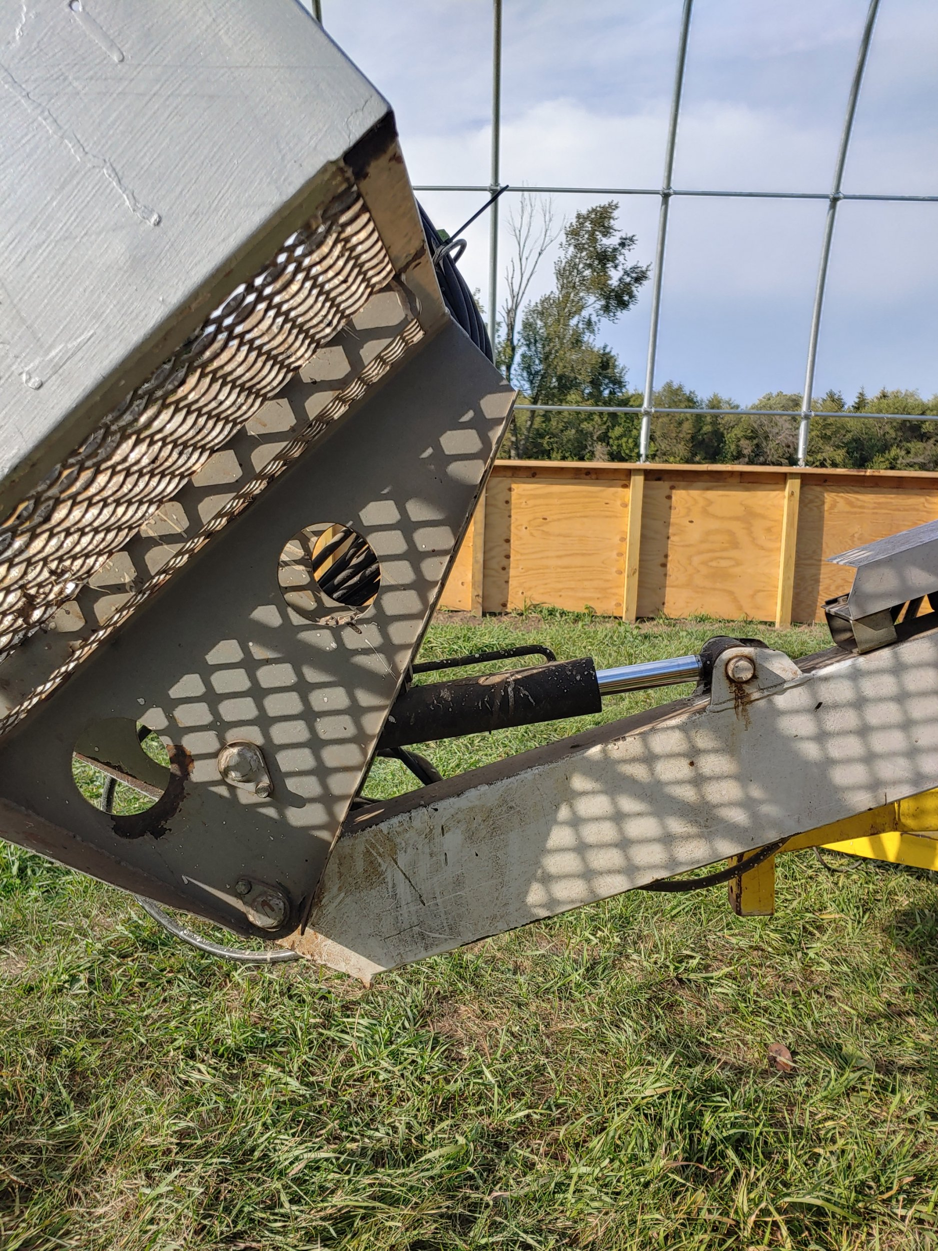

Here's the knuckle cylinder:
And here's the cage cylinder, I manually rolled the cage forward to make it more visible:
/ How to find a suction leak #9
Beez
Great job on the pictures they certainly do help.
Can the knuckle cylinder move without the main lift mast moving. Suspect no from pictures but would appreciate confirmation on this concept.
In looking at cage cylinder it could drift or extend if seals were bad but looks like load would trying to retract cylinder. Is this also correct?
does the cage feel spongy or bouncy after drifting out of position? If yes this would point towards air in the cage cylinder
shuddering can also be caused by the PO check and or the over center valve which could be another symptom or side effect of air somehow getting into the system

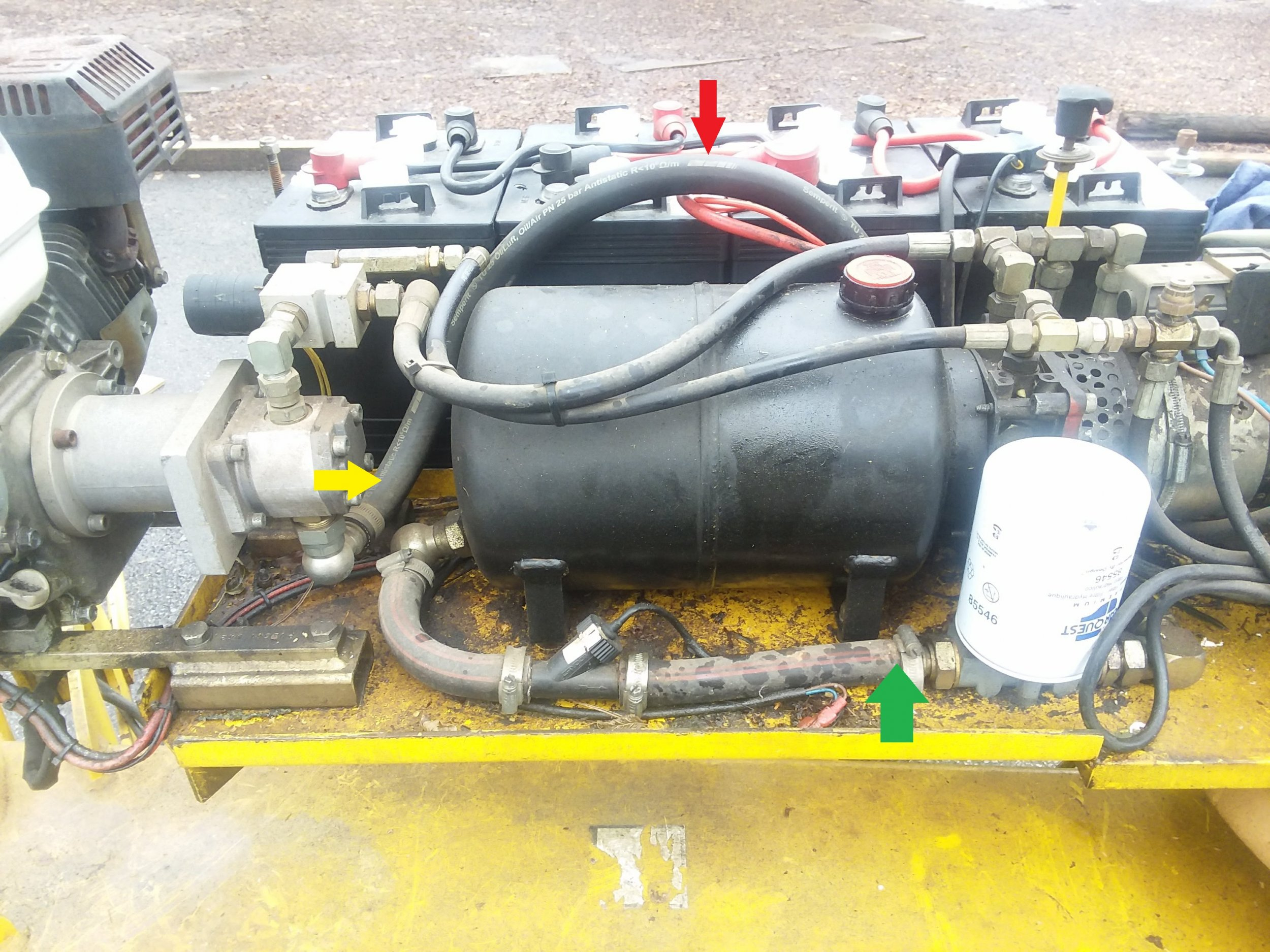

Here's a picture of the suction area:
There are two motors that can drive a hydraulic pump, the gas engine and it's pump are on the left, the electric motor is attached to the right side of that black cylindrical reservoir tank. The electric pump is inside the reservoir so it's not visible. Yellow arrow shows where suction line enters gas driven pump. Green arrow shows where suction line enters hydraulic filter base, red arrow shows the suction line that comes out the right side of the hydraulic filter base but is very hard to see because it makes a sharp turn to go under the electric motor. So there is a fair bit of suction plumbing that could be leaking. I've checked in the tank frequently and never see any evidence of foaming or entrained air. The tank is the only place in the system where the fluid is visible. The fluid level is correct, also note the only double acting cylinders are the stabilizers (and the leveling system), the lift cylinders are all single acting. I don't think that matters with respect to this problem. There is also a hydraulic motor that rotates the lift. If even a hint of air entered that motor it would be easy to feel a stutter in the rotation, and I've never felt anything.
The other part of this that makes it feel like an air problem is that I've had the lift for 8 years. When I got it, it displayed very slight shuddering in the cage leveling circuit, and when I bled the air it stayed good for a long time (days). Over time the problem has progressively gotten worse to the point where this year it also started this drifting behavior when the pump is off. So it really feels like a small air leak which has gotten progressively worse with time. But it could also be some other hydraulic component that has gotten progressively worse with time.

Interesting thread. Oldnslo is giving great advise. That is one seriously ugly suction plumbing. Upside down filter? Suction line with a loop higher than both the pump and tank? Surely the factory didn't do that. May not have anything to do with your problem, but how do you ever get all the air out of that?
