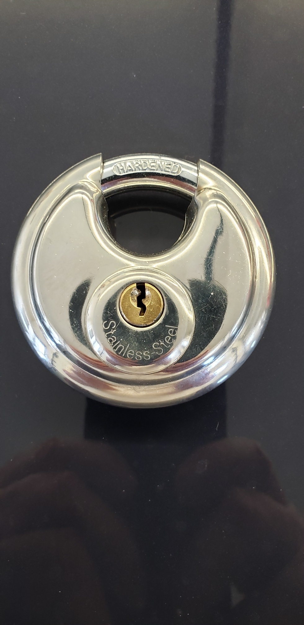

I have a padlock that I would like to wright a name on.
But do it in a permanent way so that a kid with an itchy finger can't scratch it off.
And I would like it to be weatherproof for as long as possible.
Any ideas?

Dremel with a small carbide bit and write carefully as they love to wander

Vibrator pen with a tungsten tip.
Coat with car wax after.

Electric engraving tool. The one I have is ear splitting to use.
/ How to etch a name on chrome #8
electro etching or acid etching (depending on the type of stainless) ... just need good mask for areas you don't want blemished. Any number of cheap DIY setups (look at some knifemaking sites). As I remember, AC will create black mark and DC will do the cutting/etching. Salt/vinegar/water and a 5-12v power source. For acid etching, you need carbon in the steel to bring on the color change ... so the stainless series will determine whether acid will work. If you use acid neutralize & clean afterwards then wax or seal since the etched part would continue to rust potentially. Depending on the chromium and/or nickel content, cold blue/hot blue might work, but you need to speak to gunsmiths for more about that in terms of the temps needed & characteristics of the color for what you want to do.

I think an engraving pen is the best answer. Some of them are not very expensive, and they are easier to control and actually write legibly with than a Dremel tool.
/ How to etch a name on chrome #14
If done electro-etching. If you have a label maker, check to see if you can get masking tapes for it. I have a brother labeler which I can print to from my computer. So, I can add graphics, etc. to the etching mask.
