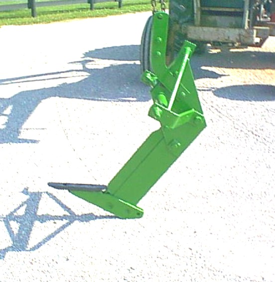

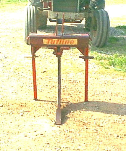

I would try to use a HD deep penetrating subsoiler first(24-26 inches deep about every 3 ft apart) and if that don't work, go to plan B. Ken Sweet
/ How to Dry a Field #11
If the water table is high, subsoiling it will not do anything cause the water is close to the surface, if there is a clay lense that holds the water on top and you can get to it by the subsoiler, it may work. Around here on the coast (High water table) they dug ditches between the fields anywhere fron 18" to 6-8 feet deep, the water will flow out of the soil into the lower open ditches and stand there and eventually run inot roadside ditches into a pond or river or swamp.
/ How to Dry a Field #12
If the water table is that high, A subsoiler would do no good at all. I have 17 acres like that myself. Ken Sweet
