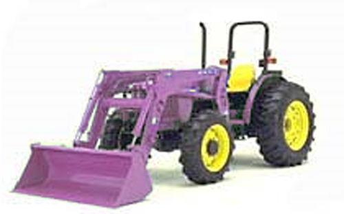

   / How to deter theft - how about this idea #38
This could work :D:D:D
