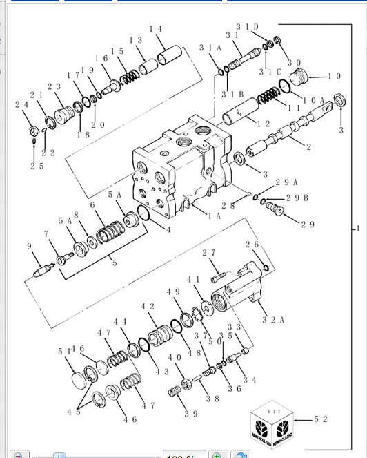

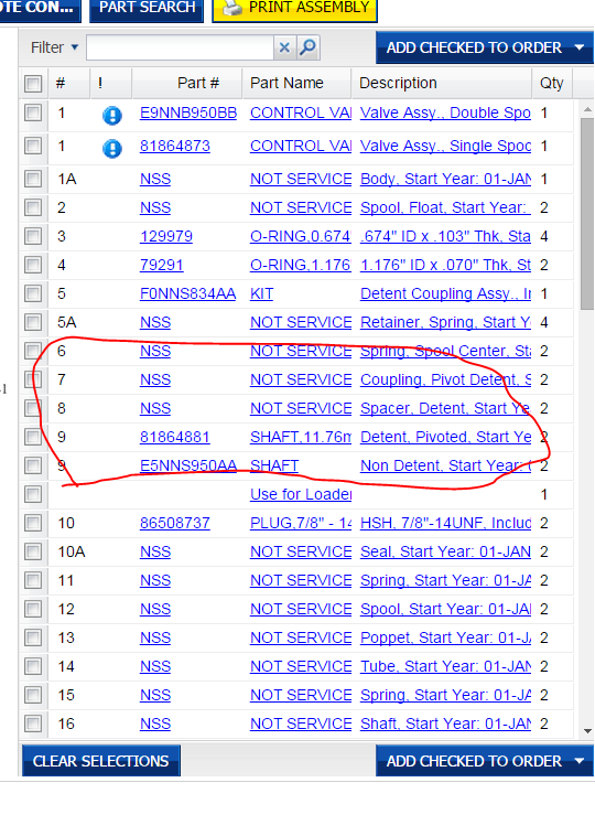

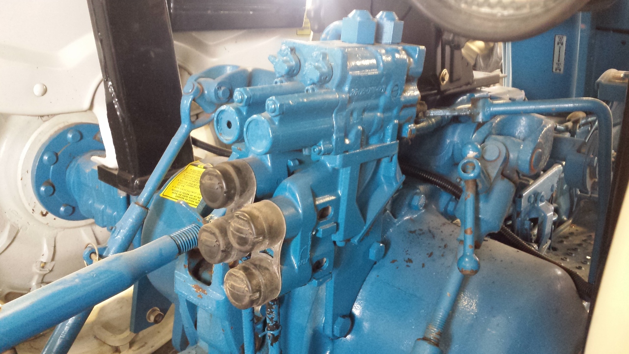

Is it possible to remove the detents in one of these valves to eliminate the SCV feature?? If so can you explain the procedure? I can't seem to find a schematic of these Ford valves. Thanks in advance.

The lovely Ford CCLS breakaways. I hated them back when I owned my 5610. Does this schematic help?

If I study it long enough Jim. I'm assuming theirs a detent ball/spring somewhere in there?
I've not used these yet, just bought the tractor. They're on a 3910. What did you dislike about them and is it changeable?? I will use these quite a bit so want them to be easy to use. Thanks Jim.
