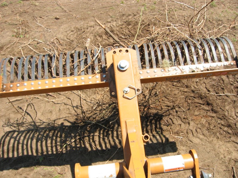

OK, here is the update. First, I removed the guide wheels. Second, I switched out the standard toplink for the hydraulic one. Then I went and loaded up the rake so I could test out some of the ideas on cleaning it.
Before commenting on the cleaning, I have to say that removing the guide wheels makes the rake a whole lot easier to control. I don't think I'll be putting them back on. Also, I had not thought of using the hydraulic top link with the rake but that really also increased the flexibility and control considerably. It is nice to be able to make those changes on the fly.
Now, as to the cleaning. I first tried just extending the toplink all the way dropping the position control to lower the rake and backing up. No joy. The roots/vines/sticks/grass/canes etc did not unload.
Next I tried backing into a brush pile. Not much better. It just crushed the brush pile and got tangled so I ended up pulling some brush out of the pile when I drove forward. I had backed in with toplink extended and rake low then raised the rake. It just pushed the brush out of the way but the crap on the rake stayed put.

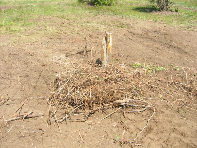

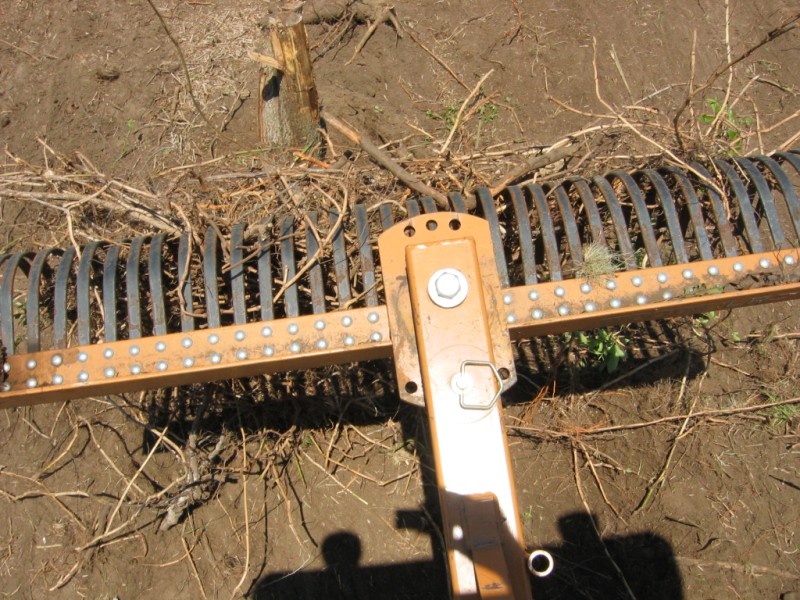

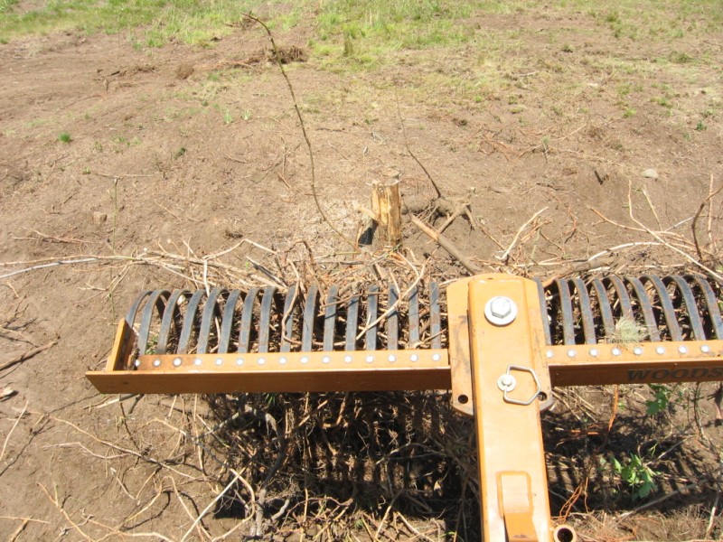

Final approach was to back into an isolated stump (6 inches x 3 feet tall). That did work quite well but took six or seven passes to get all the debris out. It did work however. I used it several times after loading the rake up again and it worked each time. Unfortunately I got a little aggressive on my last pass and busted one of the rake tines when I backed in too far before raising the rake to scrape.
Photos below show the tree stump method results.
My bottom line is that the stump method works but is pretty inefficient because you need to move the tractor a number of times to scrape each section about a foot at a time of rake width. A nice six foot I-beam mounted scraper about 18 inches high would be ideal if there was a way to transport it.

I broke the tine when I intentionally backed into the stump I was using to clean off the rake. I backed too far one time before scraping the rake up with the position control and the stump got pushed between the tines right at the top of the tines where they connect. One snapped off. I've never broken one before but it is no big deal to replace and I think will cost about $4 or so.
It does show the disadvantage of the "stump rubbing" approach to rake cleaning though.
