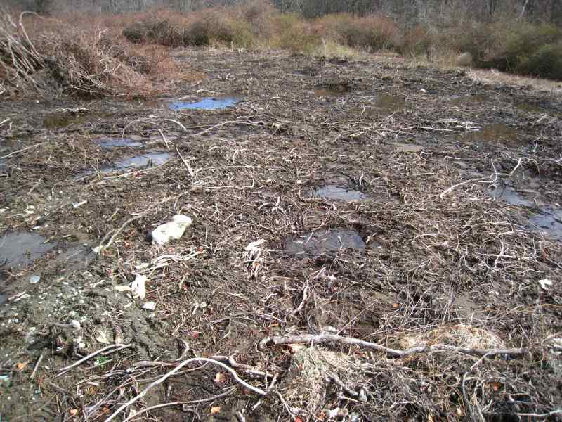

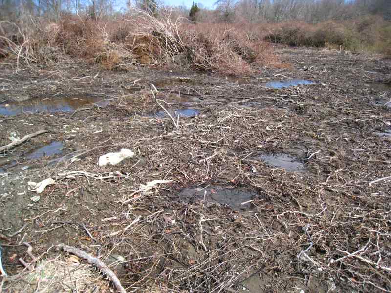

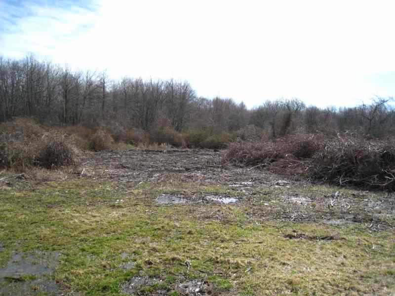

tuolumne said:
Island - wouldn't that jobber on the front of your tractor do a grand job of picking up the bigger stuff first? Also, I thought the flail mower pulverized stuff more than that?? Do you mow first, or are you just raking through scrub to generate that tangle? I can usually back into a pile to unclog my rake, but I do not have a gage wheel. This has certainly been an interesting discussion as usual.
Here is a photo of the type of land I am raking. I've already been through it with my grapple removing bushes and have already mowed with the flail to get the above ground plant material which is mostly briar. What you cannot see are the numerous (?innumerable :eek: ) subsurface canes from the briar. There are a few little sticks that get caught up in the mess too so the rake is full of more than just the briar roots. You can see that the land is quite uneven due to my grappling whole bushes/trees out rootball and all. The puddles are all stump holes or bush root ball holes. I had hoped they would disappear over the winter but no such luck. That is why I need to resurface the whole area so I can return to regular mowing which will in a year or two allow grasses to replace the invasives.
The more I look at these photos the more I am thinking that John Bud was right that I should just disc the area. I don't own a disc yet but this could be the excuse.
