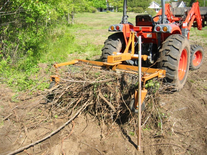

After clearing brush and digging out stumps, I usually run over the land with a landscape rake to even things out and to collect debris and small roots. I find that the rake quickly loads up with roots and twigs and I am wondering what techniques the rest of you have figured out to clean the tines. I started just trying to kick the stuff out but graduated to using a five foot copper pipe that I use to push the material down. It takes about 5 minutes to clean the thing and obviously requires getting off the tractor. Photo shows the state of the loaded rake and the cleaning tool propped against it.
Does anyone have a better system/method for keeping the rake clean while doing this sort of work?

You need to make a hydraulically operated comb to clean it, Just raise the rake-operate the remote lever to push the comb down through the rake tines an BadaBing...all clear!

Make a comb that you can back the rake up to and then raise the 3pt to clean it.

When mine looks like that I will get real close to the brush pile and then back up into it. The brush pile will usually comb most if not all of it from the rake. When you are raking roots, limbs, and twigs try removing your wheels. I don't have wheels on mine, so that works for me.

Take the wheels off until you have done the clean up and roughing it in. Then put on the wheels and that will help final passes.
My thought is that the wheels are not letting the rake press down hard enough so the debris is not staying in front.

Yes, the rake loads up like this regularly when I use it after first bush hogging (or flail cutting) in areas that have a lot of bull briar. The material is mostly roots/canes that are fairly close to the surface and are ripped up when I try to smooth out ground following stump digging or simply ripping out saplings.
I find it is more time efficient to simply let the rake load up than to stop every few minutes to kick out a few roots/canes. As I noted, I'd guess it takes about 5 minutes to clean after doing an area about 1/8 to 1/4 acre. I still have at least another 10 acres to go so would love a more efficient method of cleaning.
Believe me I've wondered about why no one has developed a mechanical or hydraulic comb!:D Where's 3RRL when you need him? I have rear remotes so I just need drawings and instructions! I imagine that most people don't use their rakes primarily for this sort of clearing and that it is not a big enough issue for anyone to have gotten mechanically creative yet.
John Bud's suggestion to remove the wheels is something I could try. I don't know that it will prevent the rake from loading up though as I have the wheels and 3pt toplink set up so the rake does allow the tines at least an inch of penetration and the front is tipped down so the rake doesn't "scoop" too much. Should I try the opposite and put the rake in a more aggressive posture by lengthening the toplink? I did not take a before photo of the area I raked but you don't see this debris on the surface. It is 90% subsurface roots/canes. If the tines dug in further I'd be moving more dirt than I really want to and I believe that the roots/canes would simply migrate up the rake anyway. It looks like a basket weave when fully loaded and when the roots get all stacked up it really takes some force to get them out.
If I do remove the wheels then I can try the suggestion several of you made regarding backing into a brush pile and scraping it off. I'll give that a try. I am not doing fine finish grading so the wheels are not really critical for me. I got the rake used and it came with wheels.

Just thinking out loud......If you were to weave a piece of 5/16" wire rope with eyes on each end through the tynes a couple of times and secure the ends to the rake . When you need to clean the rake , lay the rope ends on the ground and back the tyres onto the ends while lifting the linkage . In theory as you reversed , it would pull the debris out .

Well guys, I just went out and looked at the rake. The problem with the wire rope solution is that you'd need to figure out how to keep the wire rope from riding up past the vertical part of the rake tines as otherwise the rope would just be pulled forward tight onto the rake tine attachment points rather than down and off. It also occurs to me that once you'd successfully "dethatched" the rake that you'd need to reweave the wire rope again. Perhaps there are ways around this problem but it doesn't seem quite as good a solution as it did at 4AM.:)
I suppose I could just not use the rake for this application as suggested by John Bud but that would leave me trying to mow weeds in an area that still had a fair amount of wood debris and would also have stump holes that would require filling and leveling by some other method. I have thought of getting a disc to deal with the roots/canes but that won't solve all the issues. I guess I could use a box blade for leveling but I'd prefer not to leave larger chunks of wood or rock to hit with my mower.

How about trying this: temporarily clamp a flat bar across the width of the rake with several clamps to keep it snug. Position it at the apex of the curvature of the tines or maybe just below the apex. You will still have the "pick-up" ability of the points of the tines and the material can still roll up on the inner surface of the tines but the bar should prevent the material from being driven up the entire length of the tine interspaces, thereby making it much easier to back up and reverse-rake the materials out.
Now, if you had TnT on the tractor so you could tilt the leading part of the rake up (the leading tine points would go forward) and then reverse the tractor with the rake engaged on the ground or brush pile, etc. this theoretically make it possible to "clean" the tines without leaving the tractor seat (high priority): :D
Then. if this works you could permanently weld the bar at the optimum level or develop a slip-on and off attachment method; e.g. with a few eyelets to slip over selected tines and having set screws or set-bolts to hold the bar in place on the back side of the tines.
