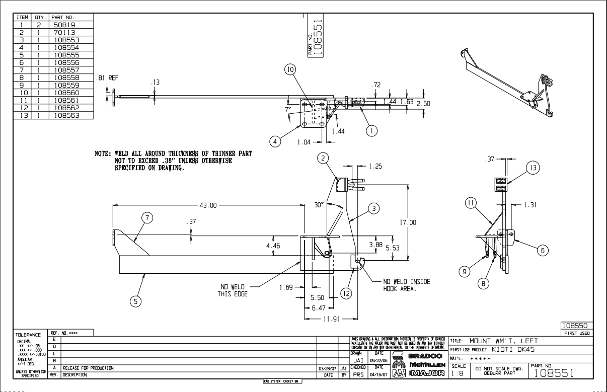

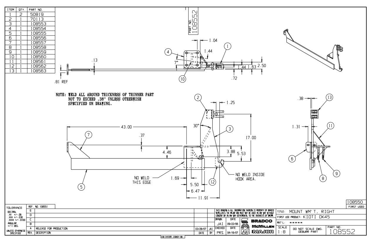

It's been over a year since anyone has posted on this thread but hopefully some people are still around. I'm considering matching up a Bradco 609 or 611 with my Kioti DK45S, I'm hoping someone has some pictures and ideas for a subframe. The DK45S was only made a few years starting around 2005, I'd really like to see some photos of the tractor with a subframe whether it's DIY or from one of the manufacturers.
I called Bradco to see if I could get a subframe from them and they do make (or did make) a subframe for my machine but it's made for the KL1590 Loader and I have the KL451 Loader. Additionally, the Bradco Rep. said that procuring the subframe would be expensive, around $4K-$5K. He sent me the part numbers I would need and drawings of the subframe for the KL1590:
108550 TR Half Kit
108565 BH Half Kit
Excellent thread btw, thanks for all the info DFkrug.
View attachment 603835View attachment 603834
Yeah, custom-made out of unobtanium. That price is how the rep says, "no".
Bradco hoes and subframes are very robust and well-made. They are usually the OEM hoes for Bobcat skidsteers. You can pick them up used for a few $K around here. If you found one, a custom-made frame is your likely next step, whether DIY or from a welding shop.
The drawings show a 2-part subframe with hooks to aid in mounting. Thanks for posting.

I'm gonna call around and see if I can find that Bradco subframe somewhere. If not, those drawings are a pretty good start. I'll take some measurements to see if those drawings will match up with my loader and if so, it might be as simple as having someone produce the subframe from those drawings.
I'm all about DIY stuff and the sense of accomplishment but I have enough irons in the fire at the moment so I'm gonna do what I can to simplify getting this done.

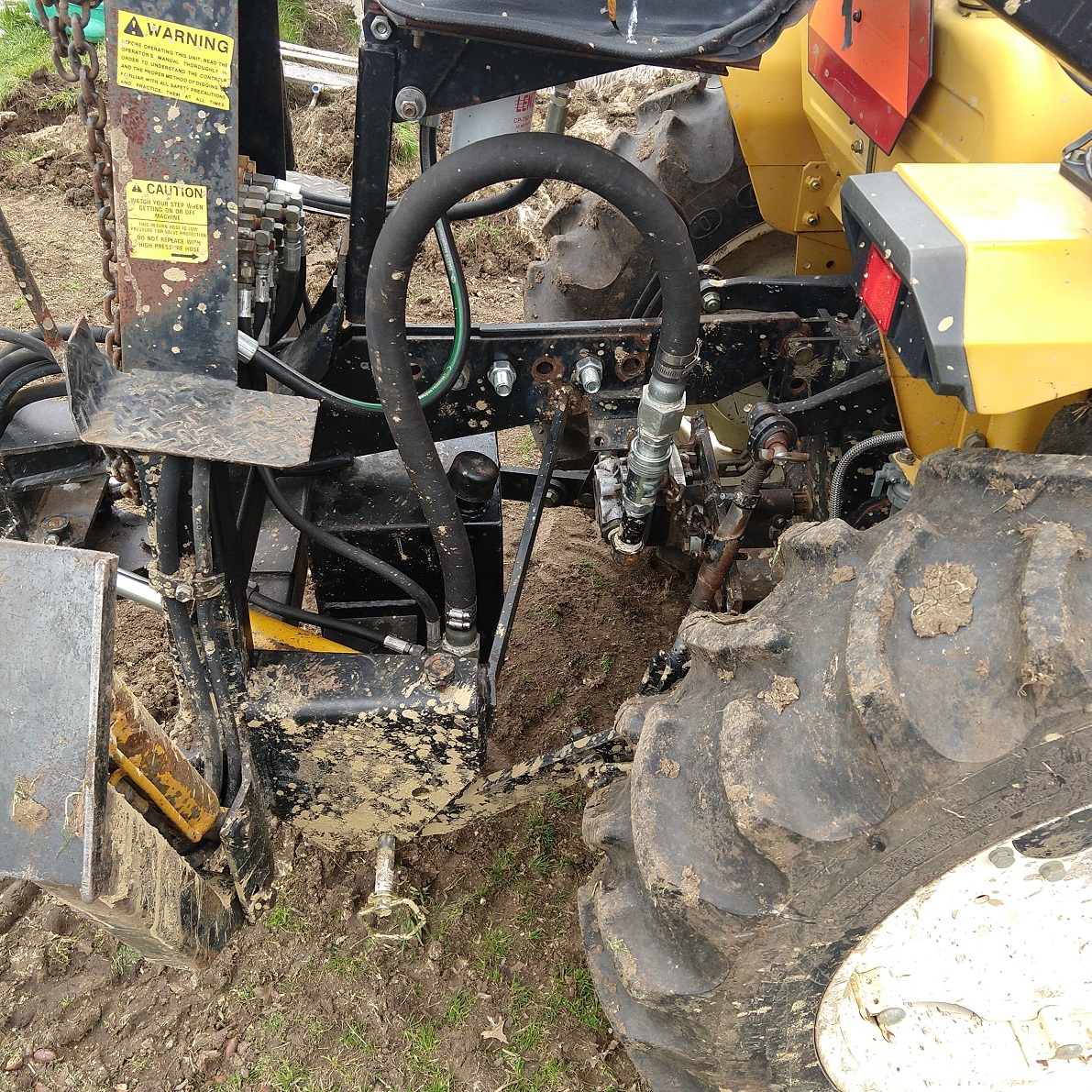

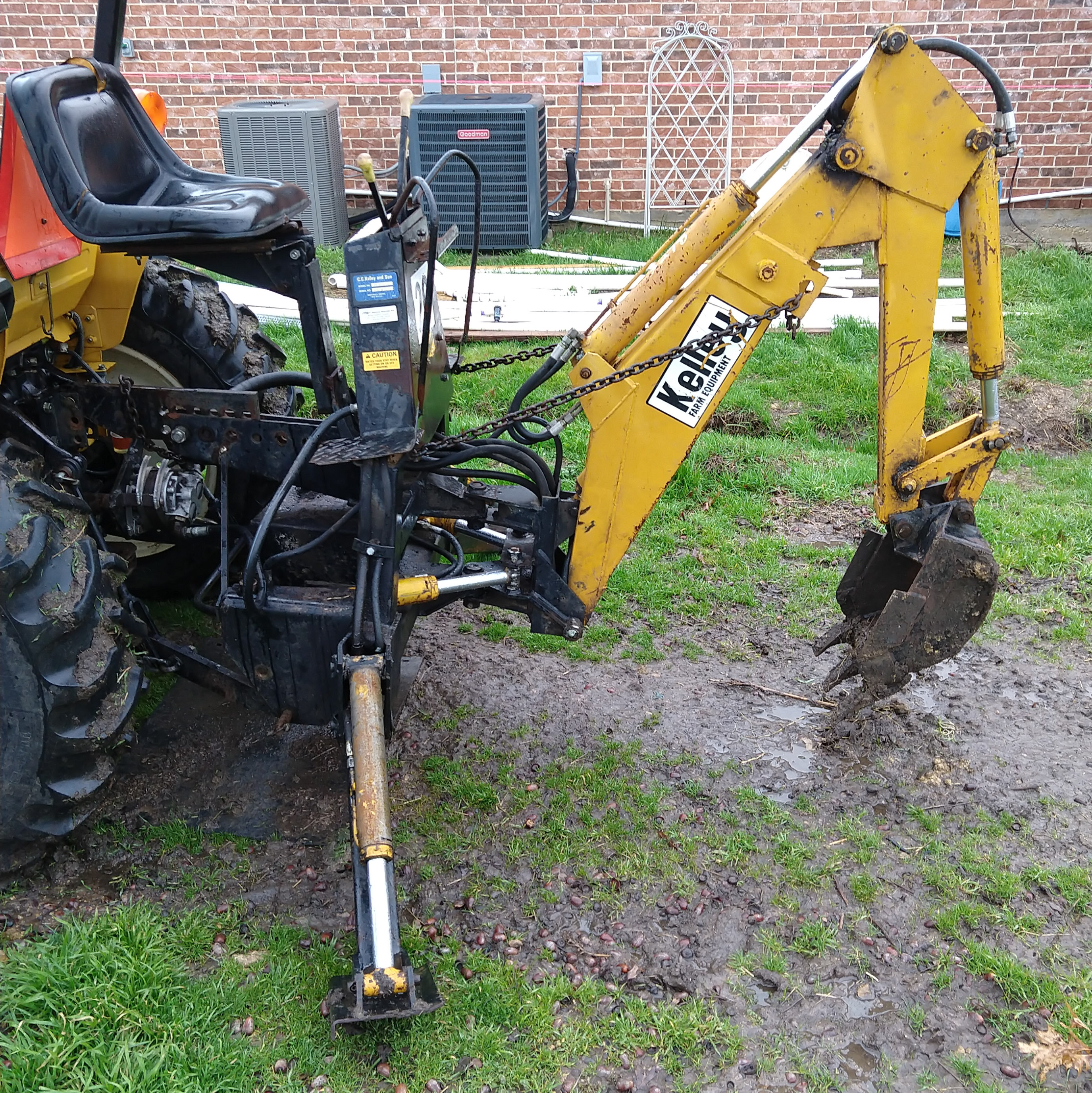

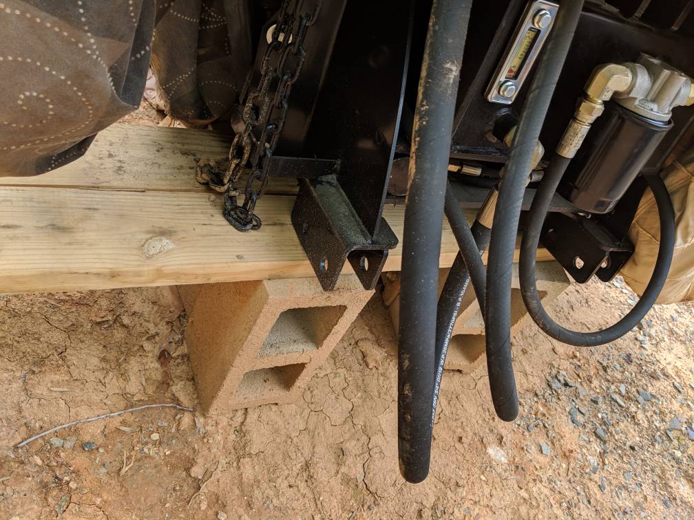

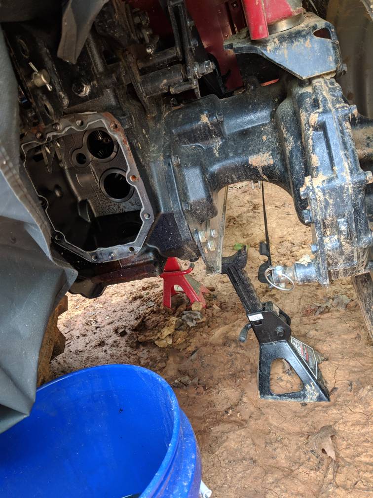

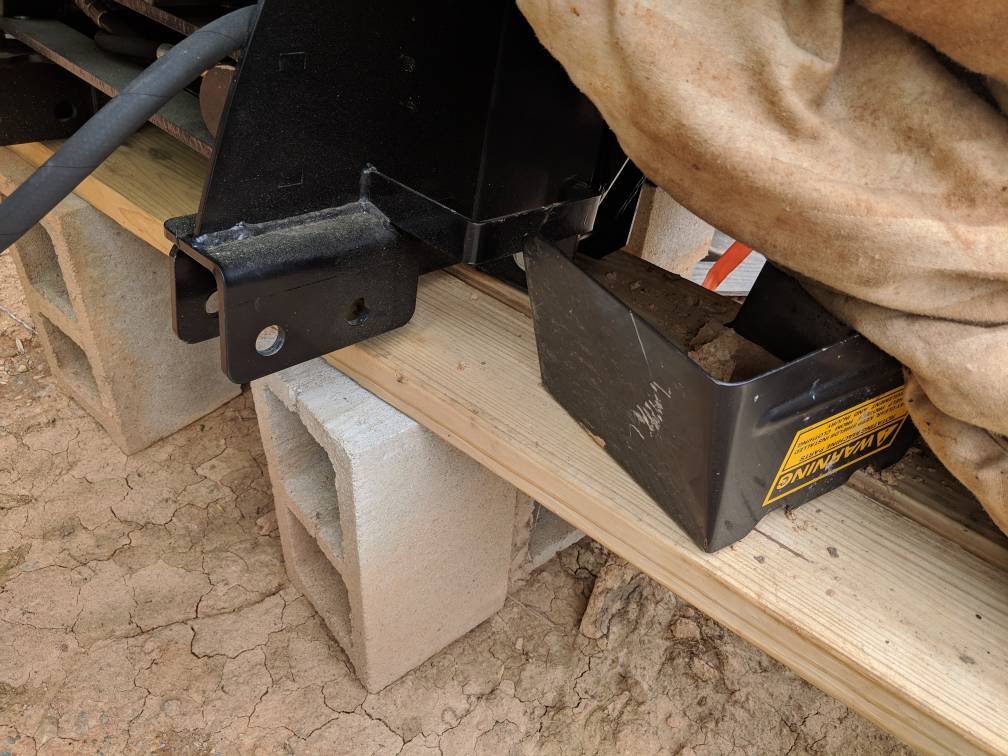

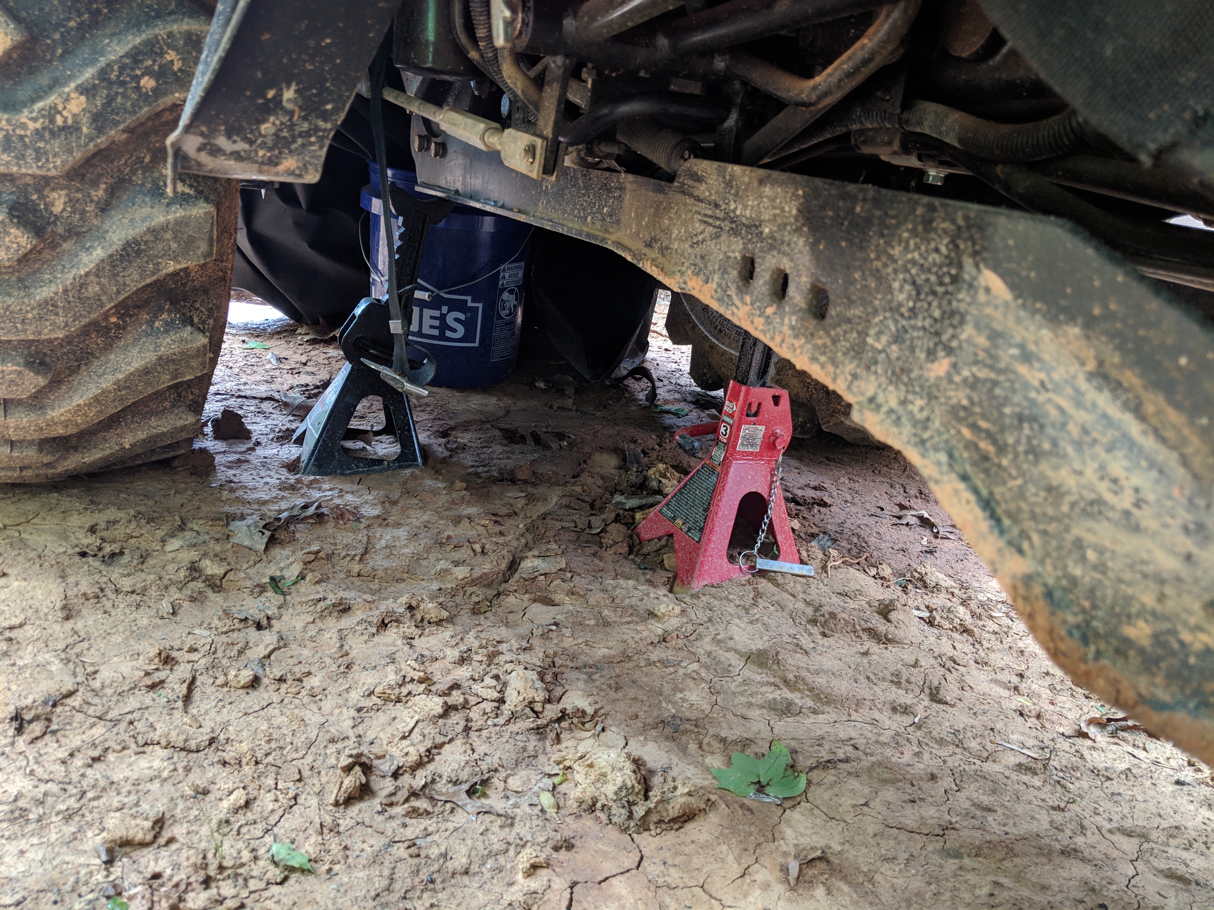

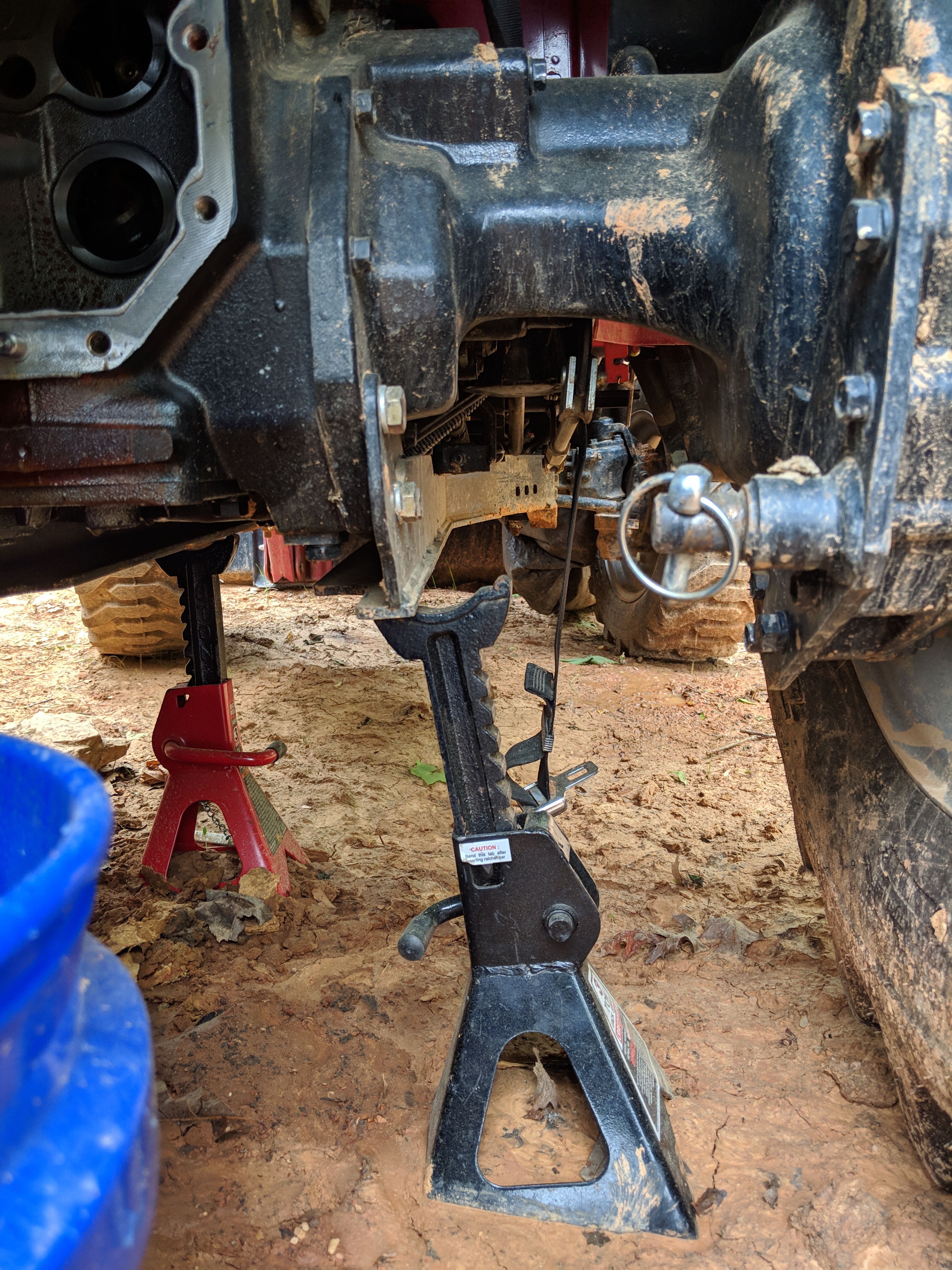

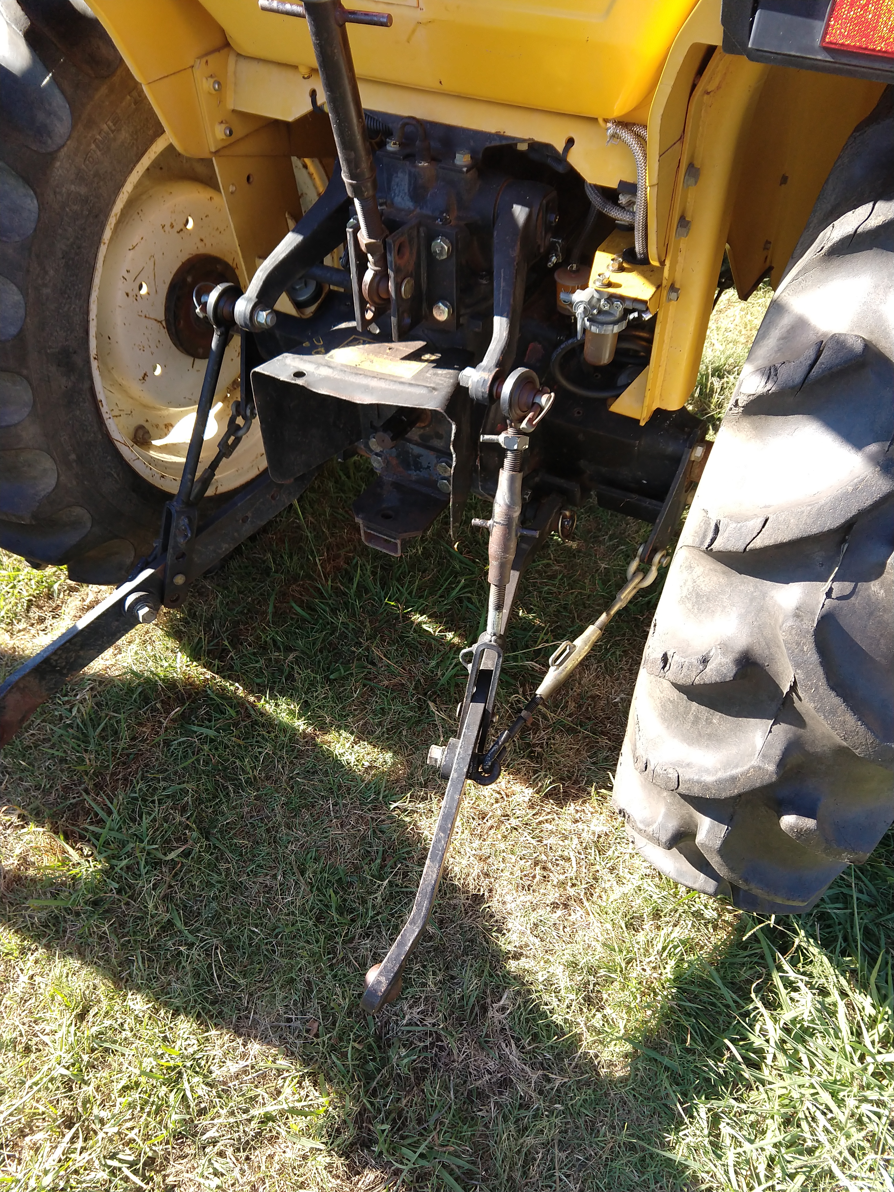

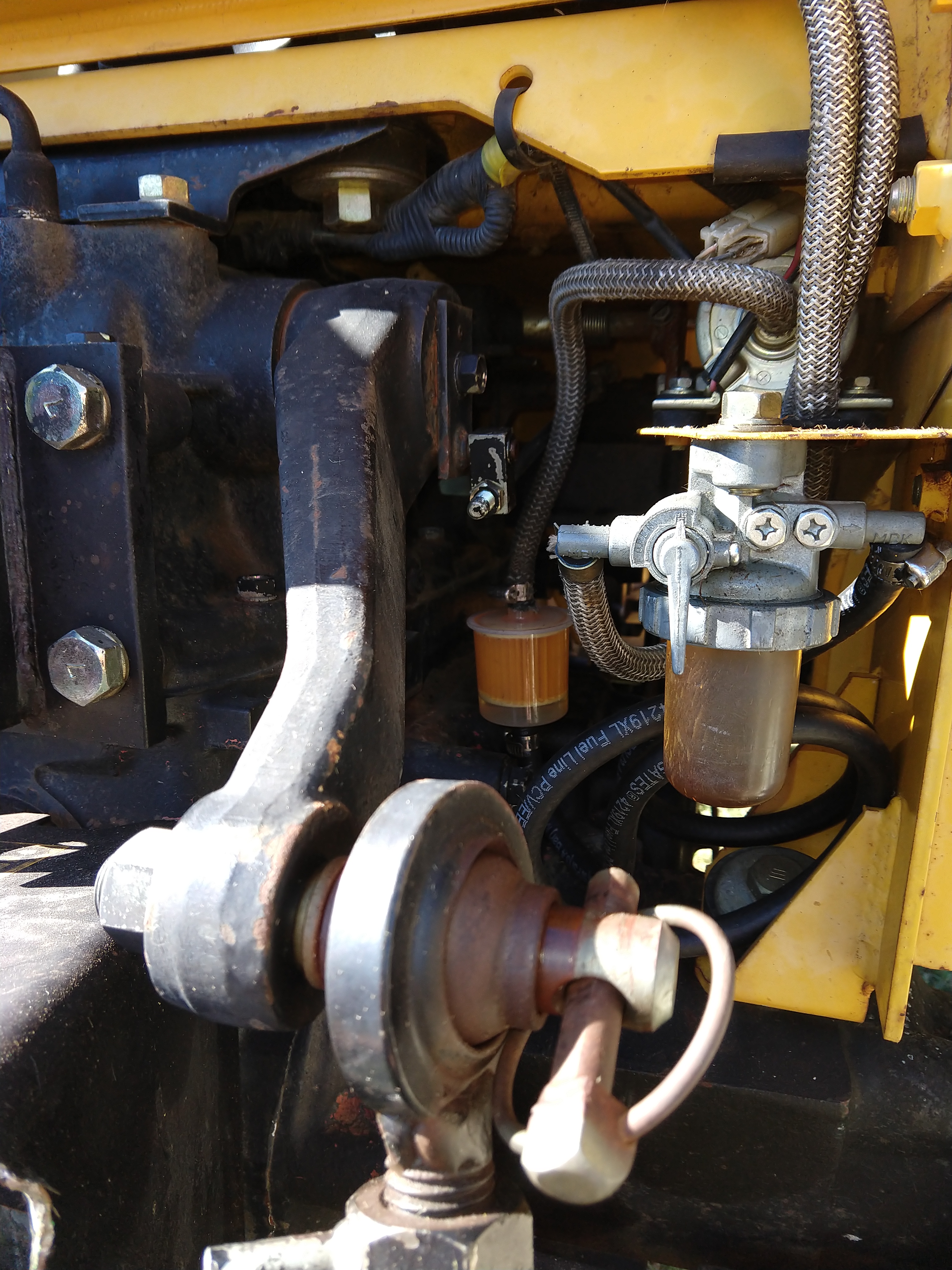

I'm wondering if its feasible to try to fab my own subframe for my Mahindra 1526. I have a 3pt backhoe BH5600 (BH56 PTO 3 Point Backhoe Tractor Excavator Attachment w/ Pump 15" Bu SDI Factory Direct Wholesale). I really want a project so i'm wondering if I can fab my own subframe. Any helpful tips out there?? I've spent the last few days reading through this awesome thread and seems like the ladder style would be best possibly? It already caused the PTO shaft to snap somehow when my family was using it while I was at work. That's why all the fluids drained and currently its sitting. Pics attached of the underside of my mahindra and view of underside from back right tire. Also pics of backhoe where 3pt mounts. I'd even be up for a quick call if anyone has advice Thanks. Plan to pay it forward. Trying to start a small little weekend tractor business to do some grading, digging, trenching, etc. Havent been able to use my tractor in 2 months bc of this PTO repair.
I would suggest reading all the OP posts in this thread; they have a stock pile of wisdom regarding the plan to "cut your teeth" on such a ground up project from scratch. Granted others have added in wounderful info along the way.
cheers.
