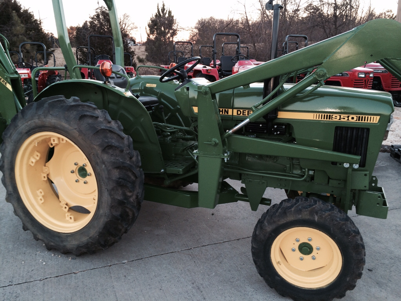

There are a few UTDA dealers in your GA state to offer restored and upgraded YM Yanmars with loaders. The price is very attractive and they have either a full 1 year warranty or full 6 month warranty. Many of them are in the pixs I had posted prior.
Not only can they restore Yanmars to their 120% state (extra 20% has all new ROPS, seatbelts, PTO shields, etc that were not OE back in the day.) They also do John Deere's made by Yanmar too. Here is a 1984 JD950 4WD and loader made by Yanmar for Deere fully restored in 2014.
That makes sense. I saw references to Fredericks Yanmar on tractorhouse and wondered what that was. Thanks!
