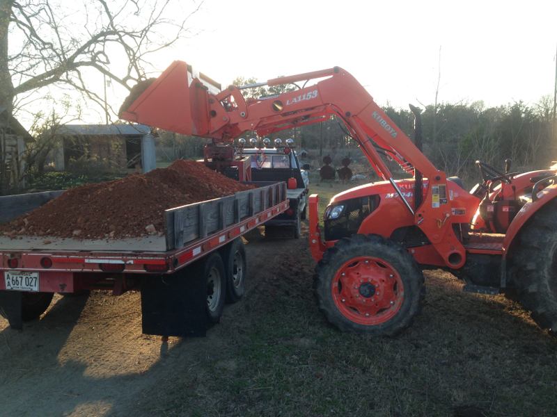

Replace when they fail .
Heck this old dump trailer has a 14' hose that I just replaced because it blew . It's been on there since 1972 its a old grain trailer . Here it is get'n used the next day with the new hose .
Sent from my iPhone 5 using TractorByNet

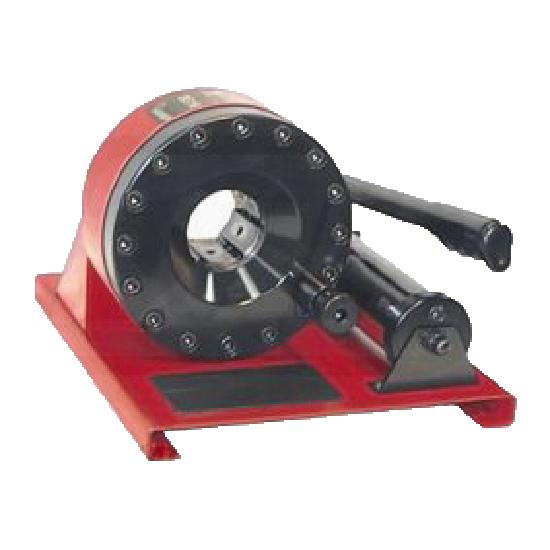

Since I own press to crimp hydraulic hoses, I use to wait until it breaks before I replace the hoses
