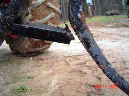

The manufacturer is making a new one for me. Here's a picture of the new design. The new design has a pivot mechanism built into it to help with the lateral load. I'm not sure about this - guess I'll wait and see how it works when I get it. It looks stronger than the original. I thought it should have more reinforcement near the 3pt hitch lower arms. I should get it pretty soon - so he may have added that already. Any comments are greatly welcomed.
I don't drag too many logs. Usually I just carry them with the grapple bucket, but some logs are too big or not in an area where I can drive with 10 feet hanging out of each side of the bucket.
Thanks,
Mike

/ How not to skid logs #54
That looks like a great fix. At least the hitch won't be the weak link now. /forums/images/graemlins/grin.gif

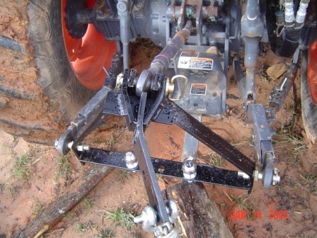

#55
Here's the finished product - now for a field test next week.
