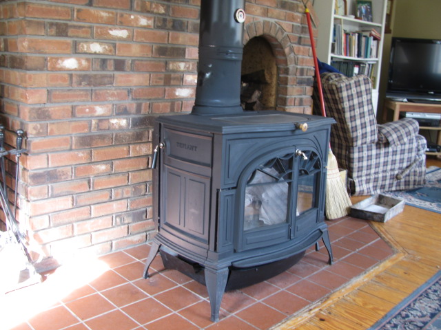

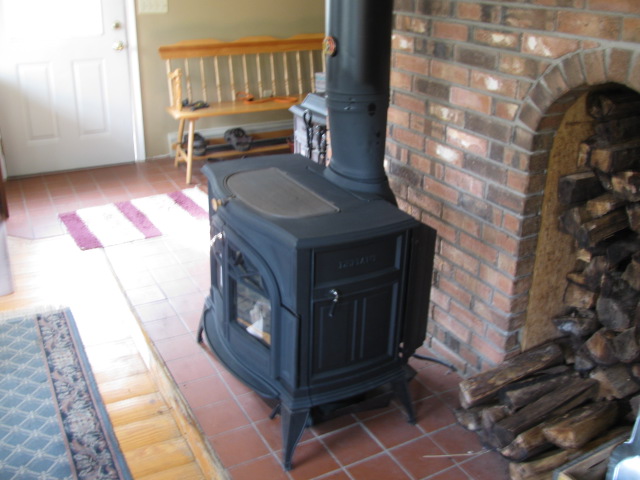

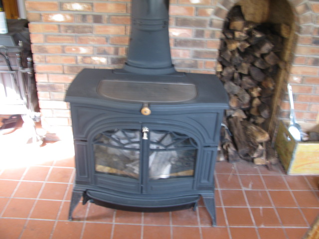

We have an early 1800's house - 1900 sq ft two story. Majority of it is insulated. I go through about 3/4 tank of oil(150 gallons +/-) a year - for domestic hot water and baseboard. We burn 4-6 cords depending on the wood. This year I mostly burnt pine so I think we are closer to 6 cords. I burn oak, ash, apple, maple, pine, spruce - what ever I can get my hands on. It all burns, it just depends on how many trips you want to make to the stove. We have only turned on the furnace/hot water baseboard maybe 6 times this winter - when it got really cold and a few house hold members complained. The stove is in the cavity of the fireplace/bake oven. We use fans to circulate heat around the house plus it flows naturally up the stairwell to the 2nd floor. Most years it averages around 4 cord of hardwood.

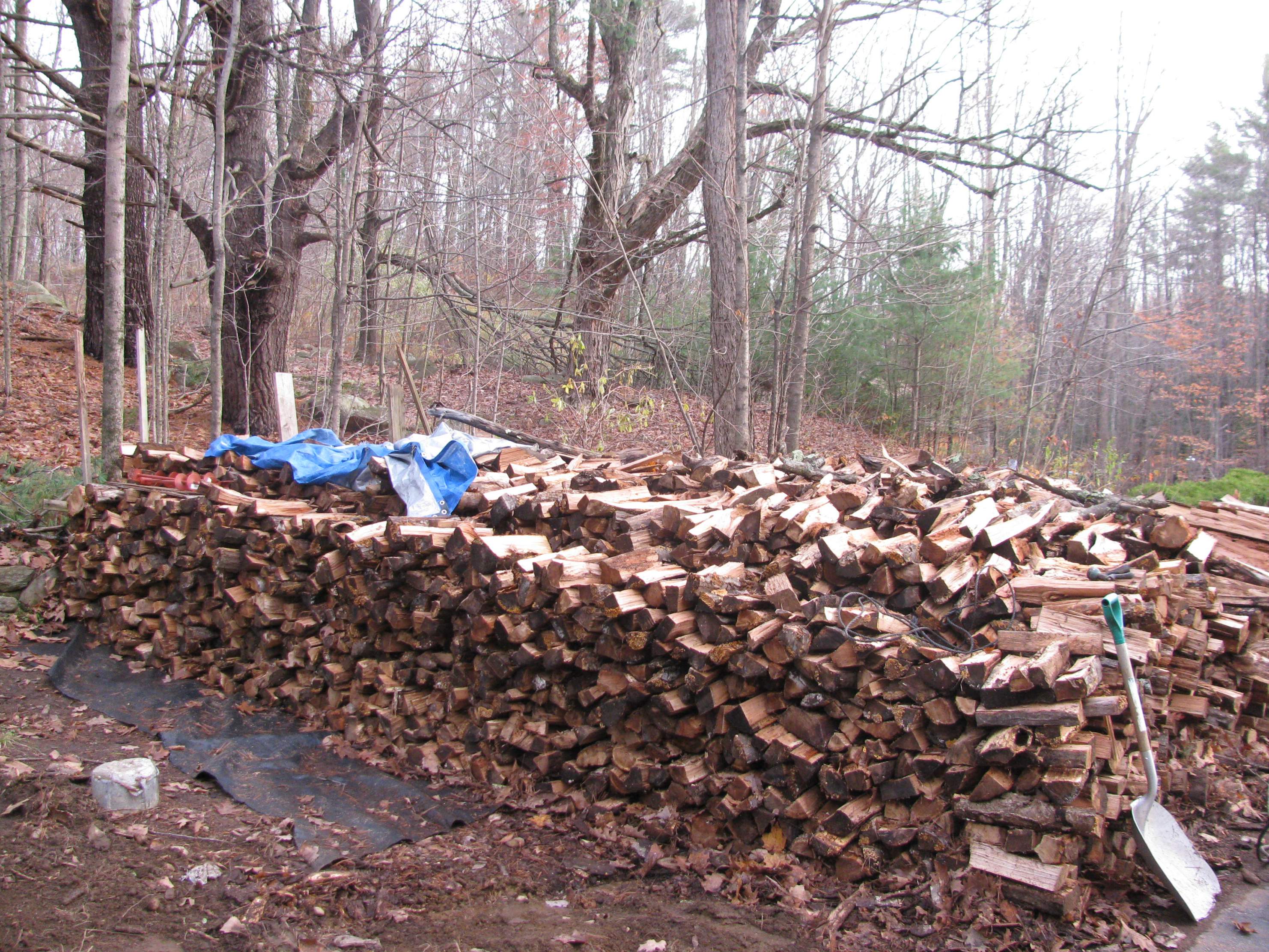

Nice holz hausen Moss.
We just moved over to the newly constructed part of the house (1900ish sq') and heated this winter with a Valcourt FP10 zero clearance fireplace. 7200 degree F heating days per year. It was placed in the main room along with a ceiling fan, which blows up in winter. I've found the direction of the fan to be essential for comfort. The house being a work progress meant we had some serious heat loss from missing doors to the old part of the house. Even now the basement/crawlspace does not have a proper door.
We will burn over four cord this year to the best of my reckoning. Most of that I burned before Christmas when we were still living on the old side of the house and were desperate for heat. We're out of seasoned hardwood now and I'm burning yellow birch. Even with birch, we're letting the fire die out in the evening.
Next winter will be the real test. I have capacity to store about 10 cord and I buy a truck load of logs at a time. The load splits into about 7 cord. So if I burn under 4 cord per year I should be able to keep a rolling stock of seasoned hardwood on hand, considering the suplemental wood I pick up every year.

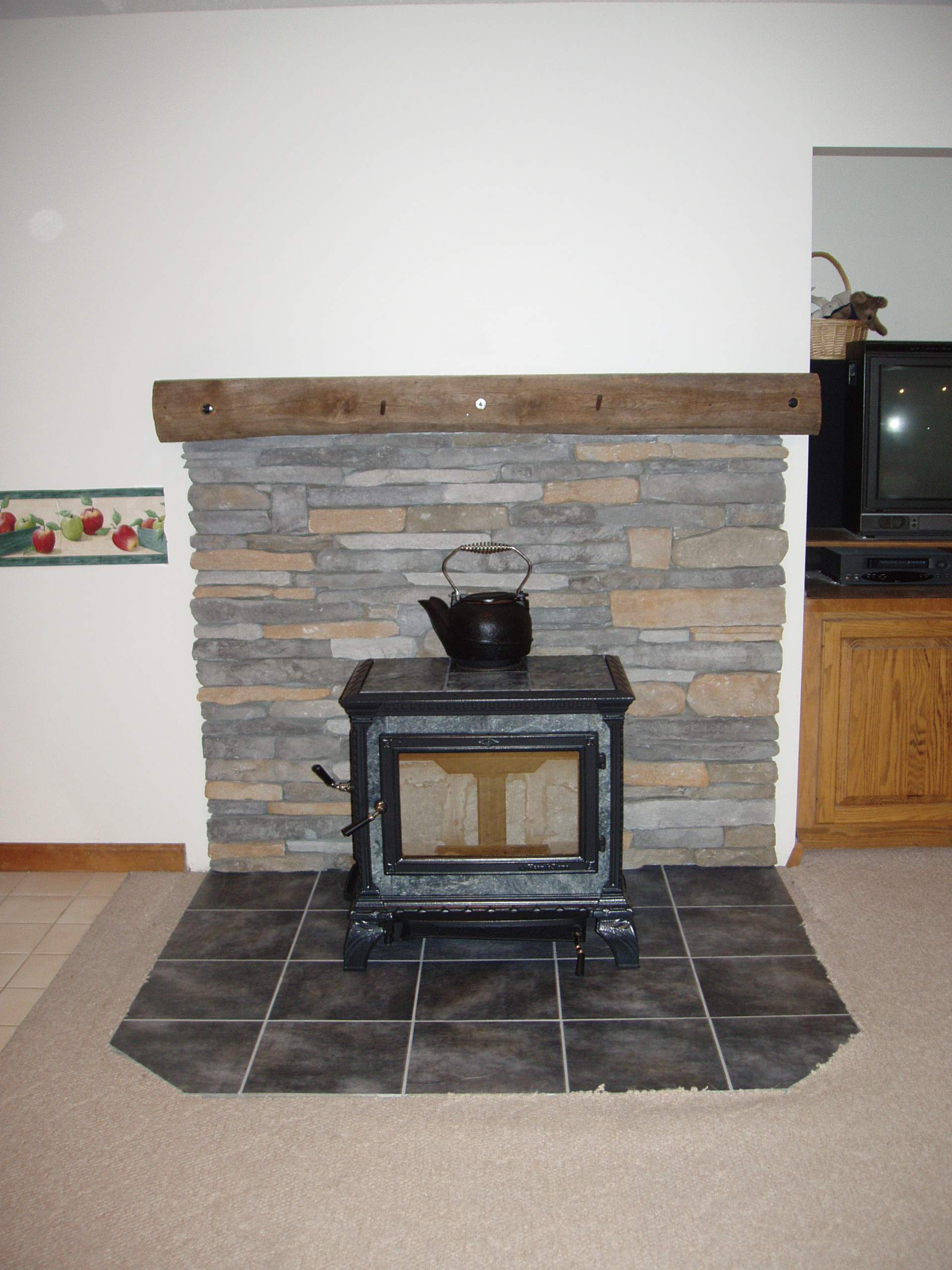

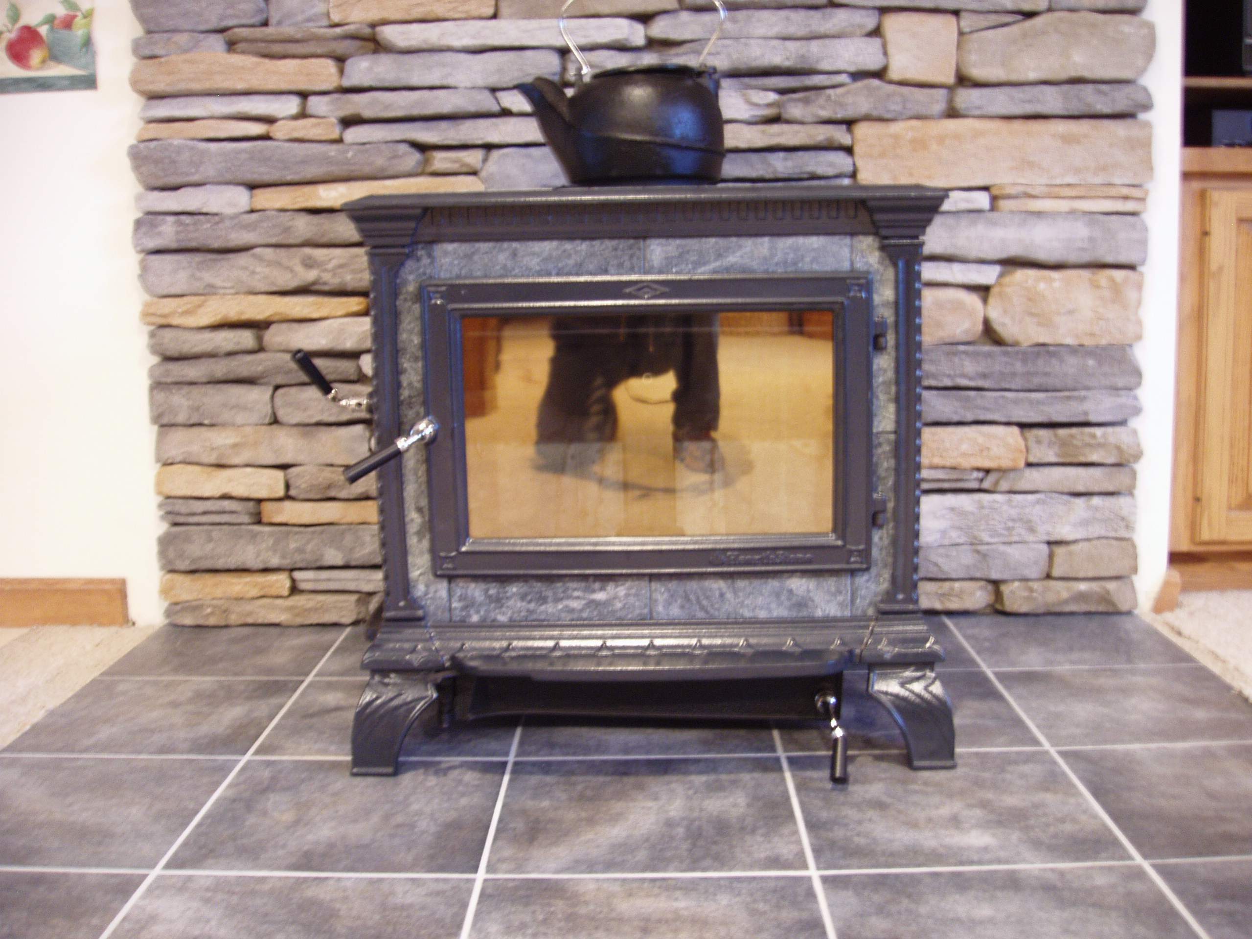

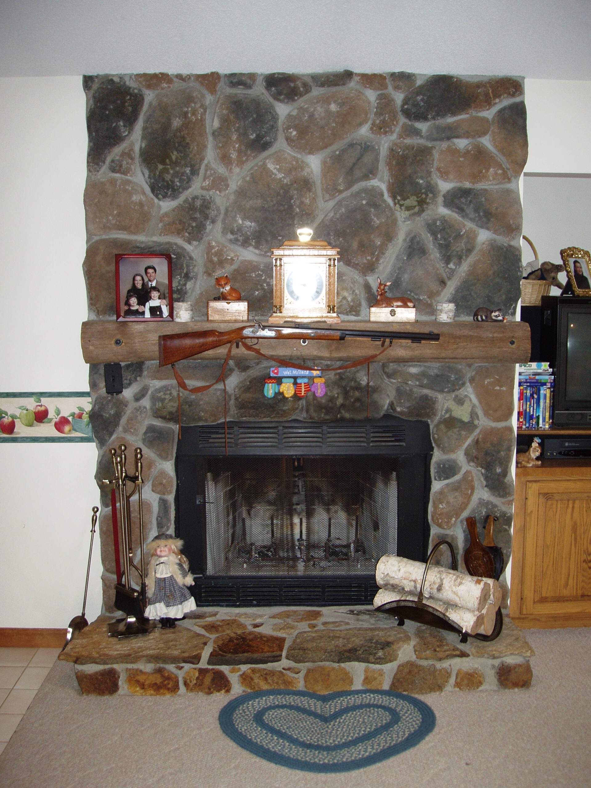

Great idea for a thread. We have a well-insulated early 1990's ranch with an open floor plan that is just over 2000 sq. ft. Our primary heat source is a soapstone wood stove by Hearthstone. It is located in the main part of the house (living room, dining roon, kitchen). The vaulted ceiling has two ceiling fans. It keeps that part of the house anywhere from 68 to 76 degrees depending on the outside temp. The bedrooms are generally 6 degrees cooler which is good for sleeping. We find that when we use the ceiling fans, it increases the temp by about 5 degrees or so. I pulled out the zero clearance fire place (junk) that was installed when the house was built and I installed the woodstove about 8 years ago and have never looked back. I cut, split, and stack wood form the property or from friends who need a tree or two taken down. We burn mostly oak, maple, ash, and some elm.....approx 3-4 cords per season. Our winters in northeastern CT are similar to yours in RI, so it should be a decent comparison. When it gets really cold outside (single digits) we turn the oil furnace on at night to kick in if the house temp drops to 62, but that is fairly rare. Here are a few pics of the woodstove, and what it looked like before.

View attachment 307493View attachment 307486View attachment 307487
Deerslayer that is a beautiful stove. I recall when they used to make TV's look as nice (with wood not soapstone)
