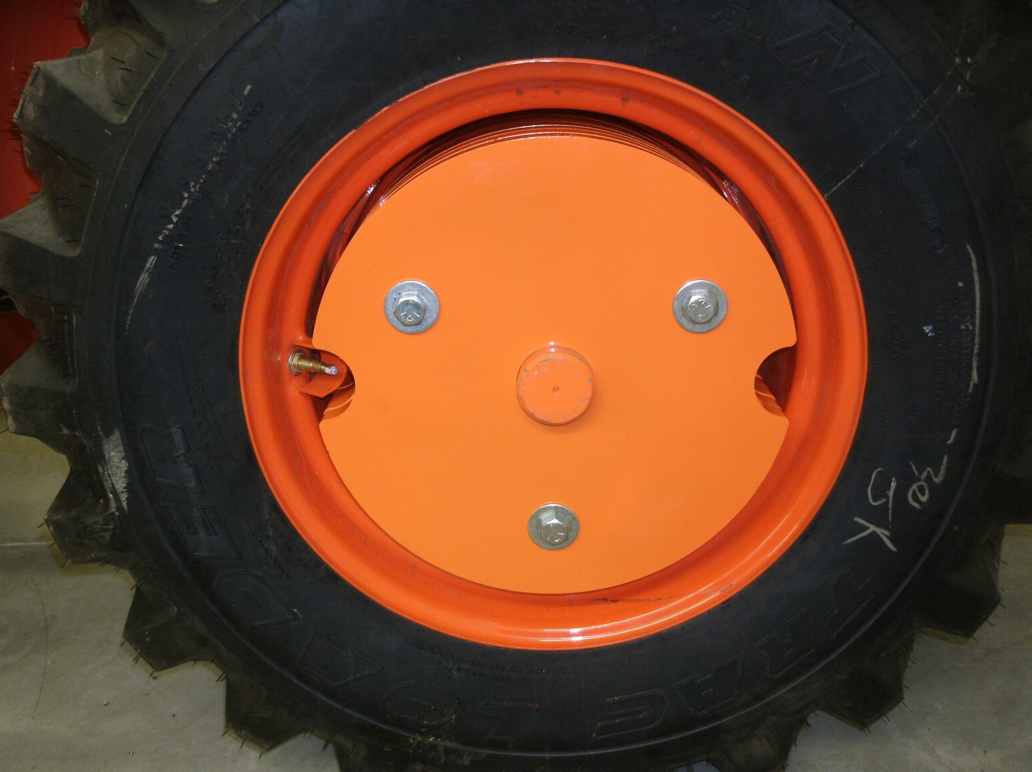

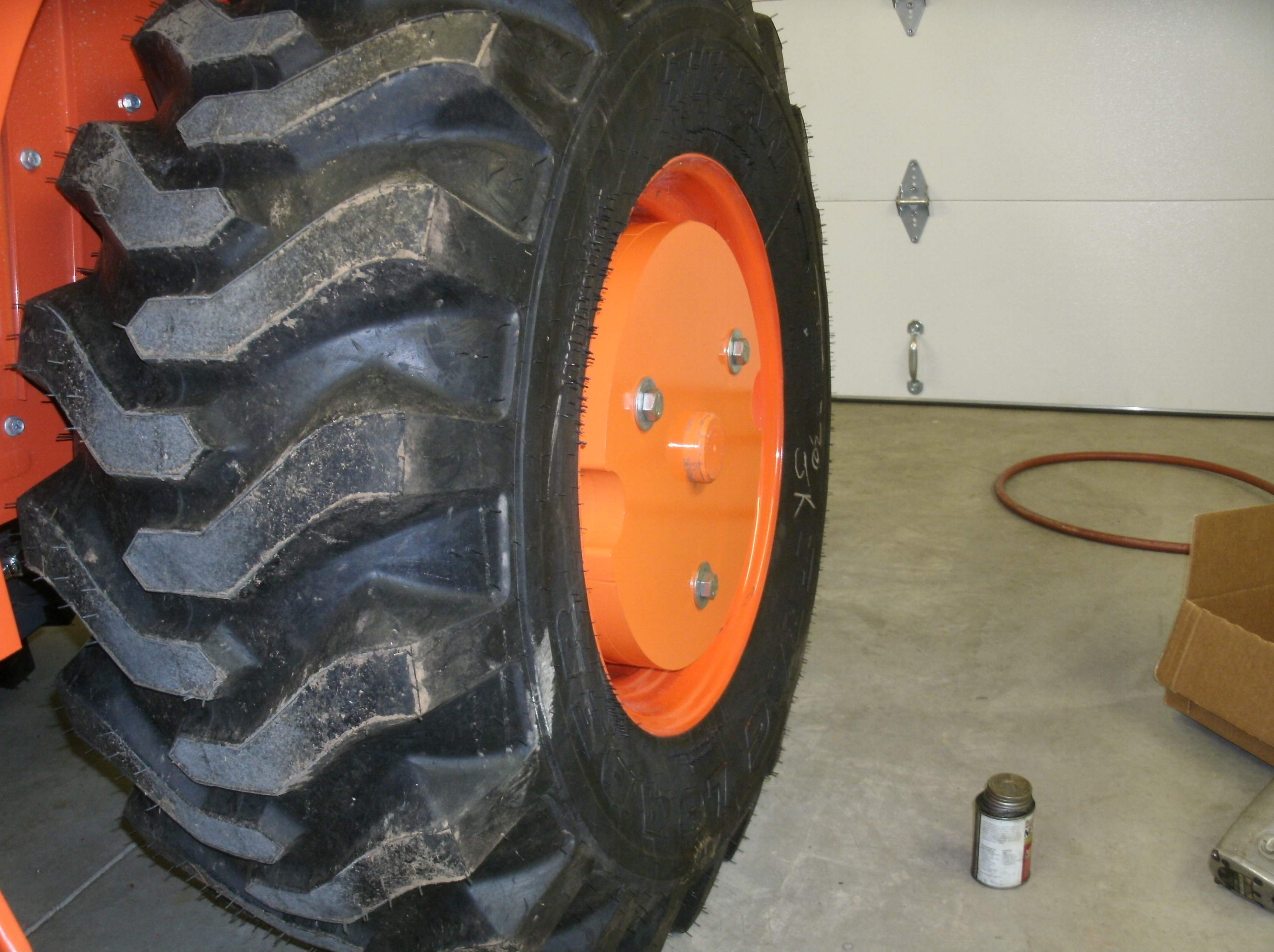

I filled the inside of my wheels with weights that I made up myself. About 500 lbs per wheel plus I had the tires filled. Makes loader and grapple work MUCH smoother. The reason I went with the wheel weights is because I have to get into some tight spots when I'm doing grapple work. Hope this gives you a baseline.

Do you have the LA824 loader? My L3240 rear R4 tires hold 900 pounds of fluid. I would want 3 times of your guess for ballast .
