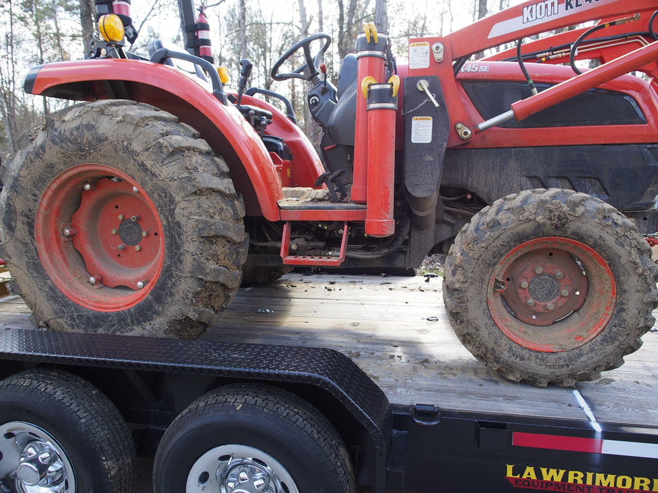

Similar circumstance here with my Kioti, bucket and various 3PH implements. My 20' 10.4k is as small as I want (wish I had a 12k) and allows me a smidgen of room to adjust load balancing. My trailer weighs ~ 3200 empty (I carry a lot of stuff in the front trailer boxes) and has ~ 450# - 500# measured tongue weight empty of tractor. I setup my Blue Ox trailer hitch with a measured 15% on the tongue, adjusting the tractor position to get to this point. I then spray painted a white line across the trailer, side - side at the tractor front and rear axles center lines for this balance point. I adjust tractor position depending upon implements mounted.

I would go with a longer trailer so you have some options in placing the tractor on the trailer for weight distribution purposes. With a 16' trailer, your options will be severely limited. A 18' or 20' trailer will give you more leeway on where you position the weight for a better ride and more stable towing.

Get the 20 ft. I have a 16 foot and don't have a loader and I always wish I had at least an 18ft trailer. I carry the tractor and usually something else up front, like an ATV and or a mower and the tractor or tractor BH and an ATV. The BH hangs off the trailer like 3 foot in the latter situation
