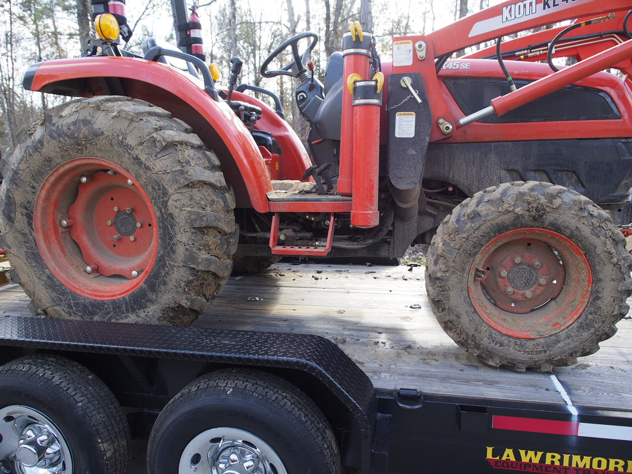

Similar circumstance here with my Kioti, bucket and various 3PH implements. My 20' 10.4k is as small as I want (wish I had a 12k) and allows me a smidgen of room to adjust load balancing. My trailer weighs ~ 3200 empty (I carry a lot of stuff in the front trailer boxes) and has ~ 450# - 500# measured tongue weight empty of tractor. I setup my Blue Ox trailer hitch with a measured 15% on the tongue, adjusting the tractor position to get to this point. I then spray painted a white line across the trailer, side - side at the tractor front and rear axles center lines for this balance point. I adjust tractor position depending upon implements mounted.
