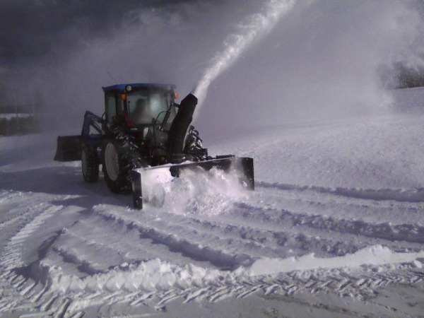

I have beet juice in the rear tires for ballast and I have an 87" 3 point blower that goes around 1200 lbs. I am mostly concerned about being able to steer the blade. The tractor is 4wd and I haven't considered chains for the rear because there is little clearance between the tires and the fenders. I am going to set up the skid steer plate with a short boom that suspends the blade with a chain, like it was on the truck, it will then float.
That is probably the best way to because you don't have the weight of the loader pressing down on the blade. It will help keep it from cutting in on a gravel road. Also with it suspended by a chain it keeps the weight of the loader on the front of the tractor and will make it easier to steer.

I really appreciate all the replies and advice. I am hoping to get it mounted up this coming weekend, will try it out and post a few pictures with comments. My blower is an 87" Meteor, seems pretty heavy duty.

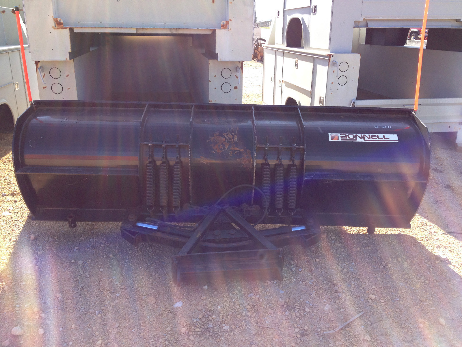

Could you make a sub frame to mount the plow to? I have an International dump truck with a 10' plow. A few years back I caught the edge of the plow on something frozen to the ground as I was trying to push the banks back a bit. I was doing at least 10 mph trying to get the snow to roll off the blade and carry some speed into the woods. The truck stopped dead and bent one of the angle cylinders (which are large) and the frame on the plow. The trip springs did nothing to prevent the damage. Plowing at speed means you have lots of momentum and something has to give. The loader arms seam like the weak link to me.
/ How much horse power? #27
I have used both frame mount and FEL mounted plows. Both have their advantages and disadvantages, but you will not bent, break, tweak, or harm in any way, your loader arms pushing snow. This is an old wifes tale. You could, maybe.... if you run full steam in to a tree, but that's not pushing snow.
