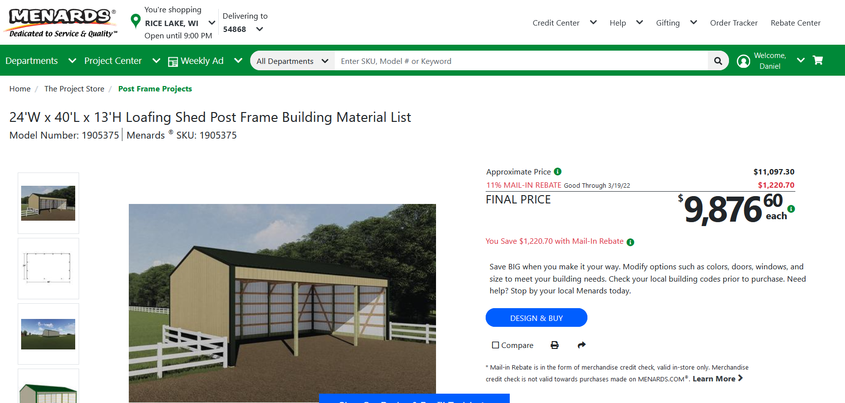

Here is current materials only from Menards for a 24x40 with 3 enclosed sides
Good post for educational purposes. I was going to suggest Menard's as well. Great online build it yourself planner. Great for seeing the different options and an excellent guide for materials required and their cost.

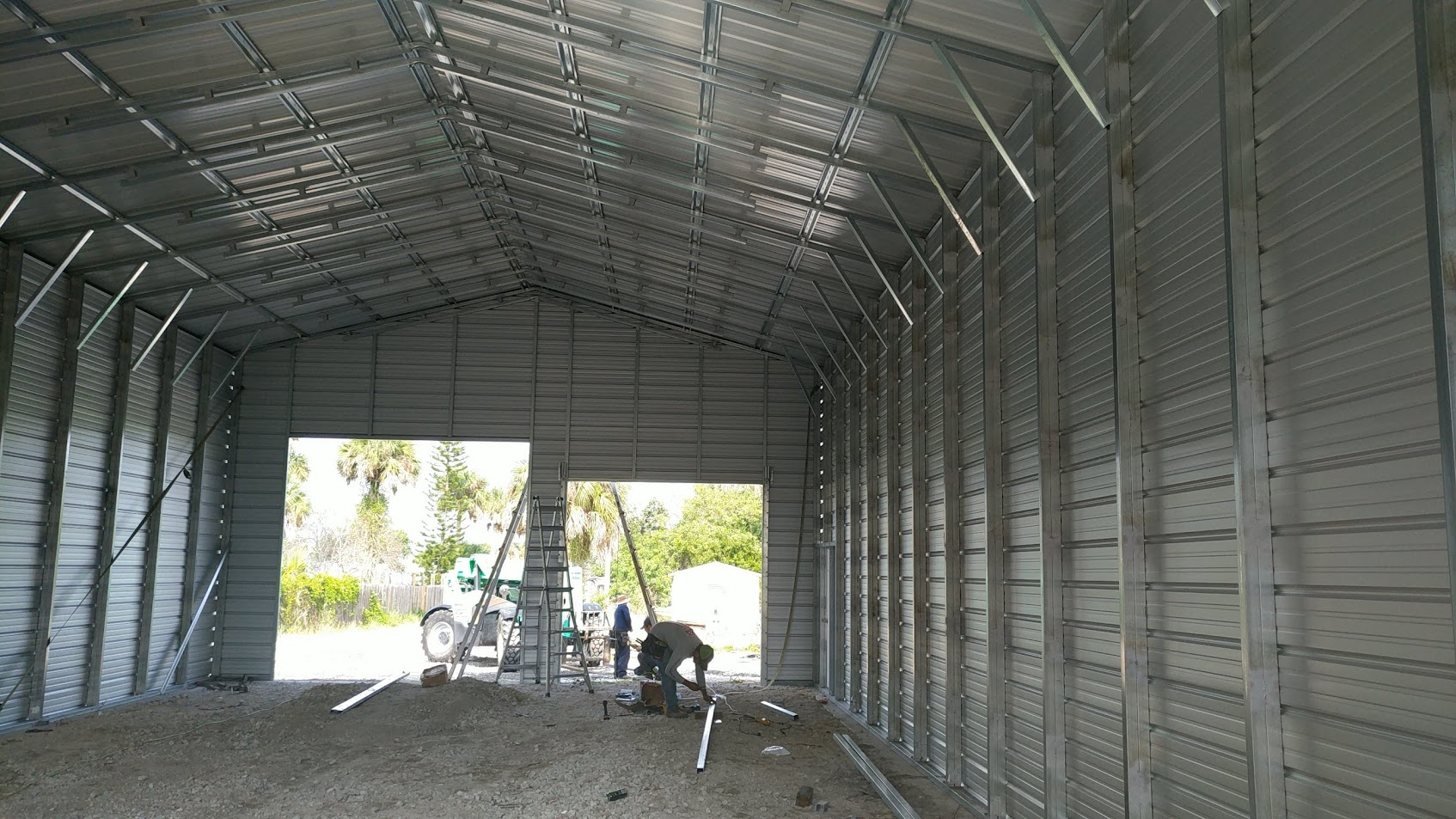

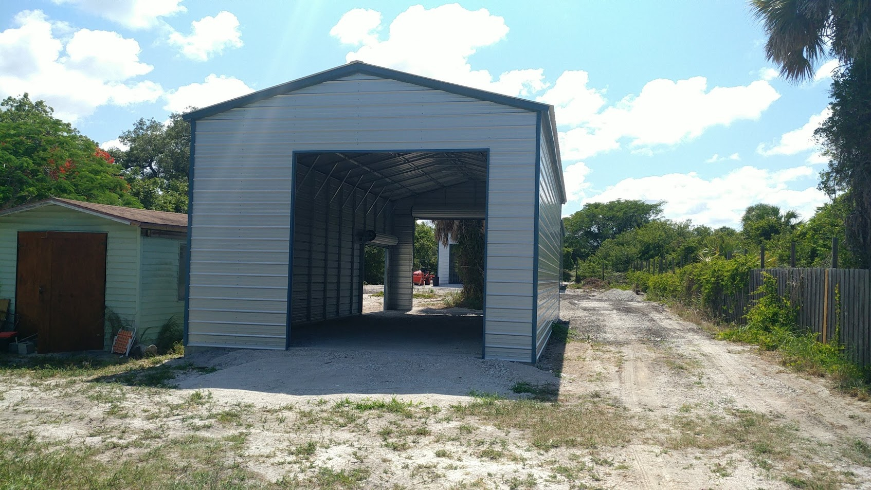

Another thought. I did much of the site work, but used CCI buildings- Fort Pierce (CARPORTSANYWHERE, INC. P.O. Box 776 Starke FL 32091) to build two tall buildings for me, one 22x48 and the other 30x60. One building has 14 foot entrances and doors, the other has 12 foot entrances and doors. The buildings installed were about $48,000 together. I used concrete footers and gravel floor. With the footers the total price for the two buildings was about $64,000 in 2019.
The buildings are hurricane rated. I have been very happy with them.
