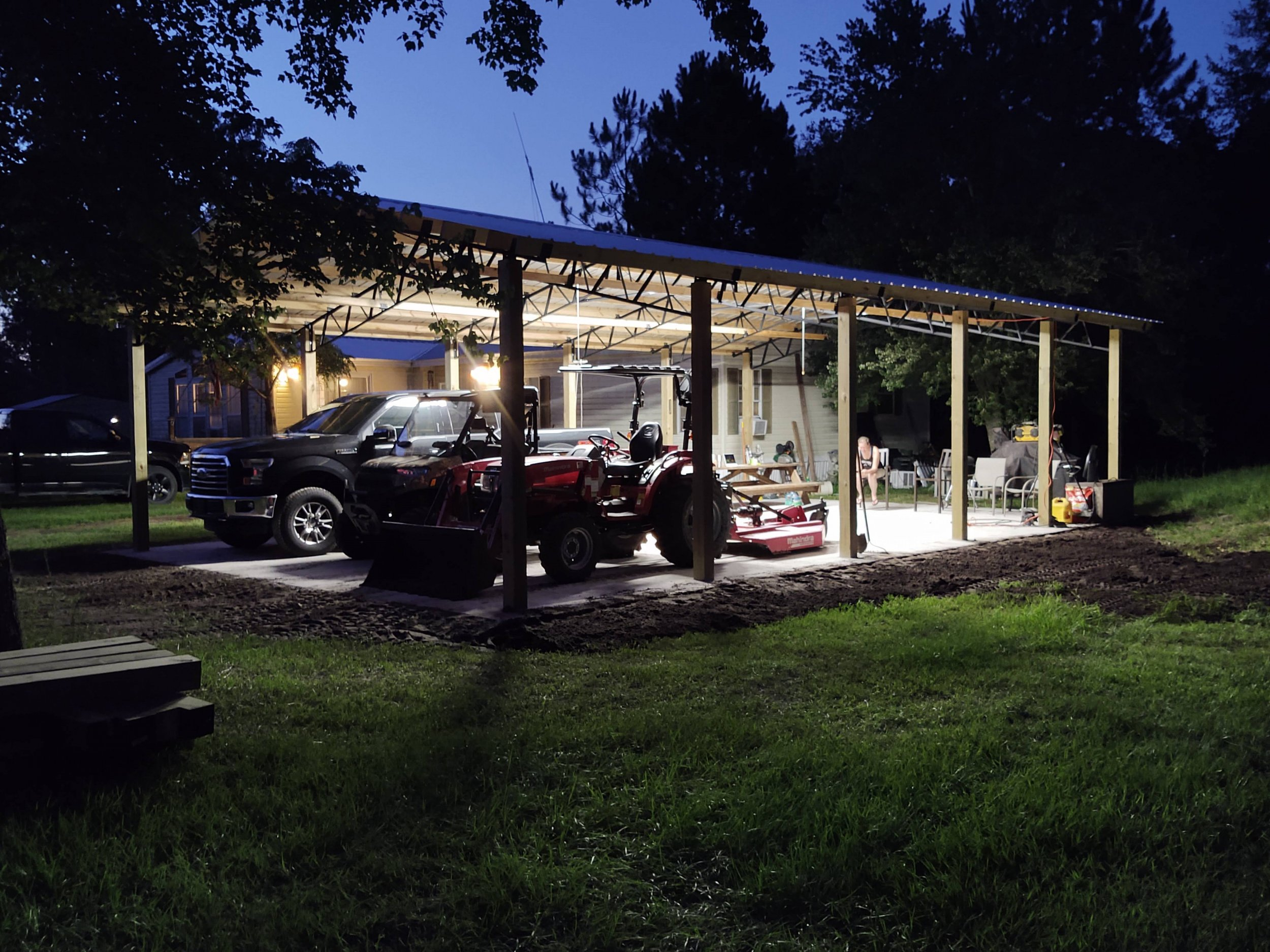

In SW Florida, got free used telephone poles from power company (you need a way to transport them). Bought unused lumber trusses on Craigslist. Reused metal roofing from old barn. Doubled the size with more free telephone poles. Used 32 Ft metal trusses from barn tear down on Craigslist for the add on . Roofed it with metal at retail prices. Rent a skidsteer with auger for the holes, makes quick work. Used military wrecker (for which I built polebarn) to lift metal trusses.
Build bigger than you think. You’ll fill it up. Outside city limits so no permit

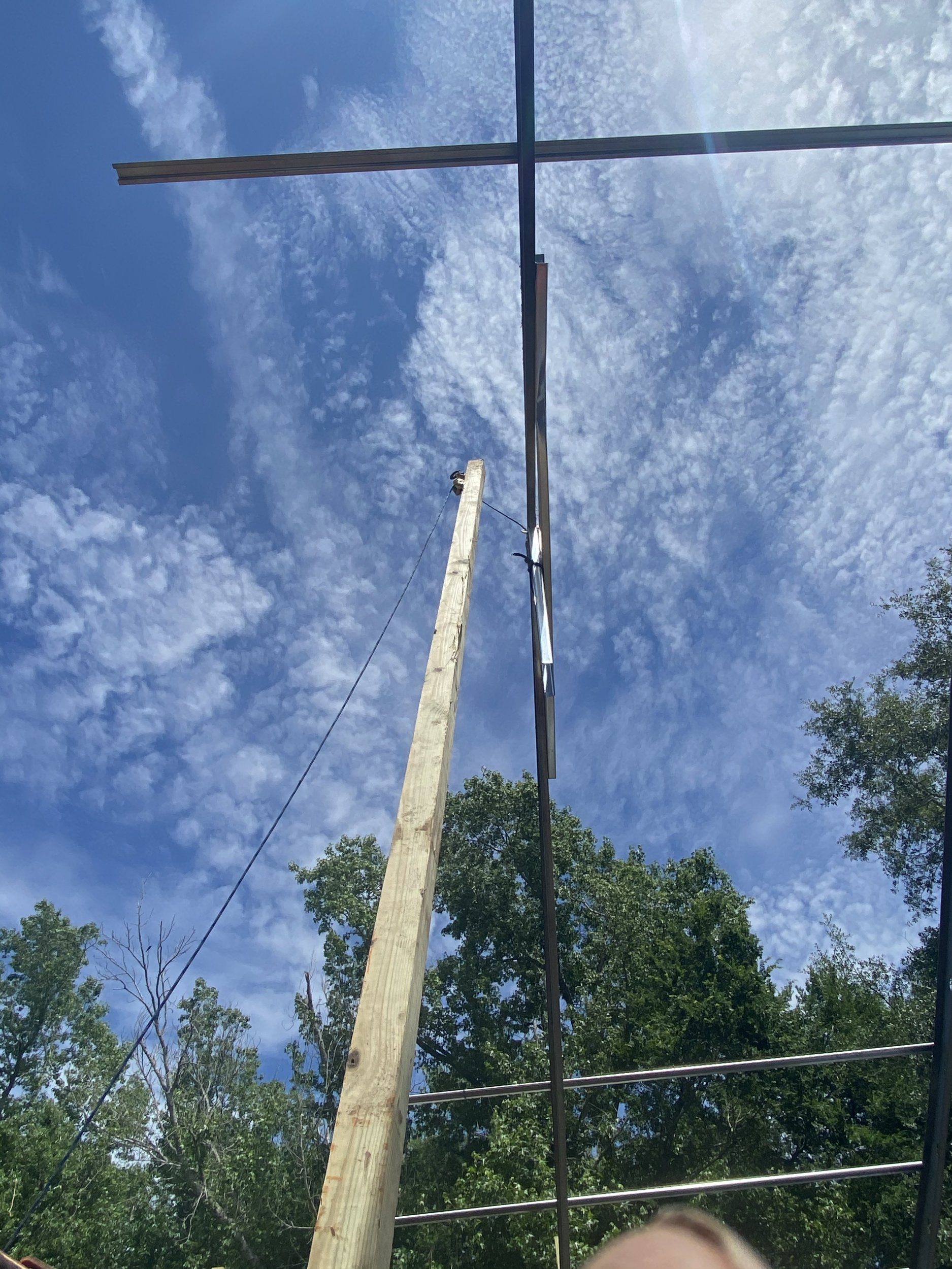

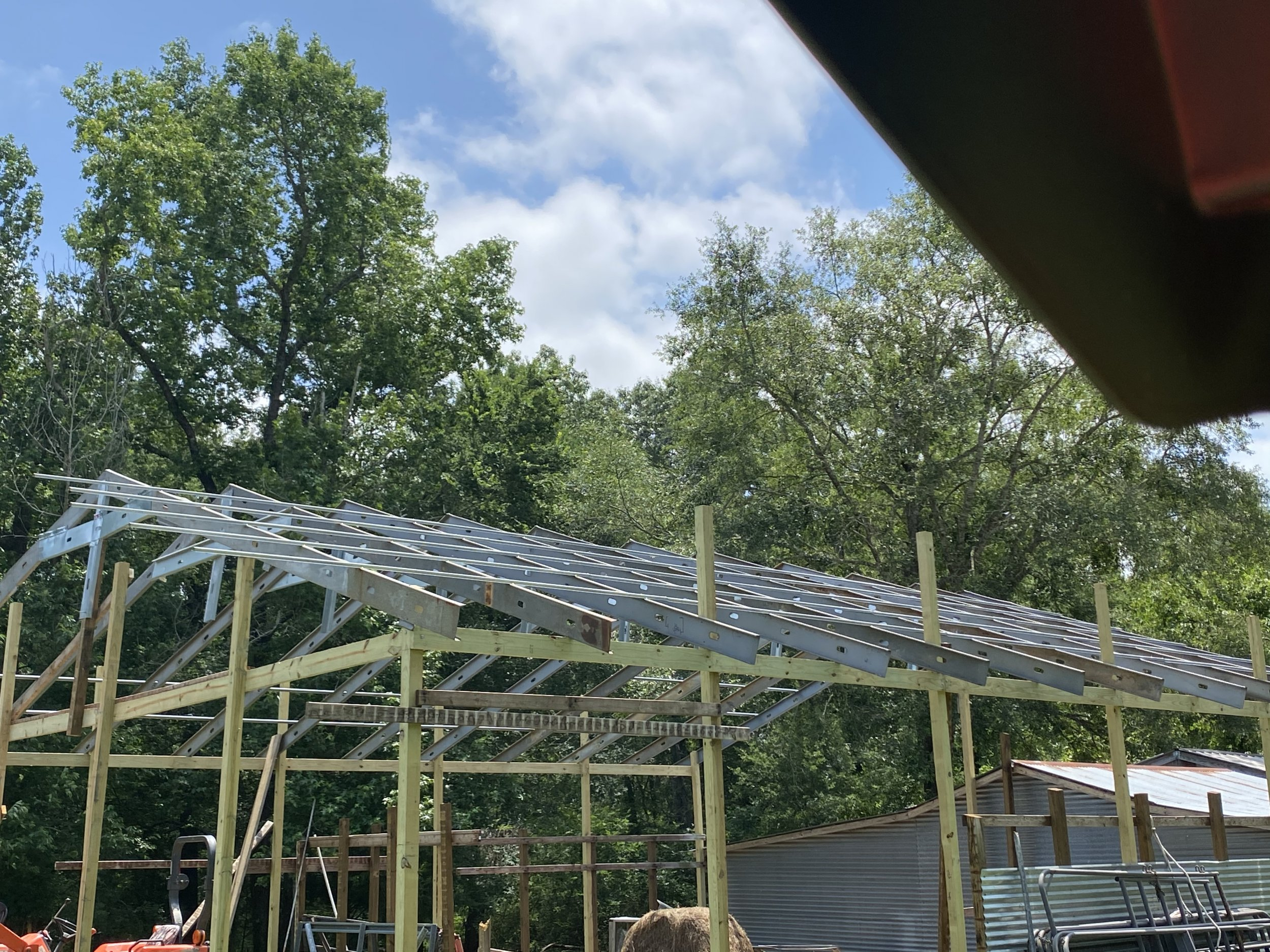

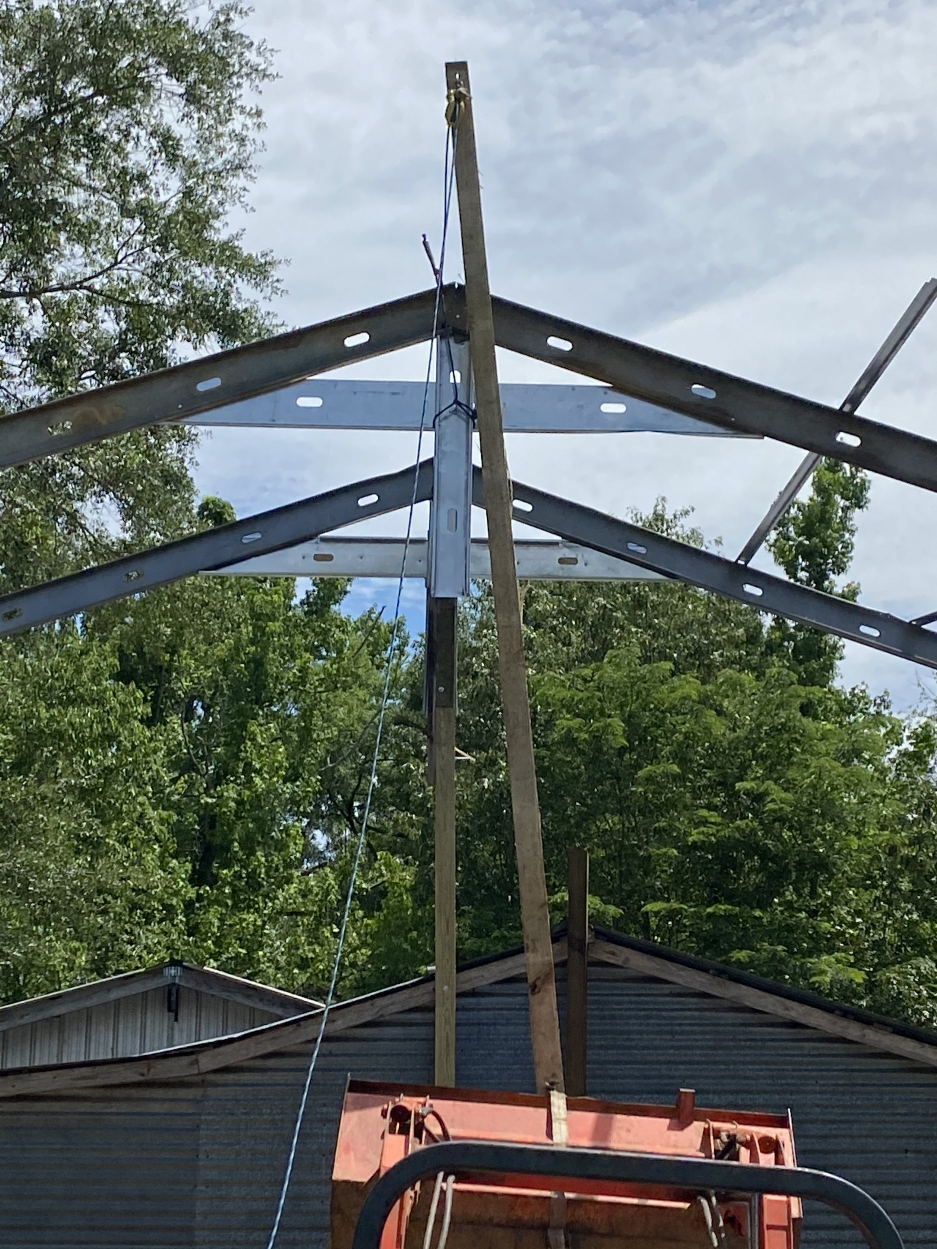

Last year I built a 36x40. It cost me about $3000. i used 8” 16 ga. metal studs and built my own trusses. The low outside walls are 16’ tall. I notched a 4x4 post 16’ long and bolted to my tractor bucket. On the high end of the post I put a pulley and used the winch on my side by side to winch them up. I bought dwc channel to lath the trusses together and the. Screwed my roof to this channel(channel used to be called hat channel). I bought R panel for the roof. I had a bunch of barn tin and put that on the walls. I did this entire build by myself, it took me a month total but I did it with a torn rotator cuff and I was 63 years old.
OK, that looks doable.
