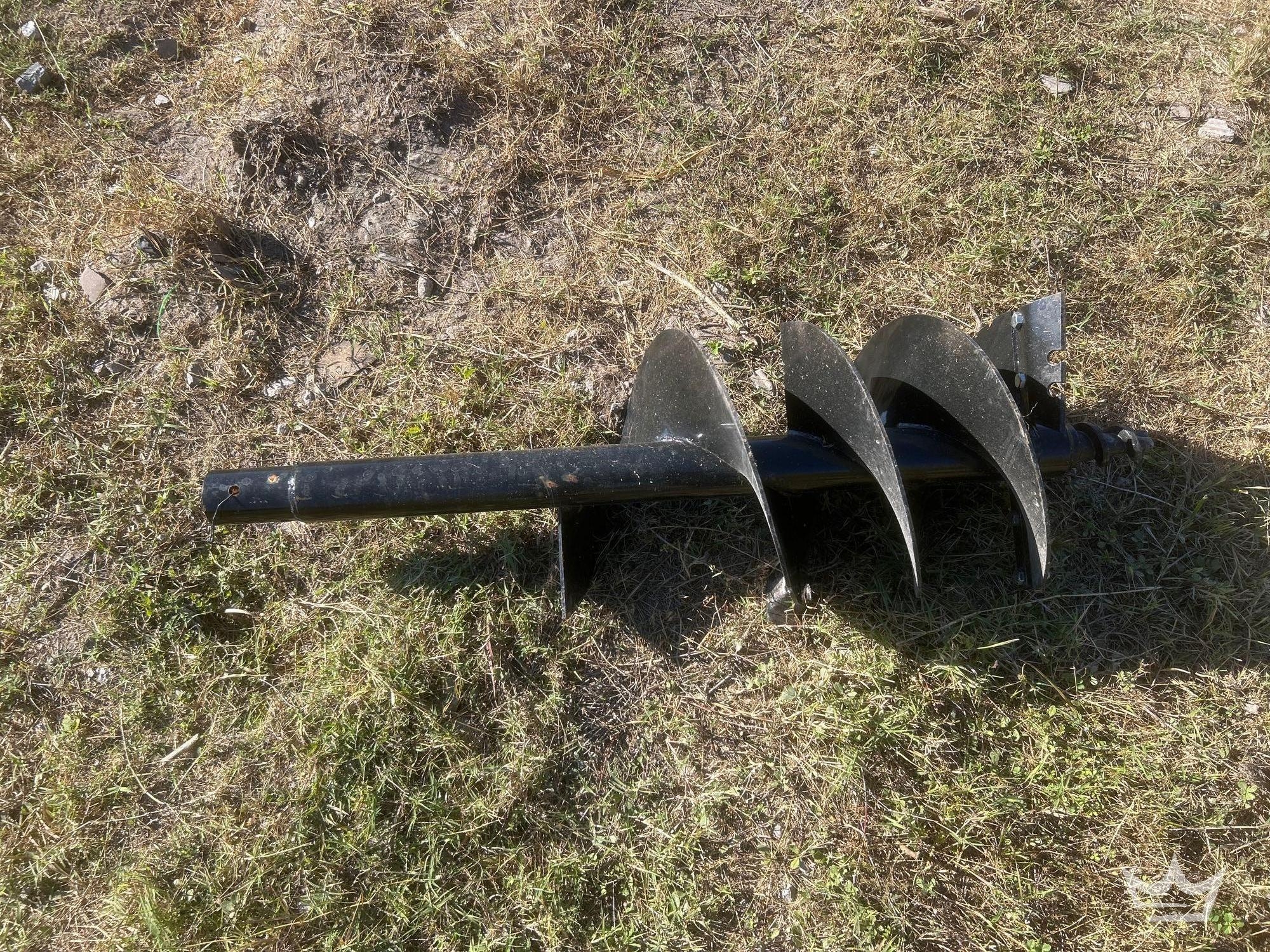

-digging fence posts for said rink garden
-planting trees
~~You can rent an earth auger or have your kids, or neighbor kids, get some experience with a manual Post Hole Digger. Sixty holes?
~~For trees, you can soften the ground with a Three Point Hitch mounted Subsoiler, then shovel out the spoil with a spade.

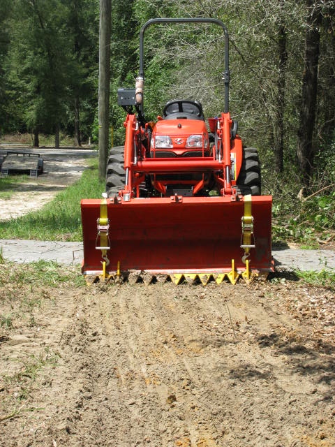

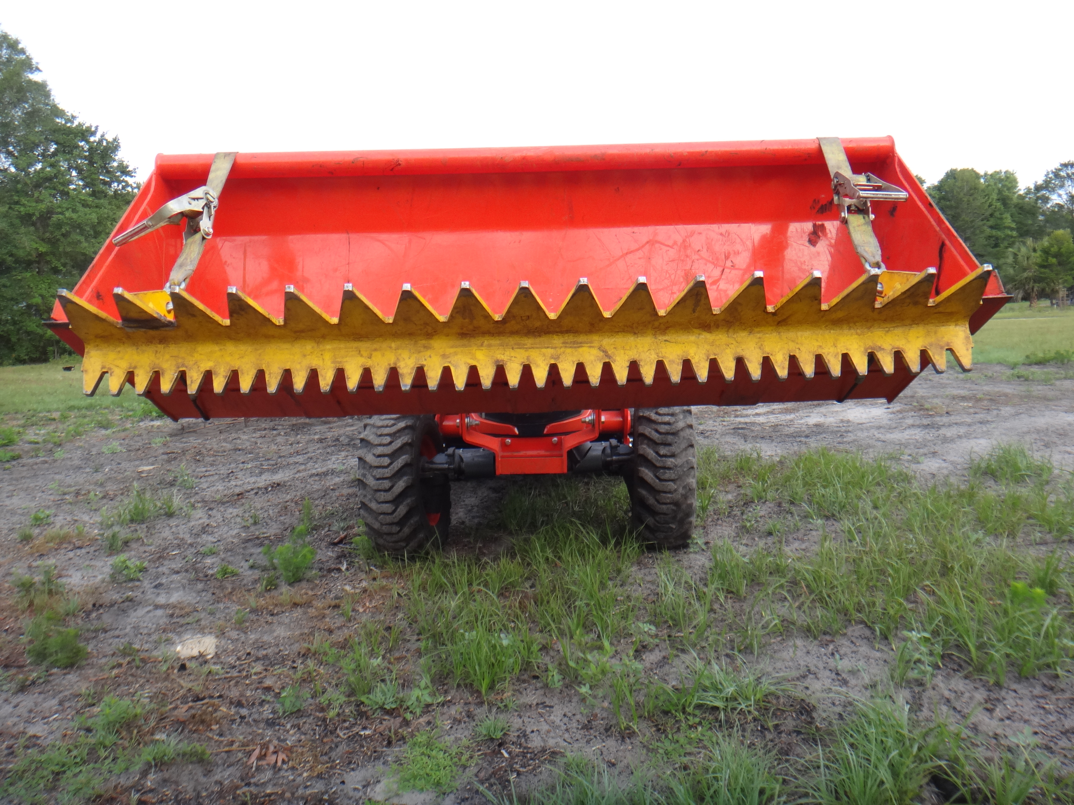

Ratchet Rake is sold by the TBN store, button at top of this page, among other venders. Delivery by FedEx.

On small tractors, like the L2501, the down oriented teeth on a Ratchet Rake will do everything a Box Blade will do but more slowly.
When you buy a Box Blade you are buying steel to make the Box Blade heavy.
You attach a Ratchet Rake to the FEL bucket, so all the weight of the bucket, about 250 pounds, is utilized.
You can store a Ratchet Rake in the corner of the garage. Box Blades and other Three Point Hitch implements take up quite a bit of room.
Start with a Ratchet Rake.

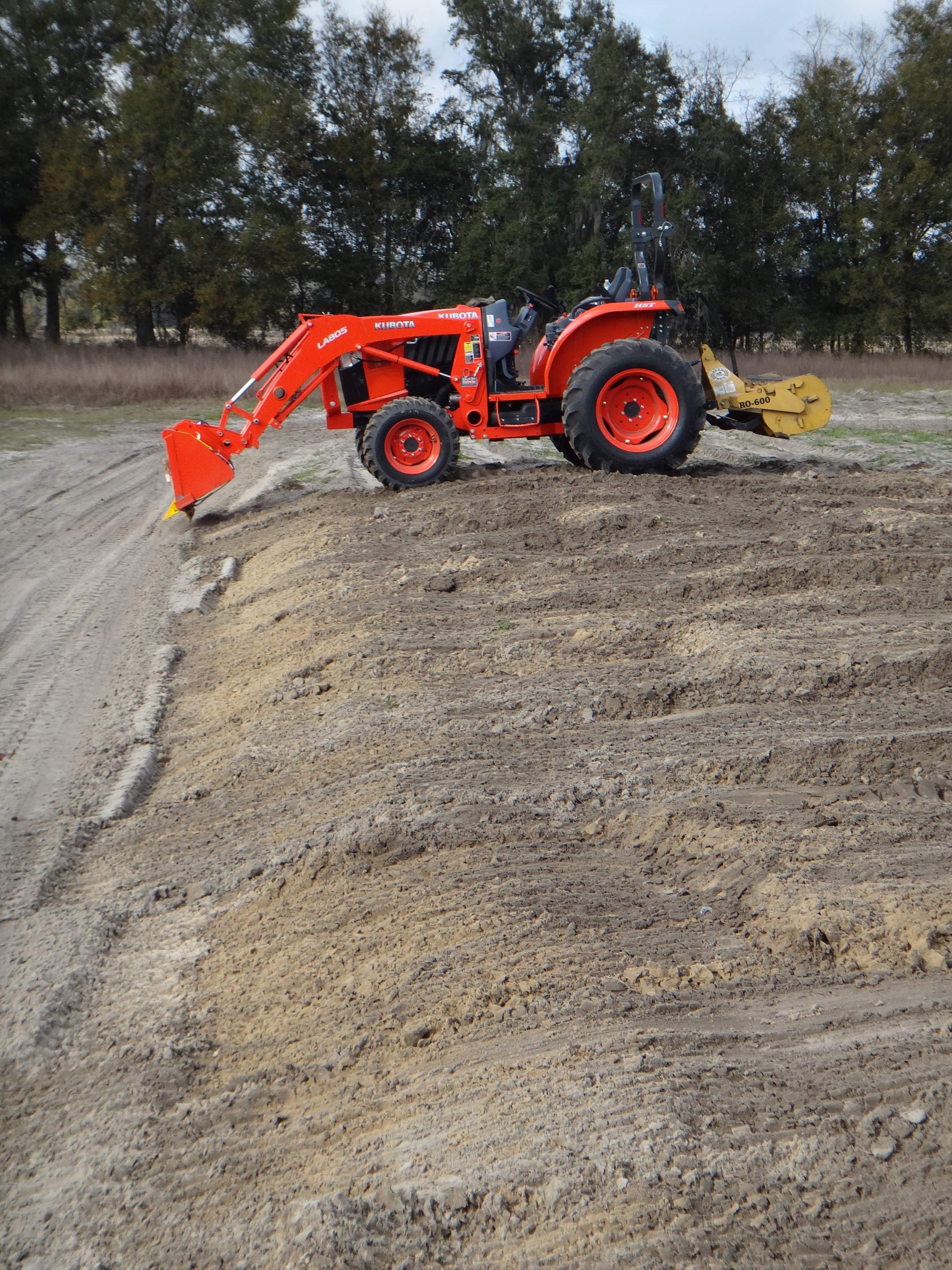

June 9, 2016:
I own both a Ratchet Rake and a Rollover Box Blade.
I have been contemplating Ratchet Rake versus light Box Blade of late.
I like the Ratchet Rake, which I recommend based on 600 hours experience.
This post concerns Ratchet Rakes Vs. light Box Blades, such as the 60" Land Pride BB1260/346 pounds/69 pounds per foot.
I searched for the weight of kubota L3301 bucket but could not find a number. I presume L3301 bucket weighs approximately 240 pounds, extrapolating from other kubota specs. 68" Ratchet Rake weighs 88 pounds. Adding 240 + 88 = 328 pounds, pretty close to 346 pounds of BB1260 Box Blade.
In addition, the (operator controlled) weight of the FEL frame bears on the Ratchet Rake. Likewise, weight of the Three Point Hitch bears on the Box Blade. FEL frames weigh much more than ( 3X? 4X?) Three Point Hitch components. So, including some FEL weight, I guesstimate that ground contact pressure on Ratchet Rake and BB1260 would be at least equal, perhaps greater pressure on the Ratchet Rake.
Further in Ratchet Rake's favor you have articulation of bucket/RR combination in two planes from the operator's station and 1-1/2" serrated teeth on the Ratchet Rake.
Box Blade can be raised and lowered hydraulically from the operator's station. Box Blade angle of attack is adjustable via the Three Point Hitch Top Link, but not from the operator's station. Standard Box Blade does not have rippers, standard is a smooth cutting edge.
Ratchet Rake is capable of tearing up sod with its serrated teeth, the initial operation in much grading. The Ratchet Rake will not pull as large a load as a Box Blade but it may pull 40% of capacity of BB1260 per pass, with faster cycles. Ratchet Rake is more intuitive in operation than a Box Blade, which requires considerable experience to operate efficiently.
This is why I feel the Ratchet Rake is superior to light Box Blades for LIGHT grading.
This is a novel assessment of the Ratchet Rake. Subject to revision and modification.
When I have heavy grading to do, I mount my 60"/625 pound (125 pounds per foot) Bush Hog (brand) Rollover Box Blade on the tractor's Three Point Hitch AND the Ratchet Rake on my FEL bucket.
