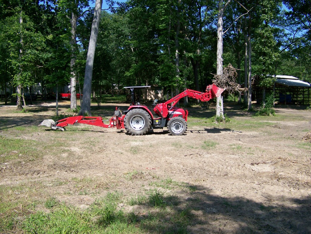

Blu 82,
When you go to unload, if the rear end feels lite, just extend the hoe and it's bucket out low to the ground :) (like I have in the photo below) and that will shift your center of gravity aft, which will give a more solid feel of the rear tires on the ground.:cool:
