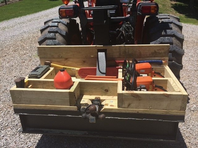

I think we got this figured out but It is not a static problem, as soon as you start trying to lift the load it becomes a dynamic problem. the way I see it is you really should be using the 3pt almost to its full capacity if you are using max capacity on your loader.
I have a multi purpose counterweight with chain hooks and hitch and a log holder for cutting branches but my problem is I built it when I had my b7800 so it probably weighs 800 pounds which was plenty for the b7800 but it is a little light for my L4740.
