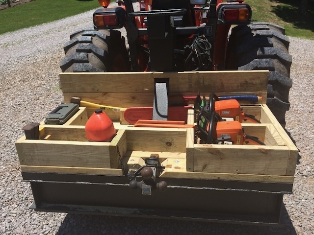

Whatever weight you decide try to also incorporate the ability to carry tools, chains, and other things you might need when 2000' from the barn.
/ How much ballast for an MX6000? #18
All heavy steel and concrete - set it up for carrying saws and towing the log splitter at the same time. (MX5100 in photo)
