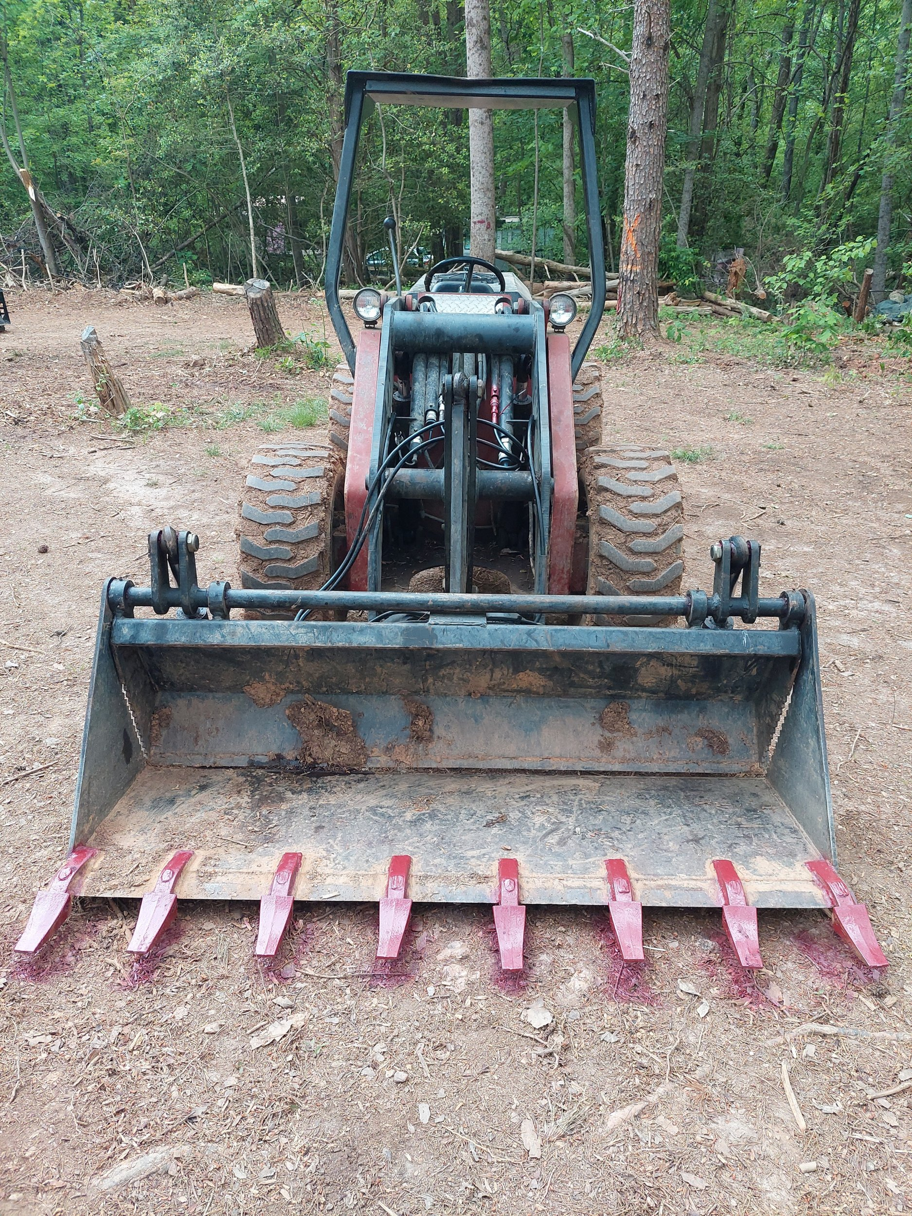

My PT1850 has 7 teeth on the grapple bucket which is the rock bucket that PT added a grapple to.
Ken
   / How many teeth should I add to my 4 in 1 bucket/tooth mount style-Beast Mode #22
I have a full width Rankin tooth bar on my six foot bucket. Eight teeth, evenly spaced across six feet.
   / How many teeth should I add to my 4 in 1 bucket/tooth mount style-Beast Mode #24
YIKES!
(y)
   / How many teeth should I add to my 4 in 1 bucket/tooth mount style-Beast Mode #25
IIIIIIIIIIIIIIIIIIIIIIIIIIIIII LIKE IT!
   / How many teeth should I add to my 4 in 1 bucket/tooth mount style-Beast Mode #26
I'm thinking about modifying my ratchet rake to where it bolts onto my 4 in 1 vs strapping it to my oem bucket.
I'm worried that the force on the FEL would be too much?
   / How many teeth should I add to my 4 in 1 bucket/tooth mount style-Beast Mode #27
Personally, I prefer the Ratchet Rake vs a bolt on one.
Ken
   / How many teeth should I add to my 4 in 1 bucket/tooth mount style-Beast Mode #28
While the beast mode is cool I worry about bending your bucket. Is the lip heavily reinforced?
   / How many teeth should I add to my 4 in 1 bucket/tooth mount style-Beast Mode #29
I'd be concerned about that as well. I had a 3/4 yard bucket on an IH2500B with oversized lift cylinders. I damaged the heck out of the bucket prying on tree roots. Ended up taking it to a welding shop to straighten out the leading edge, re-welding the crack across the rear of the bucket, and adding a 6" piece of 1/2" flat stock across the entire width of the bottom side of the bucket lip for more support. Then a new cutting edge.
It's amazing the power that hydraulics can have to bend plate steel.
#30
No issues so far. The lip on the 4 in 1 bucket is very thick and the pressure from going into the dirt goes to the back section of the dozer portion of the bucket which seems to take it well.
