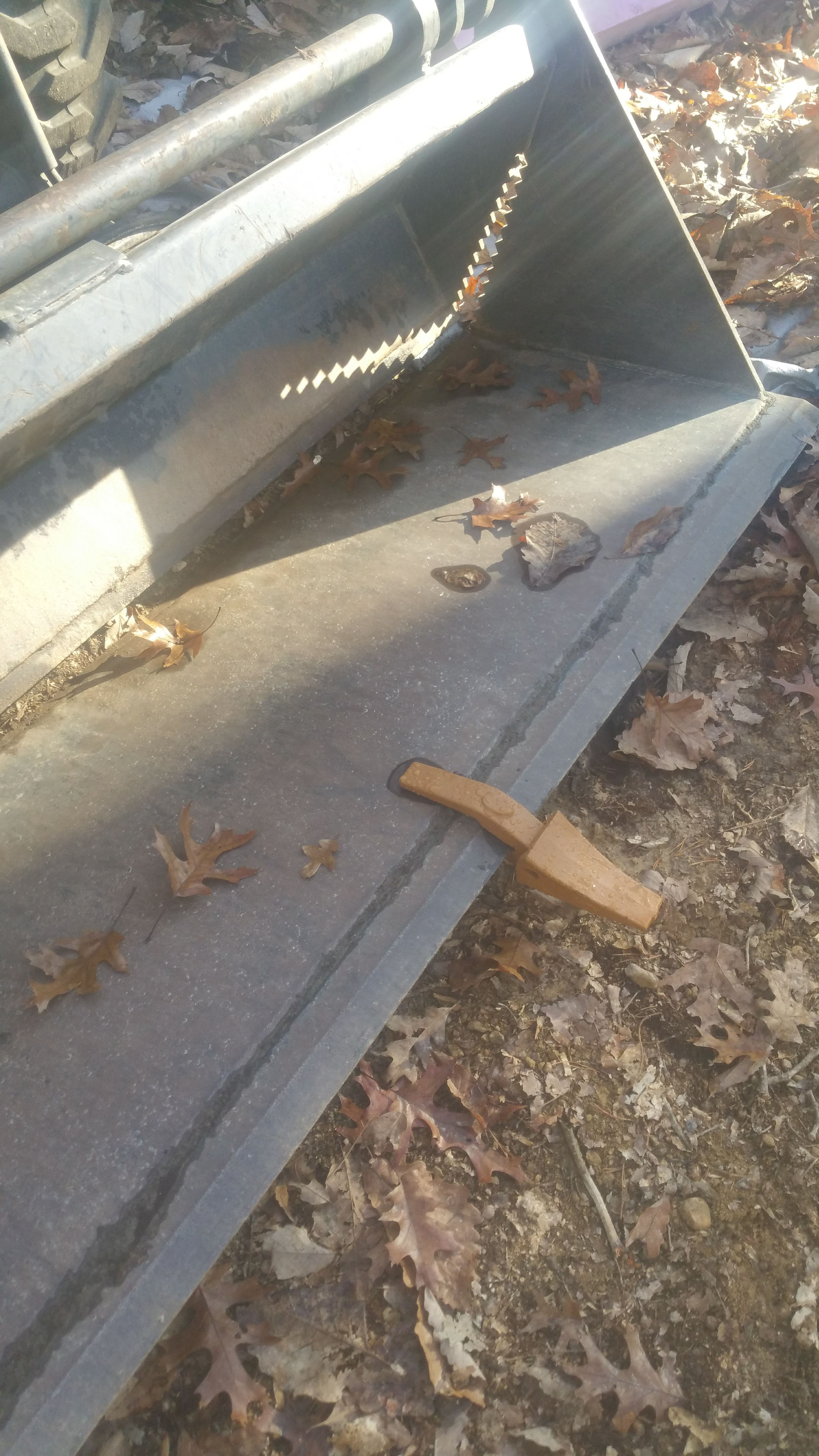

Getting ready to do some excavation and need the teeth welded onto my 4in1 bucket soon.
Now that I look at the teeth/mount that I bought again, the teeth are going to sit lower that the bottom of the bucket due to the style of the tooth mount that clamps over the bucket edge.
Should I care about that or do I need to get weld on mounts that sit up higher so the tooth is more even with the bottom of the bucket?

That doesn't look bad to me from the pic. You may want to snap a side view showing how much lower the tooth is. Most brands are a little lower then the edge.
Some brands like the ones PT (and others) sell are bolt on. So if you dont need them you can remove them. The only problem would be drilling the holes. Not sure how hard the bucket material is to drill through.

I would do an ODD number of teeth regardless of how many you do. That is so there is one in the middle of the bucket. So many times I've picked up an implement with that single tooth and everything is balanced nicely.
My teeth are under the bucket and will leave marks in the dirt (straight lines) that can be flatten with a back drag of the heel of the bucket. The teeth are much strong when it hooks under the lip.

My teeth bolt on and off and are welded to a long bar. And I would really recommend that method as opposed to welding directly to the bucket. My toothbar is a tooth bar, and it bolts to the side of the bucket, not the bottom. The bar adds a lot of support. I fear that the stock buckets front lip is too thin for permanent teeth and you are going to bend the bucket in short order.
