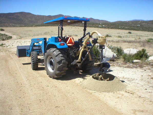

I am a weekend warrior. Only get to work (PLAY) on the weekends at the ranch. I had many holes that were next to impossible to just drill with my Land Pride PD35 ( the largest pto phd that they have). I would have to drill and water and drill and water, I do not have the time to do this when I need a hole drilled. I bought the down pressure kit for my phd and have had ZERO problems drilling any holes since. :thumbsup:
