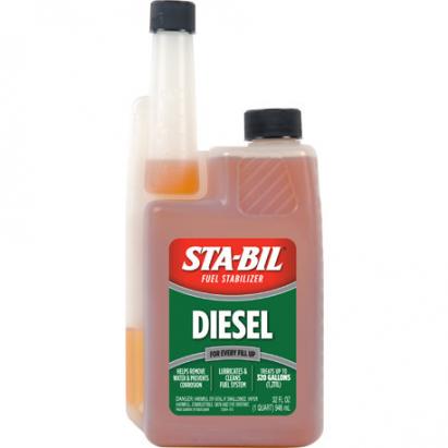

In addition to anti-gel and biocide -
Yep Sta-Bil for diesel and you will get over 10 years IMO.
I personally have run 1000 gallons of 12 year old untreated diesel with no problems other than needing to change the fuel filter a few times.
