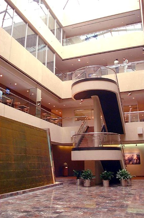

JB, what I based my comment on was also experience, but it may have been a faulty parallel that I used. Where I used to work, we had a big fountain in a large atrium in the middle of the building (see attachment). The fountain was copper clad and had to have repairs while I worked there. The structure under the copper was corroding away. Essentially, the whole fountain structure was rebuilt and new copper cladding added. In less than a year, that bright copper turned the color you see in the picture. Granted, it had water running over it 24/7, but it was inside and not exposed to any external elements.
BTW: I don't care if this thread wanders. I think I have the info I wanted and these side-topics are kinda fun.:)
Yeah, I'm not sure with the fountain application, with the constant water immersion, might have something to do with it?

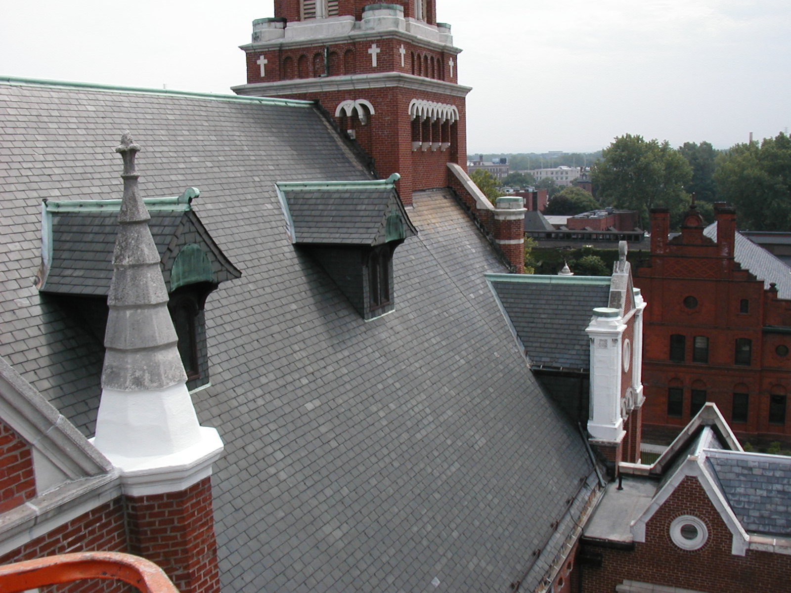

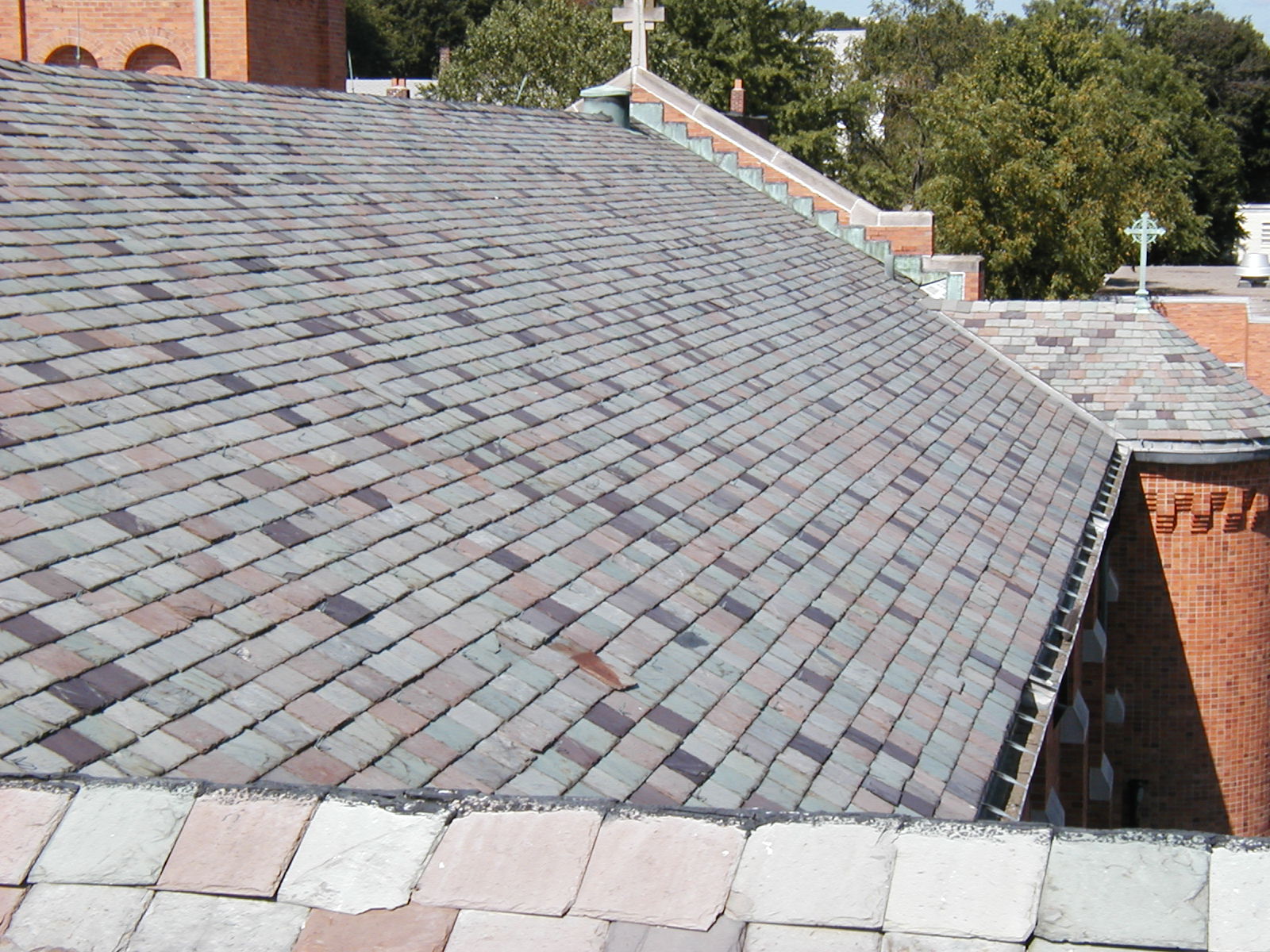

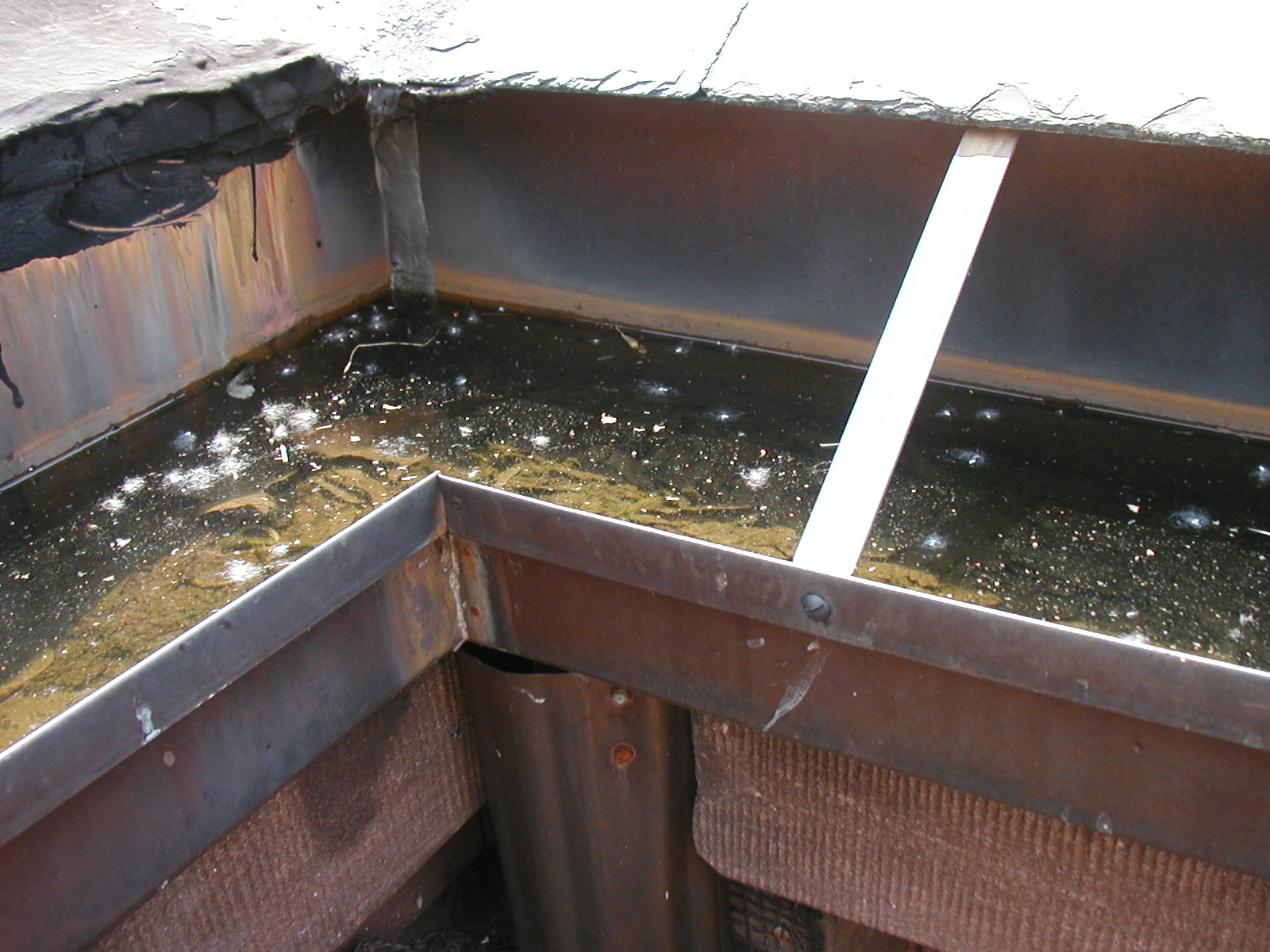

At one time when there was more coal fired plants running, that would of sped up the patina process I think. Interesting to note, when the copper is getting to the end of it's service life, it turns orange again, not as bright as when new but it really stands out on the surrounding green, starts occurring where the water runoff is concentrated, at that time it is like carbon paper thin, and will tear/perforate easily, you can poke a finger thru it, makes it a little easier to find potential leaks.
In these random pics there is some 80-100 year old green copper in the backgrounds, everyday sight on the old institutional type buildings.
pic of copper gutter put up 20+ years ago (not by me) and still just brown.
