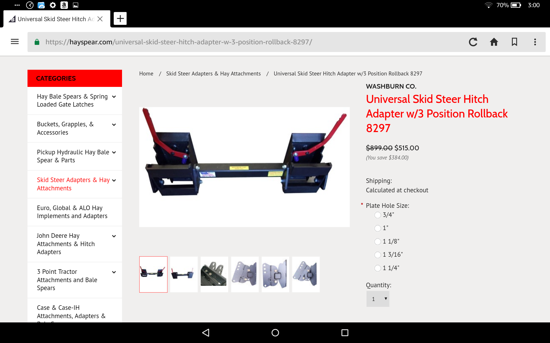

Converting is not difficult. Titan is the least expensive but the existing brackets just be cut free of an existing bucket.
Hayspear, Washburn offers a conversion that includes adjustable brackets, simplified conversion. See screenshot.
Tomahawk offers the least expensive adapters for the implements (adapter plates)

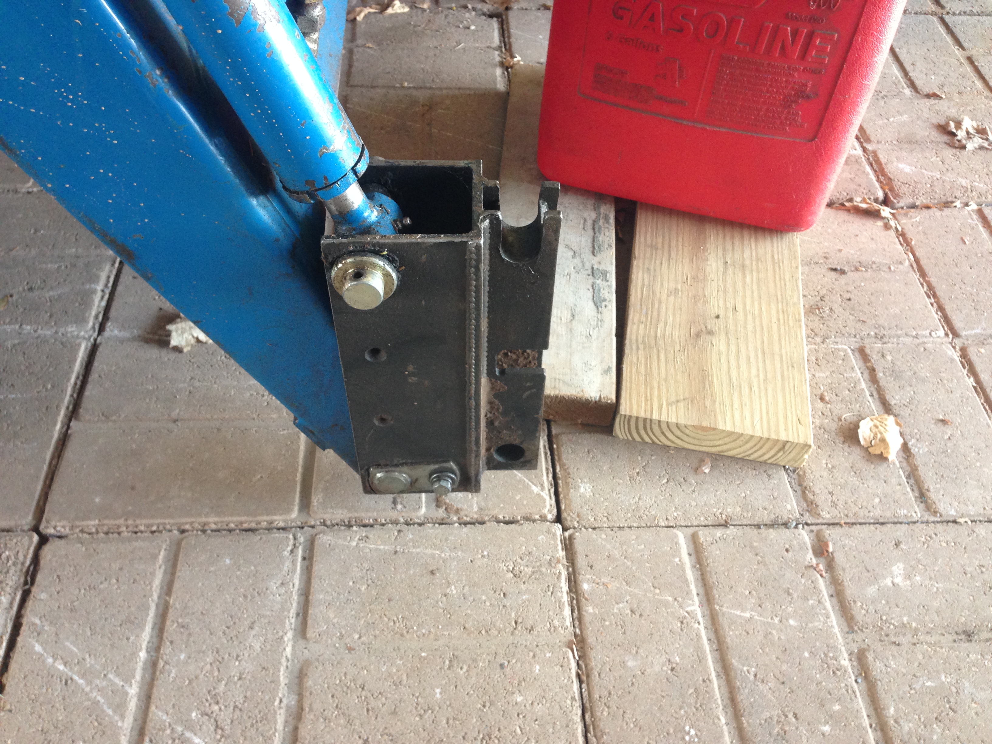

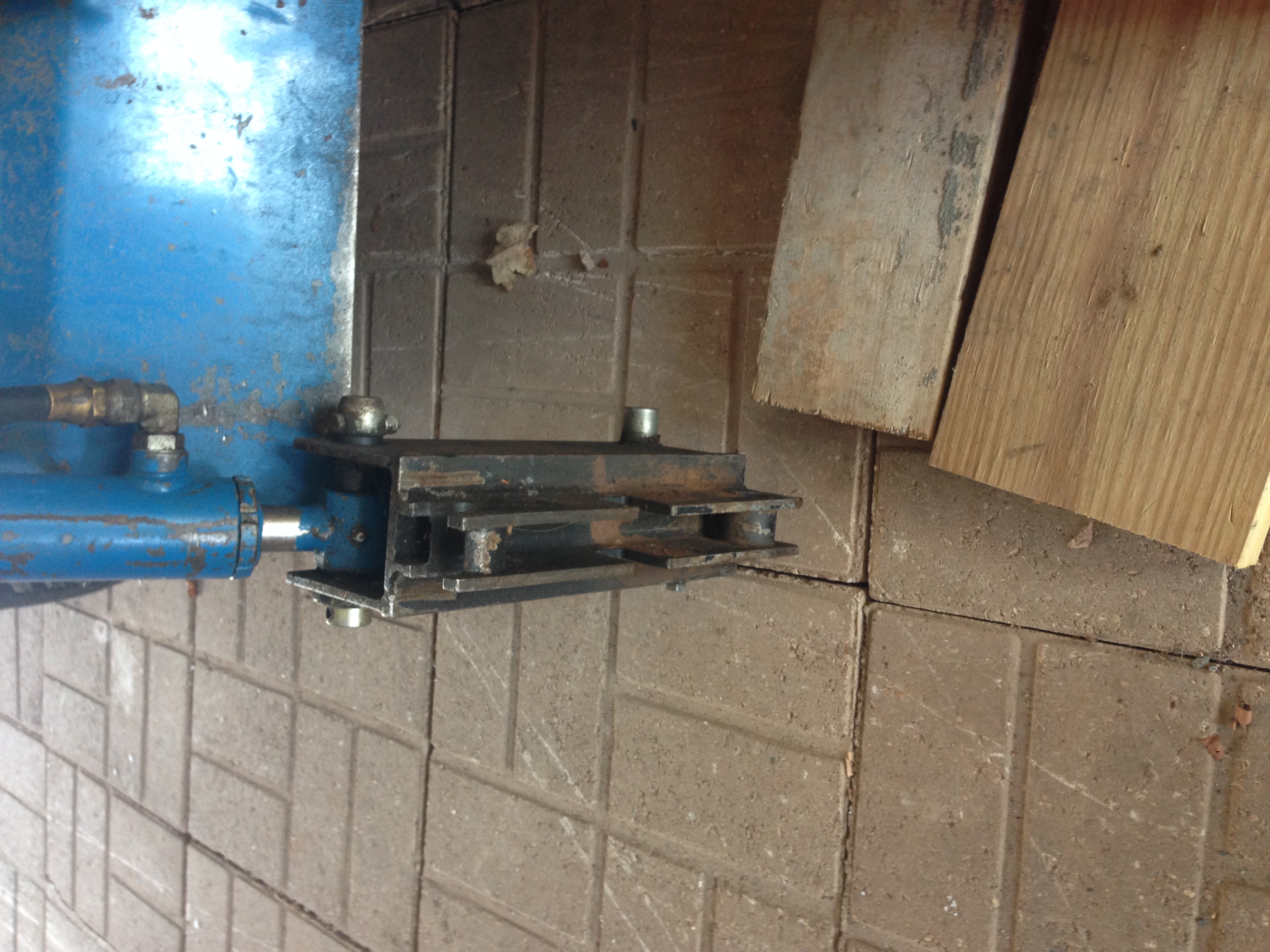

if you don't do a ton of swaps this is what I did plus my 1620 doesn't have a ton of lift capacityIMG_1533.jpgIMG_1534.jpgIMG_1536.jpg
   / How Hard to Convert? #14
My 1620 Has respectable lift capacity, has a koyker loader, switch between bucket and forks regularly. Guessing capacity at lift pins is about 1000 lbs.

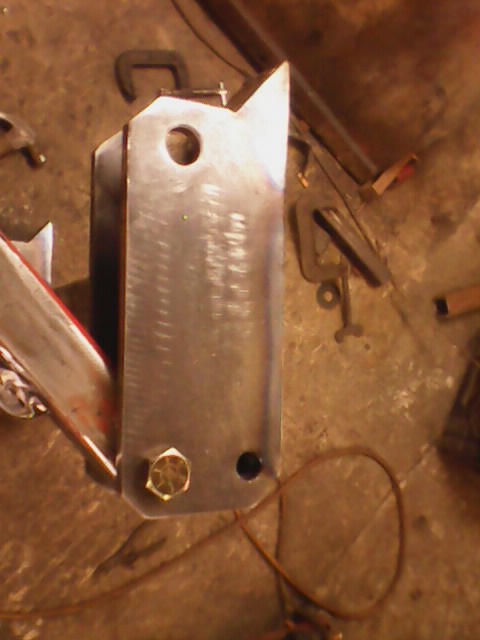

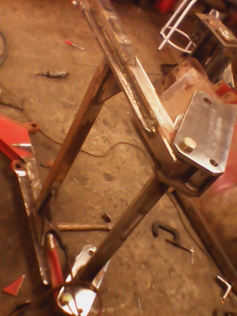

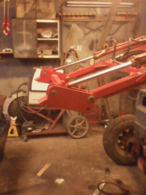

her is how i built mine on my homemade tractor,now i can build allot of attachments,is it worth it,yes so much faster to change out attachments, now in the process of building a ripper tooth,
sorry for the bad cell pics,last photo ,getting ready to make attachment brackets, ill have to get more pics of the bucket bracket,cell camara quit, Godbless
